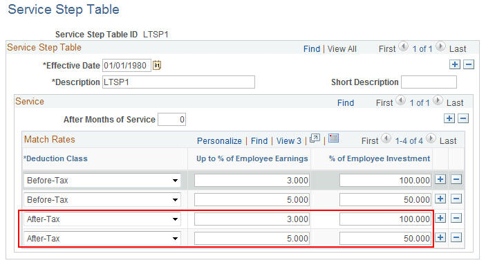

Setting Up the Service Step Table for Thrift Savings Plan (TSP) Employer Match Calculation for Federal Benefits
For Thrift Savings Plan (TSP) Employer Match Calculation, set up the Service Step Table as follows:
1. The first 3% of contribution is 100% Employer Match.
2. The remaining contribution is 50% Employer Match.
3. Total contribution for matching cannot exceed 5%.
This image shows the Service Step Table for Thrift Savings Plan (TSP) employer match calculation for federal benefits.

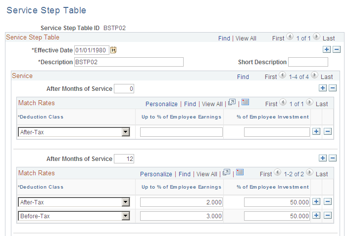

Example of After Months of Service Rewards
This example shows how to use the After Months of Service field to create multiple service steps to reward employees for staying with the company.
After Months of Service |
Deduction Class |
Up to % of Employee Earnings |
% of Employee Investment |
0 |
Before |
3 |
50 |
0 |
Before |
6 |
100 |
0 |
After |
2 |
25 |
0 |
After |
4 |
50 |
0 |
After |
6 |
100 |
24 |
Before |
10 |
100 |
24 |
After |
2 |
50 |
24 |
After |
4 |
75 |
24 |
After |
6 |
100 |
