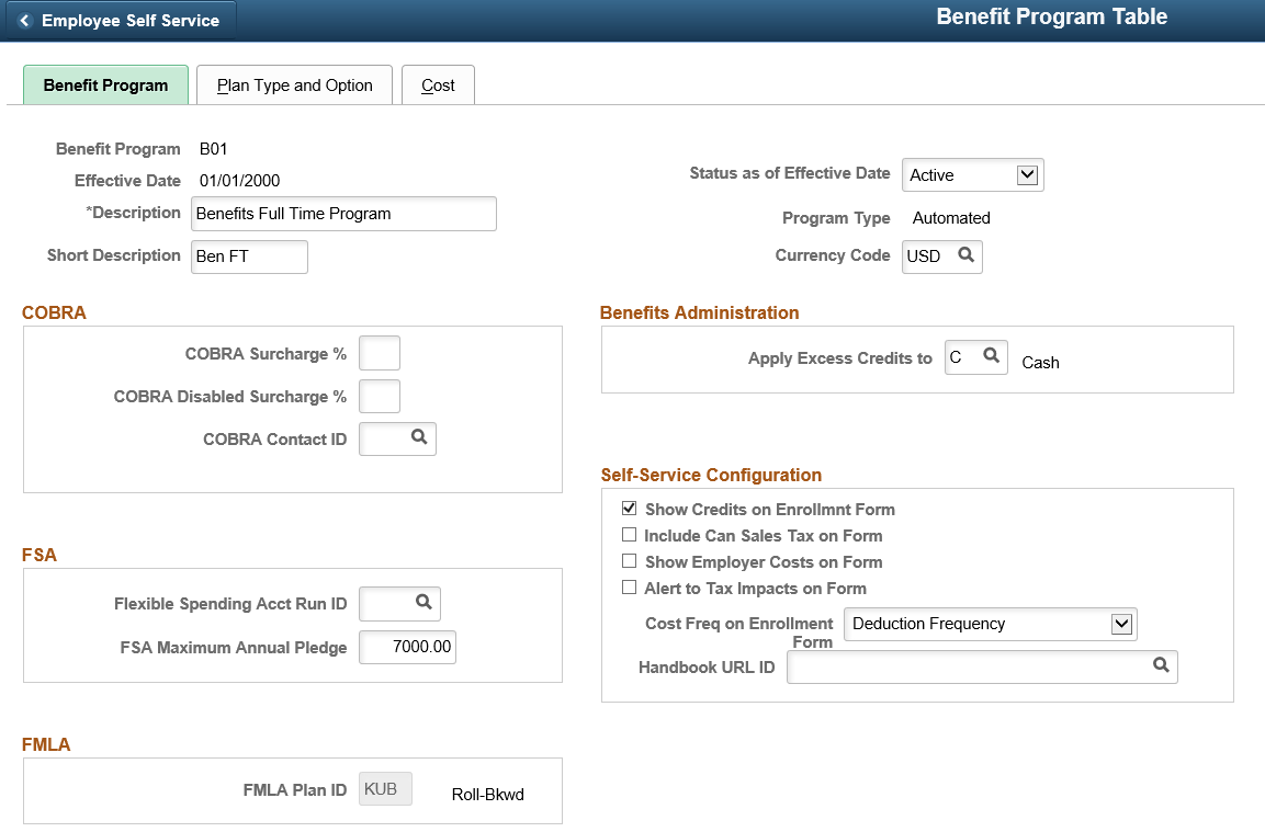

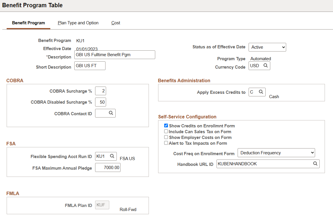

Use the Benefit Program Table - Benefit Program page (BEN_PROG_DEFN1) to define benefit program information.
Navigation:
This example illustrates the fields and controls on the Benefit Program Table - Benefit Program page. You can find definitions for the fields and controls later on this page.
Field or Control |
Description |
Effective Date |
The date the row in the table becomes effective. This date determines when you can view and change information. |
Status as of Effective Date |
Indicates whether a row in the table is Active or Inactive. Processes ignore benefit programs designated as Inactive, even if the effective date defines the program as current. |
Program Type |
The type of program can be Manual or Automated. If you are using only the Manage Base Benefits business process, this option is automatically set to Manual. If you activate Benefits Administration on the Installation Table, it is automatically set to Automated. |
Currency Code |
The type of currency that is used for this program's benefit and deduction calculations. |
COBRA
This group box defines the rules regarding the surcharge amounts that your organization imposes on COBRA (Consolidate Omnibus Budget Reconciliation Act) plans.
Field or Control |
Description |
COBRA Surcharge % (COBRA surcharge percentage) |
Enter the percentage amount of the benefit cost that you want added to the benefit cost. For example, if the cost of medical coverage is 100 USD and the COBRA surcharge % is 30%, the cost for medical coverage for someone on COBRA would be 130 USD. |
COBRA Disabled Surcharge % (COBRA disabled surcharge percentage) |
If you want a different percentage amount for a disabled person, enter that percentage amount. If you leave the field blank, the surcharge amount entered in the COBRA Surcharge % field will be applied to a disabled person with COBRA coverage. |
FSA
For FSA (flexible spending account) Administration users. Use this group box to set up your organization's business rules for flexible spending accounts.
Field or Control |
Description |
Flexible Spending Acct Run ID (flexible spending account run ID) |
For FSA Administration users. Enter the FSA run ID that you created on the FSA Run Table. |
FSA Maximum Annual Pledge |
Enter the maximum amount that an employee can contribute across all flexible spending accounts within the Benefit Program for a plan year. |
FMLA
Use this group box to define the rules for processing under FMLA (Family Medical Leave Act).
Field or Control |
Description |
FMLA Plan ID (FMLA plan identification) |
Enter the FMLA plan ID that you created on the FMLA Plan Table. |
This group box is available if Benefits Administration is activated on the Installation Table. If you are using flexible credits, it is used to define how the system will process excess flexible credit amounts when an employee does not designate a rollover election during benefit enrollment.
Field or Control |
Description |
Apply Excess Credits to |
The system can convert excess flexible credit amounts to: C (Cash) D (FSA-Dependent Care) F (Forfeit Excess Credit) H (FSA-Health Care) R (FSA Retirement Counseling) S (Savings-401(k)) |
Self-Service Configuration
Use this group box to define the rules for displaying and processing the PeopleSoft Benefits Self Service application pages.
Field or Control |
Description |
Show Credits on Enrollmnt Form (show credits on enrollment form) |
Select if you want credit amounts to appear on the enrollment form. If you do not offer flexible credits, you may not want this heading to appear on the form. |
Include Can Sales Tax on Form (include Canadian sales tax on form) |
Select if you want Canadian sales tax information to appear on the Benefits Self Service Enrollment Summary page. |
Show Employer Costs on Form |
Select to display the employer's contributions (costs) on the enrollment form |
Alert to Tax Impacts on Form |
Select to alert the employee to any potential tax impacts (due to the employer's contributions) on the enrollment form. Most typically, this would be if a T-Tax (imputed income) component existed. |
Cost Freq on Enrollment Form (cost frequency on enrollment form) |
This defines how the cost of the benefits appears on the enrollment form. Values are Annual: Displays the costs as annual amounts. Deduction: Displays the costs as per-pay-period amounts. |
Handbook URL ID (handbook uniform resource locator identification) |
Enter the URL ID that connects to your benefit handbook. URL IDs are set up in the URL Table. Note: The URL entered in this field displays as a link in the Resources group box in the fluid Benefits Enrollment page. Only one handbook can be assigned per benefit program. |

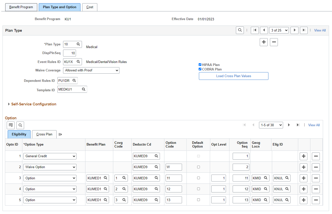

Use the Benefit Program Table - Plan Type and Option page (BEN_PROG_DEFN2) to set up plan types and options for the benefit program and add important information about plan types, including event and eligibility rules.
Navigation:
This example illustrates the fields and controls on the Benefit Program Table - Plan Type and Option page.(Page 1 of 2)
This example illustrates the fields and controls on the Benefit Program Table - Plan Type and Option page (Page 2 of 2).
Use this page to set up the basic plan types for your benefit program.

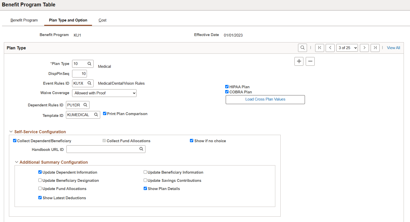

Use the Self-Service Configuration group box to define the rules for displaying enrollment and plan information on the fluid Benefits plan type pages.
Field or Control |
Description |
Dependent Rules ID |
Select the dependent rule to be used when determining dependent age limits for this plan type. This field appears only for 1X (health) plan types. If you leave this field blank, the system uses the least restrictive options as the default limits:
Note: To generate COBRA event triggers during COBRA overage processing, the system uses the most restrictive settings from the dependent rules used by all of the 1X plan types under the benefit program (for example, the lowest age limits). The system uses these settings only when creating the initial COBRA event triggers. When the system processes the triggers to generate COBRA enrollments, it correctly applies the rules for specific plan types. |
Template ID |
Select a template ID if you want to compare plans during benefits enrollment for this plan type. Note: This is not applicable for Plan Type 01. For more information on defining plan comparison templates, see Comparison Template Page. |
Print Plan Comparison |
When the administrator enters a Template ID, the Print Plan Comparison check box is enabled by default. This allows employees to print the plan comparison report for the selected plan type in the Benefits Plan Comparison Page. |
Collect Dependent/Beneficiary |
Select this check box when you want the system to collect information pertaining to dependents and benefits and display that information on the fluid Benefit Summary and the plan enrollment pages. This works in conjunction with the Ignore Dep/Ben Edits check box on the Event Rules page. |
Collect Fund Allocations |
When this check box is selected, the system collects the information pertaining to savings plans and displays that information on the fluid Benefit Summary and the plan enrollment pages. |
Show if no choice |
This check box controls whether a plan type appears on the enrollment when the employee has no option to choose and cannot waive out of the option. A good example is paid vacation. Employees receive the benefit, but you don't display it on the enrollment form. If the check box is selected, the system displays the plan type in the enrollment form summary. When the check box is deselected, the system will not display the plan type. This setting is not relevant to 6x plans (flexible spending accounts) and 9x plans (vacation buy/sell), which are always shown in self-service. |
Handbook URL |
If you have a special handbook for this plan type, you can enter the URL ID. URL IDs are set up in the URL Table. |

Associating Plan Options with Plan Types
Use the Benefit Program Table - Plan Type and Option page and the Eligibility tab in the Option group box to set up the options within a plan type.
When you create a new option row by clicking the Insert Row button, the system automatically assigns the option a unique option ID value. You cannot update this value.

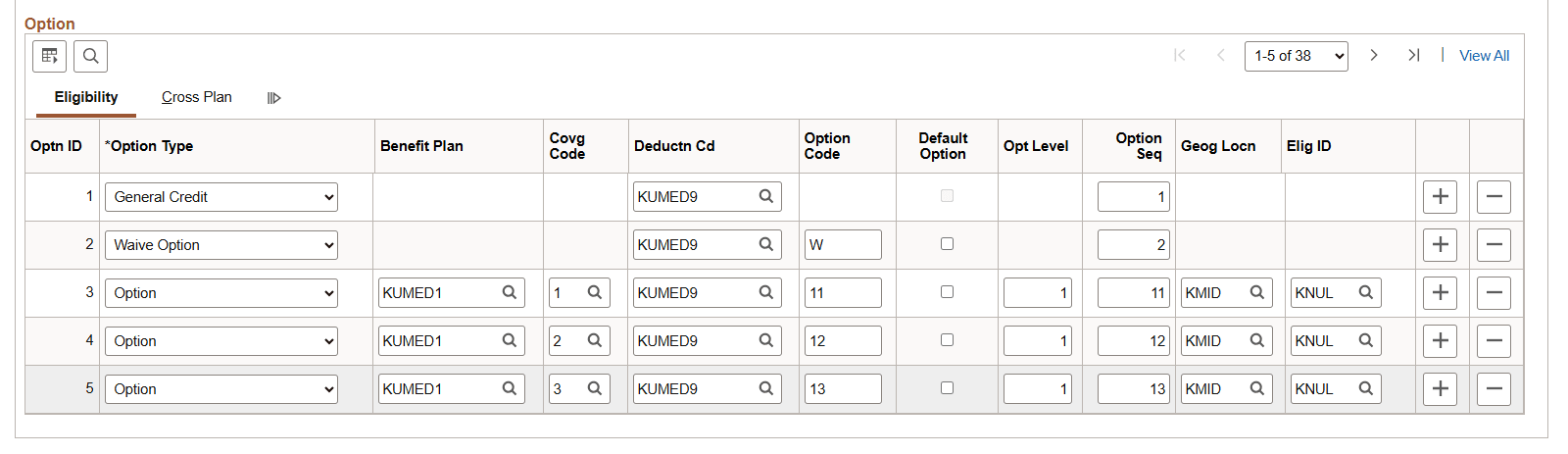

The first value that you enter for a new option row is the option type. Select from one of the following valid values:
Values |
Plan Type |
P (program) |
Required for automated benefit programs. It is allowed for the Benefit Program row (plan type 01) only, and only one is allowed per benefit program. |
G (general credit) |
Optional, allowed for most plan types except 4x–9x. Only one is allowed per plan type. |
O (option) |
At least one is required per plan type except for the Benefit Program row (plan type 01), where it is not allowed. |
W (waive) |
Only one is allowed per plan type. It follows the waive coverage rule setup at the plan-type level. |
Note: The manner in which you complete the rest of a given option row depends on the plan type to which the row belongs and the option type of that row.
Field Requirements for the Option Grid by Plan and Option Type
This table describes field requirements for the Option Grid by Plan and Option type:

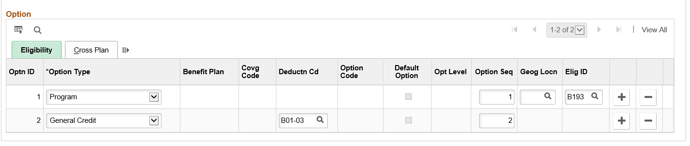

Setting Up the Benefit Program Row (Plan Type 01)
Access the Benefit Program Table - Plan Type and Option page: Eligibility tab.
A Benefit Program row is required for all automated benefit programs. The eligibility rules established for plan type 01 govern the entire benefit program.

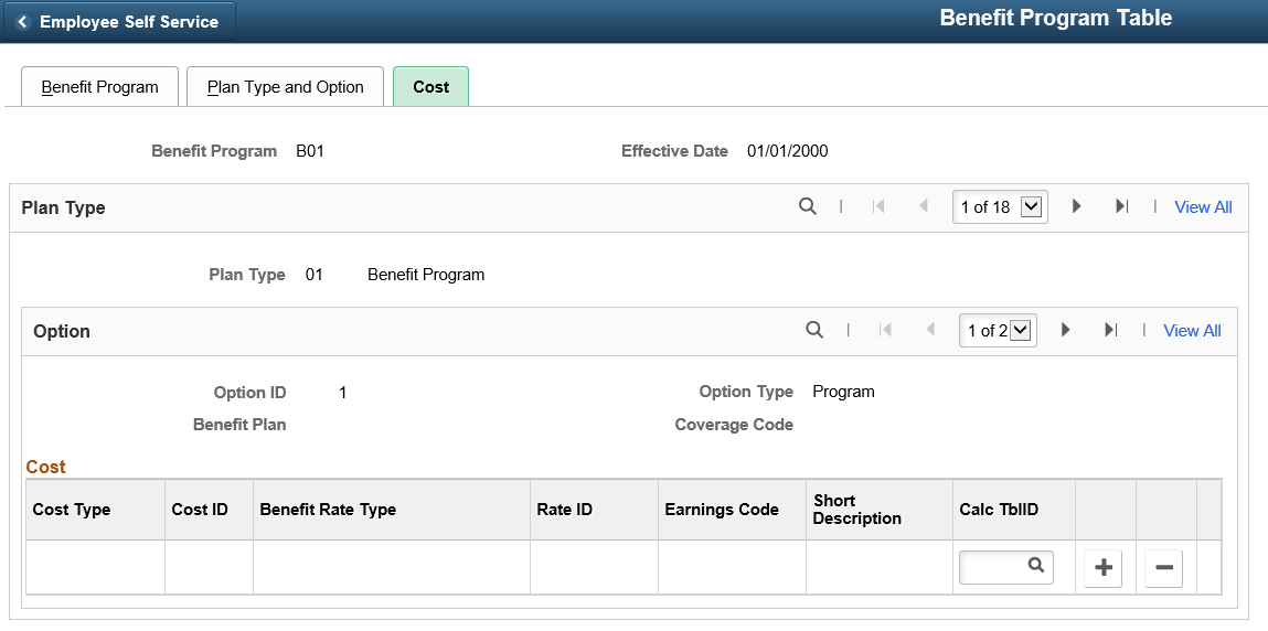

Use the Benefit Program Table - Cost page (BEN_PROG_DEFN3) to calculate costs and credits by linking rate and calculation rules to a benefit program and plan type.
Navigation:
This example illustrates the fields and controls on the Benefit Program Table - Cost page. You can find definitions for the fields and controls later on this page.
Field or Control |
Description |
Cost Type |
Each option can have one price element defined, while options and general credits can have multiple credit elements defined. Select from the following values: Price: The system calculates deductions for employees who select this option according to the deduction code that you identify for this benefit option. Credit: The system calculates earnings for employees who select this option according to the earnings code that you identify for this benefit option. The system assigns the frequency of the additional pay based on the deduction code that you identify for this benefit option. |
Note: You can also go to the Benefit Program row (plan type 01) and use the Cost page to define general flexible credits for the Benefit Program.

Enter which table to use to determine rates for the cost or credit entry. |
Rate lID |
Indicate the appropriate rate table because multiple tables may exist. In the case of credits, only the Employee Portion is picked up and reflected as the credit amount. |
Earnings Code |
Tells the system how to calculate the flexible credit earnings for a participant. This option is not applicable for Price rows. |
Calc TblID (calculation rules table ID) |
Indicates an applicable calculation rule, which references what dates and rules to apply to determine age, service, and compensation amounts for the purpose of rate calculation. Calculation rules are also used to determine what point in time to use to determine the calculation of service for service step calculations. |
