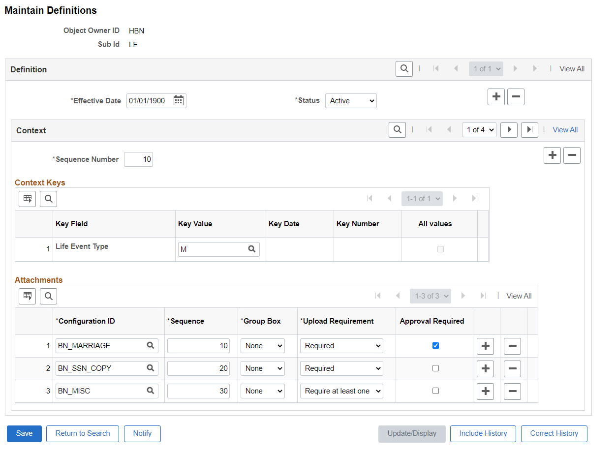

Use the Maintain Definitions page (HR_ATT_DEFN) to link the configuration ID to a specific life event. You can indicate the upload requirement and approval requirement for each configuration ID.
Establish the contexts in which the defined attachment types are to be available and associate specific attachments with each context.

This example shows the fields and controls on the Maintain Definitions page when Object Owner ID is selected as HBN and Sub Id is selected as LE. This is specific to Life Event.
In the Key Value field, select the required life event type. Here, in this example ‘M’ – Marriage is selected as the Life Event Type.
Field or Control |
Description |
Configuration ID |
Select the required configuration ID. This indicates the documentation type. |
Upload Requirement |
Select the option to indicate the requirement for document upload under this category. Available options are:
Approval Required |
Specify if this document requires approval. If selected, the document will be send to the approver(s) based on the configured approval framework. The system marks the Upload Document step as complete only if all the documents that are required to upload are uploaded and all the documents that require approval are approved. |
For more information on other fields and controls, see Maintain Definitions Page

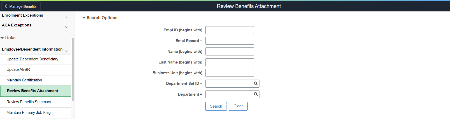

Use the Review Benefits Attachment page to view the documents uploaded by the employees.
Note: To activate the Review Benefits Attachment component on the Benefits WorkCenter, activate the Link section.
Go to Enterprise Component > WorkCenter/Dashboards > Configure Pagelets
Configuration ID = BEN_FL Table
Navigation:
Administrator can search for the required employee.

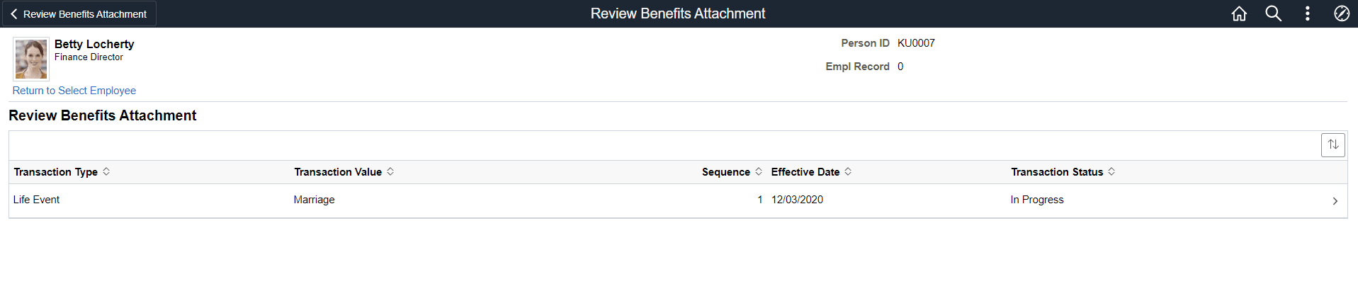

This example illustrates the Review Benefits Attachment page.
Attachment details of the selected employee is displayed.

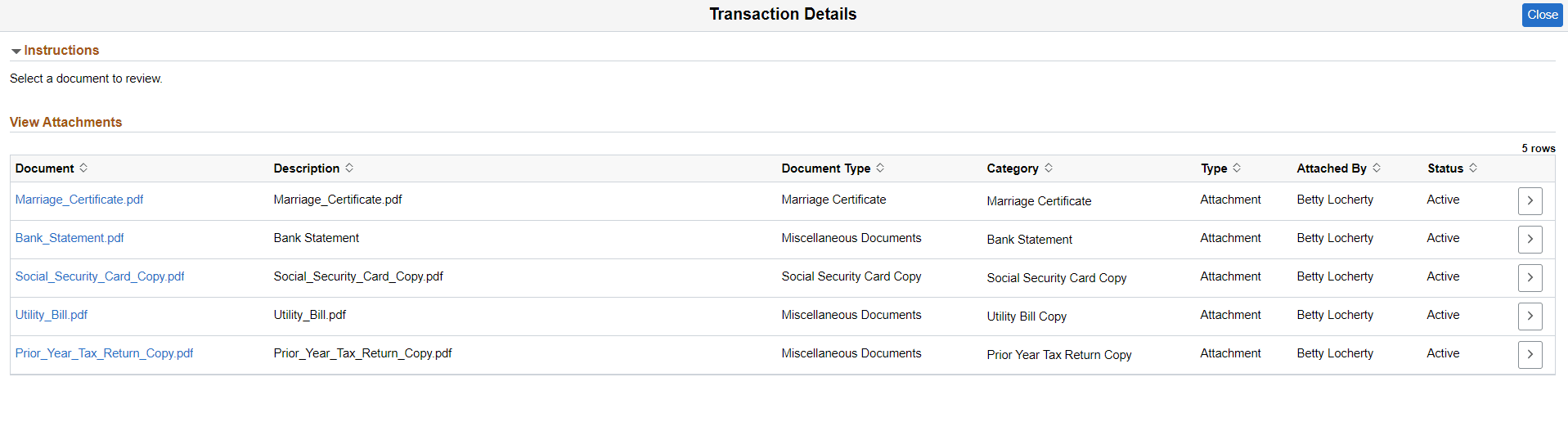

Click the row to open the Transaction Details page.
This example illustrates the Transaction Details page
This page lists the documents uploaded by the employee with details like document type, category and status. Click the document to open the attachment.
