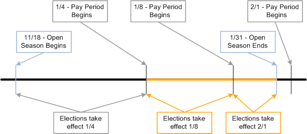

Floating Event Dates: An Example
For example, suppose that the first pay period of the new year starts January 4. The open season solicitation period runs from November 18 to January 31. The following diagram illustrates the time span from the beginning of open season on November 18 through the pay period up to the February 1 pay period.
This image illustrates the Floating Event Dates process.
When open season begins, the system uses the period begin date, January 1, as the floating event date and provides current coverage as of January 1. This table shows the results of elections received between or by certain dates:
If Elections Are Received... |
...the Event Date Is... |
...and Coverage Starts... |
Between November 18 and January 1 |
January 1 (the period begin date) |
January 4 |
On January 4 |
The date elections are received (the system date) |
January 4 |
Between January 5 and January 18 |
January 18, the second full pay period |
Between January 19 and January 31 |
February 1, the third full pay period |
After January 31 |
January 31 (the open season end date) |
February 1, the start of the last full pay period |
In this example, when the user finalizes open season, the system uses January 31 as the floating event date. Coverage starts for any remaining employees effective February 1.

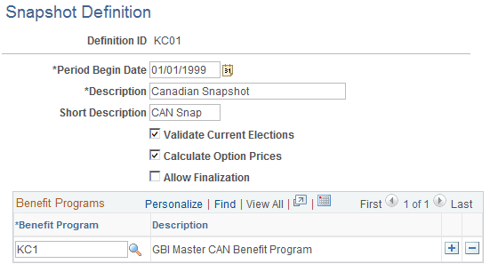

Use the Snapshot Definition page (BAS_SNAP_DEFINITN) to set up the system to run the Snapshot process.
Navigation:
This example illustrates the fields and controls on the Snapshot Definition page. You can find definitions for the fields and controls later on this page.
Field or Control |
Description |
Validate Current Elections |
Select during snapshot processing to determine whether employees are eligible for their current elected options. Presumably, the employee elections were entered through the PeopleSoft HR Base Benefits application or were imported from another system. This validation determines whether these current elections are supported by the new eligibility rules that you create. |
Calculate Option Prices |
Select for the system to calculate the prices and credits for benefit plan options. This option enables you to validate your cost definitions and rate table setup against the premiums currently being charged to your participants. If this check box is not selected, the system bypasses price and credit calculation for all employees. |
Allow Finalization |
Select to make the Snapshot process act exactly like open enrollment. Use the Data Entry component for last minute corrections and changes. When you finalize the snapshot, the system updates the Base Benefit tables appropriately. Note: If elections are already current in the HR Base Benefits application, and your eligibility rules are also current and correct, do not expect the Snapshot process to write any rows to the HR Base Benefits application table (because enrollments have not changed). If, however, updated elections are inserted into the HR Base Benefits application by the Snapshot process, be sure to research this occurrence to confirm the reason. |
Benefit Program Description |
Enter the benefit programs that will participate in the Snapshot process. In most cases, you will want to include all of your benefit programs. |
Note: The Snapshot process works fastest if Validate Current Elections, Calculate Option Prices, and Allow Finalize are not selected. Although the Open Enrollment process gives you the same results as the Snapshot process, you might want to use the Snapshot process when going live with PeopleSoft Benefits Administration to avoid changing open enrollment event rules. For a snapshot run, you do not need to set proof levels; instead, set the default as the current election. Because this might not always be the case with open enrollment, use the Snapshot process to keep your rules separate.
