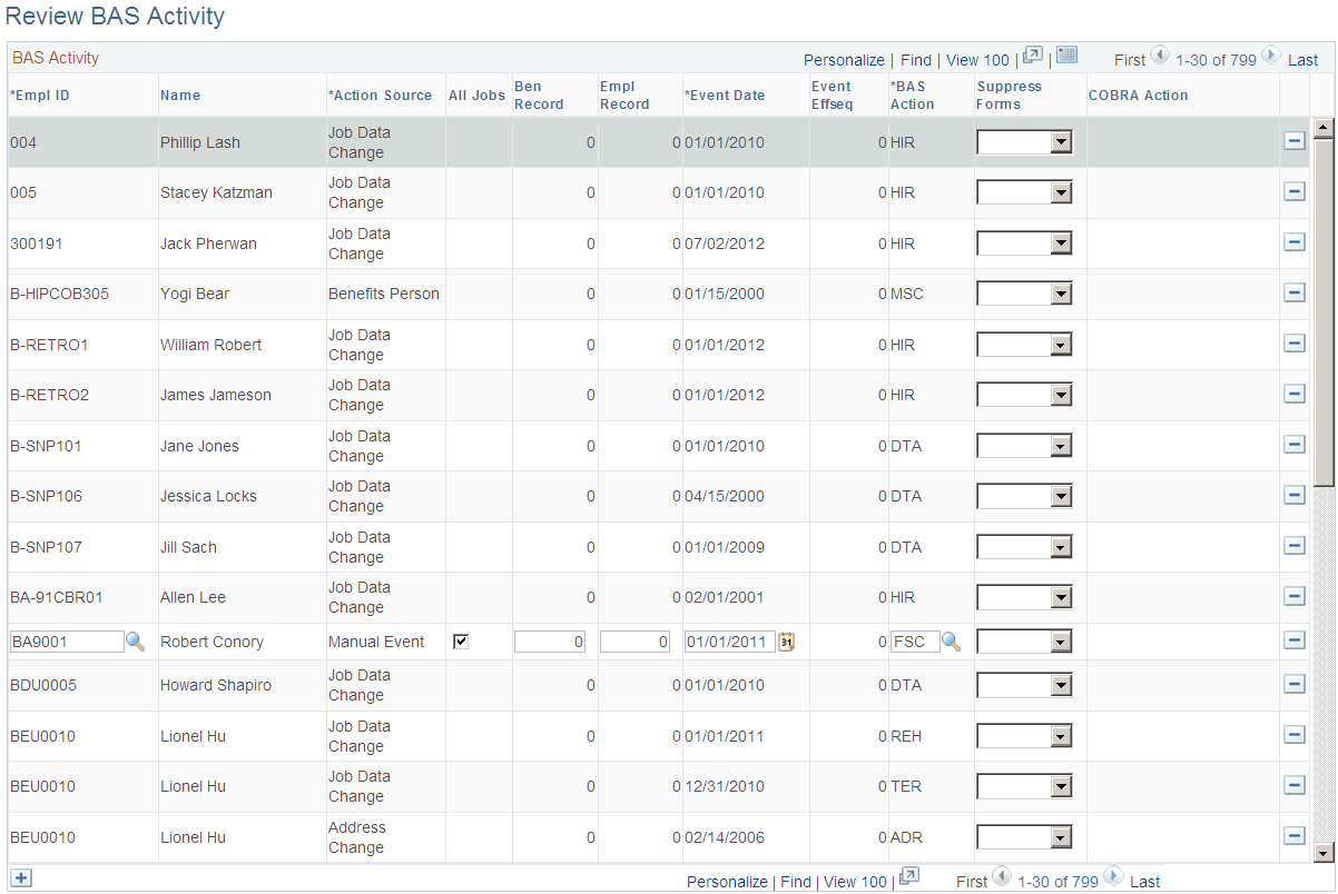

Use the Review BAS Activity (review benefits administration system activity) page (BAS_ACTIVITY) to add events into the BAS Activity table.
You manually insert events to be processed according to event rules that map to the BAS action that you enter when you run the Benefits Administration process. You can also delete unwanted, but automatically triggered, events.
Navigation:
This example illustrates the fields and controls on the Review BAS Activity page. You can find definitions for the fields and controls later on this page.
You can insert into the BAS Activity table only event classes that have the Manual Event Allowed check box selected in the Event Class table.
As delivered, you can insert two event classes manually: Family Status Change and Miscellaneous Status Change. You can also review and delete any type of unprocessed event with this page.
Note: The BAS Activity table displays unprocessed events only. As soon as Benefits Administration successfully processes an event, the system deletes it from the BAS Activity table.
Field or Control |
Description |
Action Source |
Identifies whether the event is due to a change in job data, personal data, or multiple job flags, or is a passive event. Possible action sources are:
All Jobs |
Select to have the manual event trigger benefits processing for all possible jobs and not just the specific job (employment record number) entered for the event. For example, a manually entered FSC could impact benefits for all jobs. Note: This option is available if the Multiple Jobs feature is enabled. |
Event Date |
Displays the event date. If a job, address, or multiple job change triggers the activity, the event date is the effective date of the change. If a passive event triggers the activity, the event date is the date on which the limit represented by the event (a limit related to age or years of service, for example) was reached. The date for a manually entered event appears by default when the activity record for the event was inserted into the table through the Review Bas Activity page. You can change the event data if required. |
Event Effseq (event effective sequence) |
If more than one manual event exists for an employee for the same effective date, enter unique sequence numbers for each event. |
BAS Action |
Identifies the Benefits Administration action associated with this event as defined in the Action Reason table. Events triggered by job, address, multiple job indicators, and passive events are assigned codes from the Action Reason table. Manual events are given a code that is selected by the user entering the manual event record. |
COBRA Action (Consolidated Omnibus Budget Reconciliation Act) |
Identifies the COBRA action code associated with this event as defined in the Action Reason table (not entered for a manual event). |

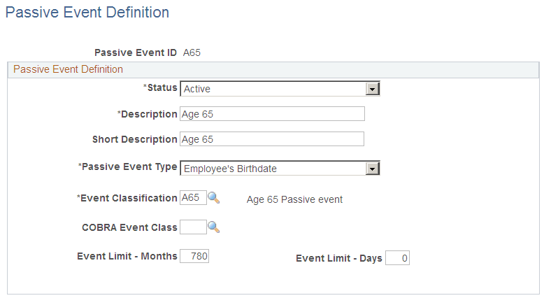

Use the Passive Event Definition page (BAS_PASSIVE_EVENT) to define passive events that are not initiated by data entry.
Navigation:
This example illustrates the fields and controls on the Passive Event Definition page. You can find definitions for the fields and controls later on this page.

Field or Control |
Description |
Passive Event Type |
Select a passive event type. Delivered event types include employee birthdate and events based on an employee's service date. |
Event Classification |
Select an event classification. Of the delivered event classes, OE and Snapshot are not available. |
Event Limit - Months and Event Limit - Days |
Indicate how long after the birthday or service date the event will take place. |
Example of Passive Event Definition
You might set up a passive event to determine which employees are eligible for certain benefits once they've worked for your organization for a year. To do this, you define a passive event with the service date event type and an event limit - months value of 12. The event classification for this example could be MSC, or it could be a new event classification created specifically to manage this passive event.
After you set up the passive event, the system calculates the difference between your employees' service dates and the process date, and it triggers the event for any employees with a difference of twelve months within the date range that you specify on the Benefits Administration process run control page. The system processes the passive event as an MSC event.
Note: Internally, when the Benefits Administration process runs, it processes passive events by inserting a BAS Activity record for each individual who meets the passive event criteria. From this point, the activity record is processed like any other event, which means that you can extend the passive event concept beyond that which is delivered. Do this by creating your own modified processes that insert the required BAS Activity rows.
