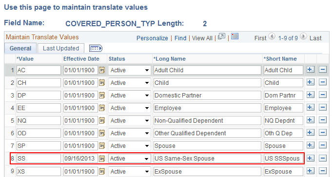

Use the translate value SS for the Covered Person Type of US same-sex spouse.
This example illustrates the fields and controls on the Maintain Translate Values — Covered Person Type page.

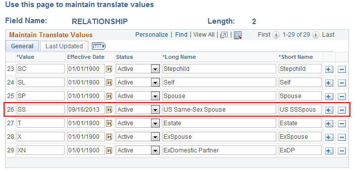

Use the translate value SS for the US same-sex spouse relationship.
This example illustrates the fields and controls on the Maintain Translate Values — Relationship page.

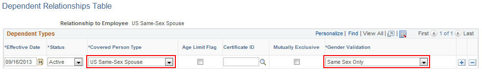

The dependent relationship uses Covered Person Type = US Same-Sex Spouse and Gender Validation = Same Sex Only.
This example illustrates the fields and controls on the Dependent Relationships Table page.

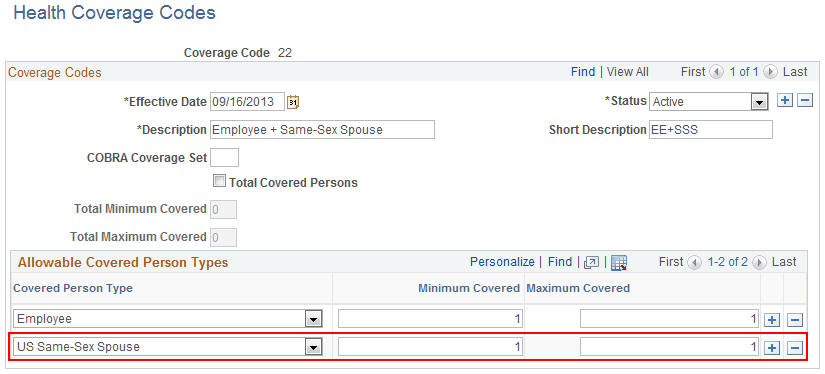

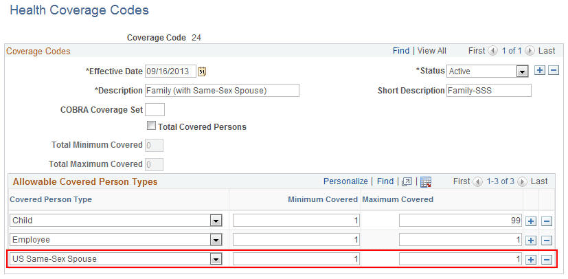

Use the coverage codes 22 and 24 for the options - employee + same-sex spouse, and family (with same-sex spouse).
This example illustrates the fields and controls on the Health Coverage Codes page for coverage code 22.
This example illustrates the fields and controls on the Health Coverage Codes page for coverage code 24.

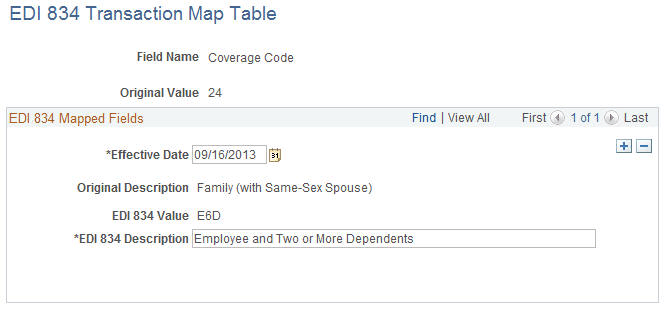

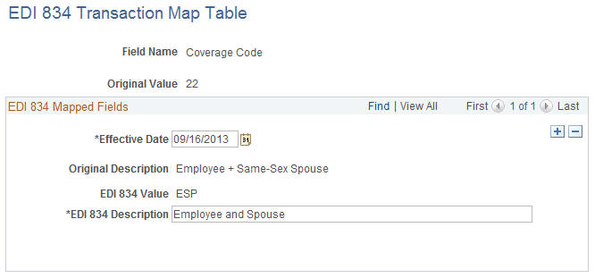

Mapping values 22 and 24 in the Coverage Code field.
This example illustrates the fields and controls on the EDI 834 Transaction Map Table page for coverage code 22.
This example illustrates the fields and controls on the EDI 834 Transaction Map Table page for coverage code 24.

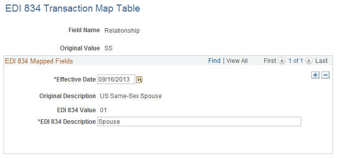

Mapping value US Same Sex Spouse in the Relationship field.
This example illustrates the fields and controls on the EDI 834 Transaction Map Table page for the mapping value US Same Sex Spouse.
