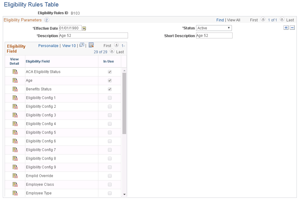

Use the Eligibility Rules Table page (BAS_ELIG_RULES1) to define Benefits Administration eligibility parameters.
Navigation:
This example illustrates the fields and controls on the Eligibility Rules Table page. You can find definitions for the fields and controls later on this page.
This page contains an Eligibility Field group box from which you can select specific eligibility fields to maintain. When you select the View icon from the Eligibility Field group box for a field, another group box appears with a list of all eligibility fields available that can make up this eligibility rule.
If the check box to the right of a field in the Eligibility Field group box is selected, it indicates that the field is currently being used by the eligibility rule.
The fields in the following list are common to many of the group boxes that appear.
