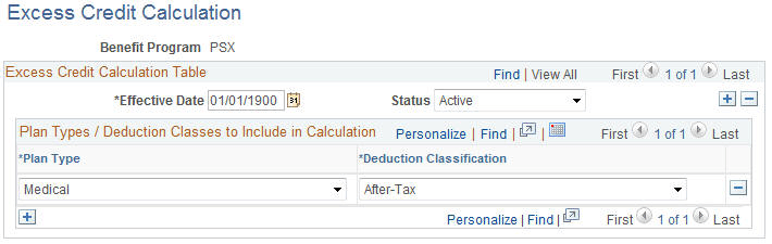

Use the Excess Credit Calculation page (EXCESS_CRDT_CALC) to enter excess credit calculations.
Navigation:
This image shows the Excess Credit Calculation page.
Enter the plan types and deduction classifications that you want the system to include when calculating the excess credit amount.
