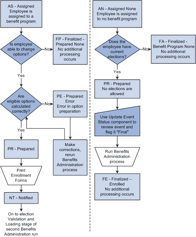

During option preparation, the system uses eligibility and event rules to determine:
Plan eligibility.
Plan pricing.
Available options.
Default options.
Proof of coverage limits for life and AD/D plans.
Coverage terminations (as appropriate).
Any processing errors during this phase are typically caused by problems with:
Eligibility rules.
Event rules.
The benefit program involved.
The participant's HR information.
When an error occurs, you need to:
Evaluate the error.
Correct it.
Reprocess the event.
This table describes option preparation status values:

The following two flowcharts illustrate how the system assigns process status values during option preparation. The flowchart on the left shows the process status flow for AS events, while the flowchart on the right shows the process status flow for AN events:
The following image illustrates the process status flow for option preparation.

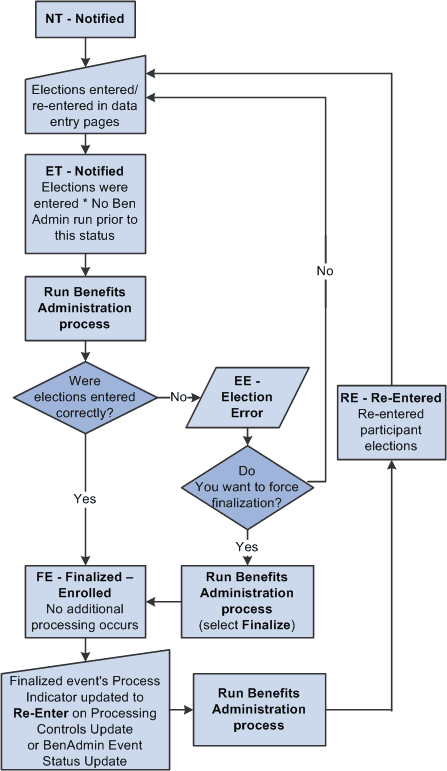

In the second phase of the Benefits Administration process, you enter participant elections into the system through the data entry pages and then run Benefits Administration to validate those elections and load them into the benefits tables and to PeopleSoft Payroll for North America.
This table describes status values that you might encounter:
Process Status |
Description |
Next Processing Steps |
ET - Entered |
A benefits administrator (or the employee through PeopleSoft eBenefits) has entered the participant's new elections into the system, and they are ready for validation by the Benefits Administration process. Participant events with a process status of ET can have a prior process status of PR, NT, or RE (Reentered). |
If no errors occur with the elections, the elections are posted to the appropriate benefit and payroll tables, and the system updates the process status to FE. If errors occur, the status becomes EE. If you run the Benefits Administration process with Finalize selected, EE participant events are brought to FE status, and the system goes through the normal validation and load procedure for all elections. If any of the employee's choices are invalid, event rules are consulted to determine whether current elections or defaults should be loaded. |
EE - Election Error |
The system encountered an error in processing the elections for the participant associated with the event. No elections are posted to the Manage Base Benefits business process tables. Errors are posted to the Message table and are identified by participant and event. The previous process status was either ET or EE. |
No further processing occurs for this participant event. You need to correct the errors by reentering employee elections and run the Benefits Administration process again. Alternatively, you can force finalize this participant event to finalize it with errors. The system loads the default values for the associated participant's erroneous benefit option elections. If a dependent/beneficiary or investment choice is in error, the system loads the employee's option choice but does not load the dependent/beneficiary or investment choice. You can generate confirmation statements for participants whose events have an EE process status; the form indicates the plan information in error along with the valid plan choices. |
FE - Finalized - Enrolled |
Benefits Administration processing is complete for the participant event. All elections have been validated and loaded to the appropriate Manage Base Benefits business process and Payroll for North America tables. Events reach this status either from a process status of ET, EE, or PR, or if you force finalize a participant. If the participant came from a process status of PR due to a loss of all eligibility, the system inserts a termination row for each of the participant's current elections. |
You need to generate and deliver a confirmation form to the participant associated with the event. To change a participant's elections after they've been finalized (for example, if a participant wants to correct information on the confirmation statement), you can reprocess them by giving the associated event a process status of RE (reentered) in the Event Status Update page and rerunning the Benefits Administration process. |
You can reprocess events at almost every stage of the Benefits Administration process, from scheduling to election entry. In many cases, event reprocessing does not involve process status values other than those described previously, but when you're planning to reenter participant benefit option elections, the system uses the special RE (reentered) process status as an interim status before rolling the event back to the ET value.

The following flowchart illustrates the process status flow for ET events and follows it through to the final process status of FE. It also shows how the system uses the RE process status:
This image describes the process status flow for election entry, validation, loading, and reentry.
