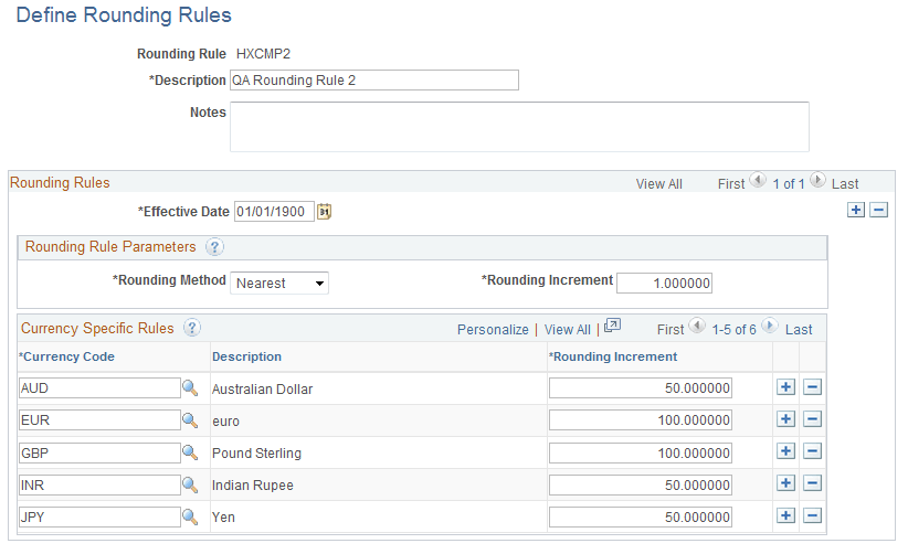

Use the Define Rounding Rules page (WCS_ROUND_TBL) to set up rounding rules to determine calculated funding amounts for funding adjustments and proposed amounts for variable compensation and salary plans.
Navigation:
This example illustrates the fields and controls on the Define Rounding Rules page.
Field or Control |
Description |
Rounding Rule |
Identifies the rounding rule. You enter the characters in this field in the Add mode before you access the page. The maximum length is six characters. |
Rounding Rules
Field or Control |
Description |
Effective Date |
Select or enter the date the rule becomes effective. |
Rounding Rule Parameters
Field or Control |
Description |
Rounding Method |
Select one of these values to indicate the method with which the system should round values that are input and calculated:
Rounding Increment |
Enter the increment by which you want the system to round input amounts. Rounding increments must be 1000, 500, 100, 50, 10, 5, 1, 0.1, or 0.01. |
Currency Specific Rules
Field or Control |
Description |
Currency Code |
Select the currency for which you want to apply the rounding rule. The system displays the description to the right of the currency. |
Enter the rounding increment that you want the system to use for the corresponding currency. Rounding increments must be 1000,500,100,50,10,5,1,0.1, or 0.01. |

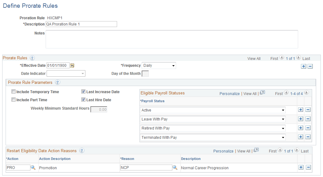

Use the Define Prorate Rules page (WCS_PRORATE_TBL) to set up rules for proration analysis and factor calculation.
Navigation:
This example illustrates the fields and controls on the Define Prorate Rules page.
Field or Control |
Description |
Proration Rule |
Identifies the proration rule. You enter the characters in this field in the Add mode before you access the page. The maximum length is six characters. |
Prorate Rules
Field or Control |
Description |
Effective Date |
Frequency |
Select one of these values to indicate the frequency with which the system should apply the proration rule:
Date Indicator |
Use this field only when the proration frequency is set to Monthly. Select one of these values to indicate when the system should use the proration rule:
Day of the Month |
If you select Day of Month in the Date Indicator field, you must also enter the day on which the proration rule is used. This number cannot be greater than 28. |
Prorate Rule Parameters
Field or Control |
Description |
Include Temporary Time |
Select to include the proration rule in calculations involving temporary time. If this check box is deselected, the Regular/Temporary field on the employee's Job Data - Job Information page for which the proration rule is being applied must have an employment status of Regular to be considered eligible. |
Include Part Time |
Select to include the proration rule in calculations involving part-time pay. If this check box is deselected, the Full/Part field on the employee's Job Data - Job Information page for which the proration rule is being applied must have an employment status of Full-Time to be considered eligible. |
Last Increase Date |
Select to indicate that the eligibility date for compensation adjustments starts with the date the employee's pay was last increased. Note: The system uses the Last Increase Date field in conjunction with the fields in the Restart Eligibility Date Action Reasons group box. The last increase date will only restart based on the action reasons that are specified. |
Last Hire Date |
Select to indicate that the eligibility date for compensation adjustments starts with the date the employee was last hired. |
Weekly Minimum Standard Hours |
This field is only used when the Include Part Time check box is selected. The system only makes proration calculations on time if the employee is part time and the weekly standard hours are greater than or equal to this number. |
Eligible Payroll Statuses |
Select the payroll status for which the system should apply the proration rule. You can select multiple statuses by clicking the Add a new row button. |
Field or Control |
Description |
Action and Reason |
Select an action and reason to indicate why eligibility should be restarted. The system displays descriptions next to the action and reason that you select. To add multiple actions and reasons, insert additional rows. |
