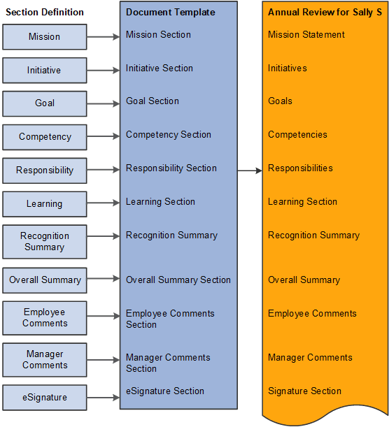

Sections are another building block for document templates. They form the structure of a performance or development document. For example, your organization may want its performance evaluations to include:
  • The organization's mission statement.
  • The department's initiative for meeting the mission statement.
  • The employee's goals.
  • The employee's competencies, responsibilities, or learning.
  • Recognitions that the employee received.
  • A section for overall ratings and comments.
  • A section for employee's to add additional comments.
  • A section for manager's to add additional comments.
  • A section for signatures.
Each of these are separate section definitions that can be added to the document template.
This diagram illustrates the relationship between sections, templates, and generated documents.
Definition relationships chart showing the relationships between sections, templates, and generated documents

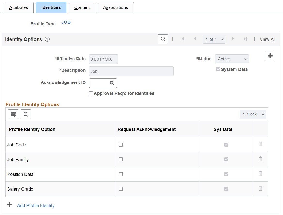

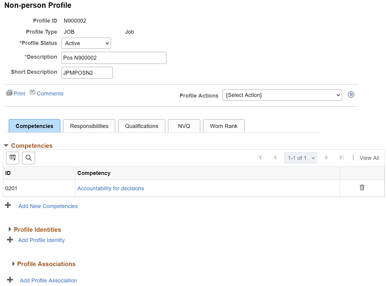

  3. (Optional) Define profile types.
    When competencies and responsibilities vary between jobs, you can use job profiles to generate the performance criteria associated with a section. This might be easier than creating a separate template for each job. Job profiles can be attached to job codes, job families, salary grades, and positions. That means that anyone associated with the same job code, job family, salary grade, or position will have the same content downloaded into their performance document.

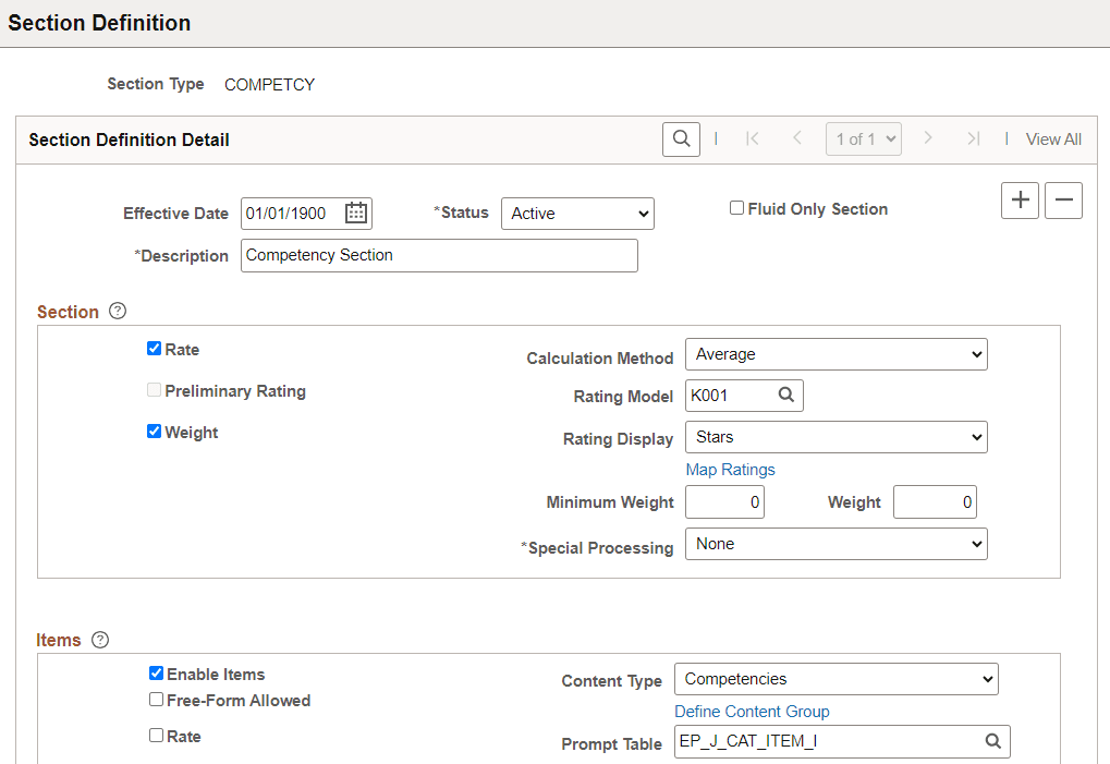

Use the Section Definition page (EP_SECTION_DEFN) to define sections.
Navigation:
Set Up HCM > Product Related > ePerformance > Document Structure > Document Section Definition > Section Definition
This example illustrates the fields and controls on the Section Definition page (1 of 2).
This example illustrates the fields and controls on the Section Definition page (2 of 2).
Enter the information that you want to use later to populate the fields on the Template Definition - Structure Page for the specified section. The descriptions you enter here are used to identify the sections that you want to add on the Template Definition page.
Field or Control
Description
Fluid Only Section
Select this check box if the corresponding section is applicable only to documents in Fluid.
For example, the Recognition Summary section is a Fluid-only section.
Section
Field or Control
Description
Rate
Select this check box to enable a rating assignment for the section, either by a system calculation or manually. A rating field or display appears in the section summary of each document created based on a template that includes this section. When the Rate check box is selected, a section summary rating must be specified (either by a system calculation or manually) in order to submit documents for approval.
The system enables this check box if Business Objectives, Learning, None, or Overall Summary is selected in the Special Processing field.
Calculation Method
Select the calculation method used for the section. Values include:
  • Average
  • Review Band
  • Summation
The system enables this field if the Rate check box is selected and the Special Processing field is set to Business Objectives, Learning, None, or Overall Section.
Preliminary Rating
Select this check box to enable the manager to enter a preliminary rating for the performance document.
The system enables this check box if the Rate check box is selected and the Special Processing field is set to Overall Summary.
Rating Model
Select the default rating model for the section.
The system enables this field if the Rate check box is selected and the Special Processing field is set to Business Objectives, Learning, None, or Overall Summary.
Rating Display
Select how values of the selected rating model are displayed on documents. This field becomes editable after selecting a rating model. Values are:
Drop-Down Box
Note: Always use the Drop-Down Box option if the selected rating model has more than 5 rating values.
Radio Buttons
Note: Do not use the Radio Buttons option for Fluid ePerformance. If selected, the system treats the value as Drop-Down Box.
(Fluid ePerformance only) Stars. This rating display supports rating models with 5 or less values.
Order By
Select how rating values are ordered using the setup data of the selected rating model.
This field appears if the selected rating display is Drop-Down Box.
Note: This option is Fluid ePerformance only.
Values are:
Numeric Rating (Numeric Rating column in rating model setup)
Rating Description (Description column in rating model setup; default value)
Review Rating (Rating column in rating model setup)
Rating models are defined on the Rating Model Page.
Map Ratings
Select to assign a star rating value (1 Star through 5 Stars to each review rating value of the selected rating model on the Map Ratings page (EP_MAP_RATING_TBL).
This link appears if the selected rating display is Stars.
You must complete this mapping to use the star rating display.
Weight (check box)
Select this check box to enable the section to have a weighting relative to the other sections in the document.
The system enables this check box if the Rate check box is selected and the Special Processing field is set to Business Objectives, Learning, or None.
You cannot weigh sections of a performance document when you select a calculation method of Summation or Review Band for the Overall Summary section and elect to have the system calculate performance ratings. (You enter calculation instructions through the Template Definition component.)
When selected, the Section Weight field appears in the section summary of documents created from templates that include this section. The field name is changed to Summary Weight when the document is in the Evaluation in Progress status.
Minimum Weight
Enter the minimum weight for the section. This field is used when ratings are calculated to ensure that the section weight cannot fall below a minimum value.
The system enables this check box if the Weight check box is selected.
Weight (field)
Enter the default weight for the section.
Special Processing
This field determines the type of information that is entered in this section and how the system processes the information.
  • Business Objectives – Select this option if you want this section to be connected to a business objective page to allow business objectives to be aligned and copied to a performance document.
  • Career Plan Summary – Select this option to allow managers to view employee’s career planning information. Information available in this section is read-only, and managers can click the Update Employee Career Plan link to transfer to Manager Self Service and edit employees’ career planning data. For the Roles Rules sections that appear at the bottom of the section definition, only the Manager role is available for selection.
  • Employee Comments – Select this option if this section is used by employees to enter and edit comments on the self-evaluation when the evaluation status is Shared with Employee, Pending Acknowledgement, or Acknowledged.
    This type of special processing allows the employee to enter their comments regarding the manager's assessment of the employees performance on the Manager Evaluation.
    When selected, all fields on the Section Definition page become unavailable.
  • Learning – Select this option if this section is used by employees and managers to add or view learning information, and for administrators to view and search for learning information from Enterprise Learning Management. The system only enables the Rate and Weight check boxes.
    Note: The Oracle Business Intelligent Publisher (BI Publisher) report includes the Learning section.
  • Manager Comments – Select this option if this section is used by managers to enter comments, in response to the employee's comments, on the performance evaluation when the evaluation status is Evaluation in Progress, Shared with Employee, Pending Acknowledgement, or Acknowledged.
  • None – Select this option if no special processing options apply. Most likely, you'll select this option when creating a section for a mission statement, initiatives, goals and objectives, competencies, or responsibilities.
  • Overall Summary – Select this option if this section contains the overall rating for the document. A document template can include only one section that is set to Overall Summary.
    When selected, all fields on the Section Definition page except the Rate field become unavailable.
  • Recognition Summary – Select this option to enable managers and employees to insert and view recognitions received by employees.
  • Signatures – Select this option if a predefined signature section appears on the printed version of the evaluation. This section consists of two signature rows: the first for the employee, the second for the manager. Each row includes a signature line and a date. To change the format of the signature lines in this section, modify the Text Catalog feature.
    Note: The Text Catalog entry for defining the signature format is APPR_MAIN1_INST2 for evaluations and APPR_BASE_SEC_DESC for the Establish Criteria document. The section type context key for both equals SIGN.
  • eSignatures – Select this option if you want the system to record the date and time that the employee acknowledged the review and the date and time that the manager finalized the review. When a document is viewed or printed using Oracle Business Intelligence Publisher (BI Publisher), the system displays the eSignature section with the employees name printed on the employee signature line along with the date and time the employee acknowledged the document. In addition the manager's name is printed on the manager signature line with the date and time the manager completed the document. The timing of the manager’s signature is dependent upon the review process selected on the template definition of the document.
    See Also Manager and Employee Signatures for the eSignature Section

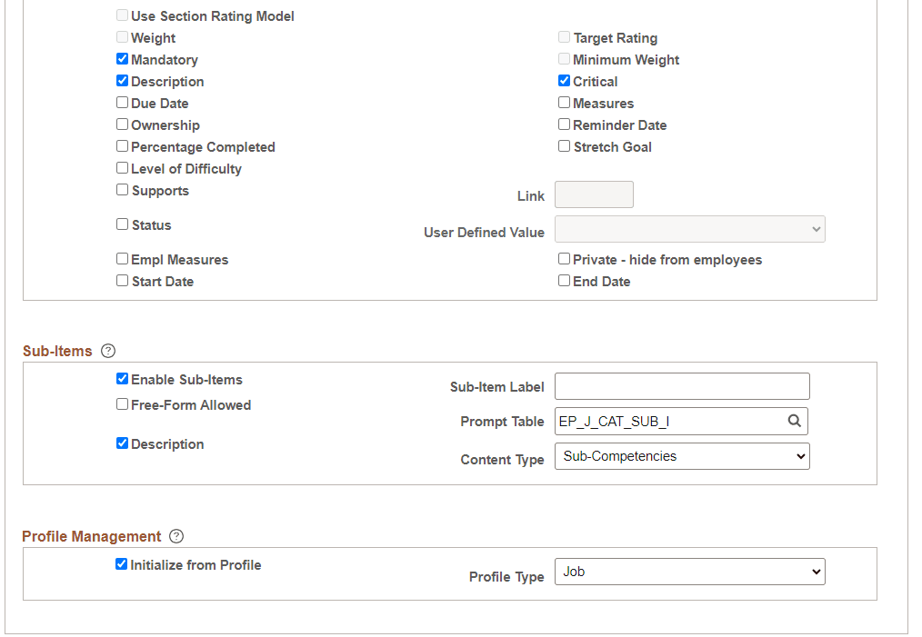

Items
Fields that are displayed in this group box determine if the section on the document can contain content items such as mission statements, initiatives, goals or objectives, competencies, responsibilities, or free-form items. A section must contain all items of the same content type. Items are evaluated or tracked depending on the rules that you specify.
The Items group box (the Enable Items check box specifically) becomes editable if the Special Processing field is set to Business Objectives or None.
Field or Control
Description
Enable Items
Select this check box to allow the section to contain items. Most fields in the Items section become editable when you select this field.
The system displays in documents the items that were loaded on the Template Definition - Content page for the section, as well as items that are added manually by users when they work on the documents.
Note: If you select the Critical check box, all check boxes and fields within the items group box will have a critical indicator.

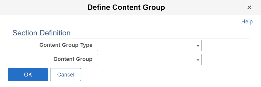

Define Content Group
Click this link to access the Define Content Group page (EP_CONTENT_SEC) where you can select both a content group type and a content group. Selecting a content group type and content group determine what sections will appear on the Template Definition page. This information is set up in the content catalog.
See Understanding the Content Catalog.

Use Section Rating Model
Select this check box to have the rating model for all items and sub-items on the document template default to the section rating model.
The system enables this check box if the Rate check box is selected and a rating model is entered in the Rating Model field in the Section group box.
Weight
Select this check box to enable the item in the section to have a weighting relative to the other items in the section.
The system enables this check box if the Rate check box is selected.
When selected, the Weight field appears on the Template Definition - Content page where you can enter the default weight for the corresponding item. At runtime, the Weight field appears for each item in documents created from templates that include this section.
Target Rating
Select this check box to indicate that content items can have a target proficiency rating assigned in the Target Rating field on the Template Definition - Content page. The target proficiency rating displays on the performance document for the content items.
Note: The target rating is used with the learning integration feature. If the employee doesn't make his or her target rating, the system sends the person's performance rating to ELM. ELM will then do a fit gap analysis, suggest a learning for the employee, and add a learning course to the learning grid.
Mandatory
Select this check box to allow items added to the template to be considered mandatory and therefore not to be edited or deleted.
When selected, the Mandatory check box appears on the Template Definition - Content page where you can indicate if any section item added to the template, either manually or loaded from a profile, is mandatory or not.
If the Mandatory check box is selected for an added item on the Content page of a template, the item cannot be deleted from documents that are created using that template. Also, specific attribute information of the item, such as due date and target rating, is read-only and cannot be edited.
Minimum Weight
Select this check box if content items need to have a minimum weighting.
When selected, the Minimum Weight field appears on the Template Definition - Content page where you can enter the minimum weight for the corresponding item.
Description
Select this check box to display the Description field on the Template Definition - Content page, as well as documents created using templates that include this section. When an item from the Content Catalog is added, the system displays the description associated with that item and it cannot be edited. If the item is manually added, you can edit the Description field unless the item is marked as mandatory on the Template Definition - Content page.
Critical
Select this check box to indicate that all check boxes and fields within the items group box can have a critical indicator.
Due Date
Select this check box to have items include a due date on the document. For example, managers might enter a due date by which an employee must become proficient in a certain competency or attain a particular goal. During the evaluation process, managers can update the due date.
Measures
Measurements describe the standards against which performance is compared. When an item from the Content Catalog is added, the system displays the measurement associated with that item and it cannot be edited. If the item is manually added, you can edit the Measurement field.
Ownership
Select this check box to have items contain the Owner field, which indicates who is responsible for the item: the employee or the manager. The flag is informational only; it does not cause any special processing to occur. During the evaluation process, managers can click an update link on the evaluation to edit the Owner field.
Reminder Date
Select this check box if items can contain a reminder date on the document. During the evaluation process, managers can click an update link on the evaluation to edit the reminder date.
Percentage Completed
Select this check box if items on a document can include a field for entry of the percentage complete. Employees and managers can use this field to indicate progress toward certain goals.
Stretch Goal
Select this check box to allow items on a document to be flagged as being a stretch goal. This field is for informational purposes only.
Level Of Difficulty
Select this check box to display the Level Of Difficulty field. The Level of Difficulty field includes Basic, Intermediate and Advanced as its values. You can associate these values with the difficulty of an item. When an item from the Content Catalog is added, this field displays the level of difficulty associated with that item and you cannot edit the values. If the item is manually added, you can select the level of difficulty unless the item is marked mandatory on the Template Definition - Content page.
Align Items and Links To
If you select Business Objectives in the Special Processing field, the system displays the Align Items and Links To fields.
Select the Align Items check box to align items in this section with business objectives. This field works in conjunction with the Links To field.
Select Any Section in the Links To drop down list box. On the performance document the system enables a user to associate a business objective to a specific item and displays the Alignment Chain icon, which a user can click to view how the objective they selected aligns with other higher level objectives. The system only enables this check box if the Align Items check box is selected.
Supports and Link
If you do not select Business Objectives in the Special Processing field, the system displays the Supports and Link fields.
Select the Supports check box to enable the association of items in this section with items in a different section of the same review. This field works in conjunction with the Link field.
Similar to cascading objectives, the Link option enables you to indicate that the current section supports another section. This association displays an informational message on the performance document. The system enables this check box if the Supports check box is selected.
Status and User Defined Value
Select this check box to have items in the section of a document include a field that identifies the status of the item. Possible statuses are Complete, In Progress, and N/A (Not Applicable).
The values that are available for selection in the User Defined Value field are defined on the Custom Prompt Page.
Empl Measures (employee measures)
Select this check box if you want the system to display an Employee Measurement field for the section. An employee or manager can use this field to describe how the item they are defining should be measured.
Private - hide from employees
Select this check box if you want to enable managers or employees to indicate the privacy setting of items they are defining in this section. When an item is set as private, it cannot be copied to other documents.
Start Date
Select this check box if you want to enable managers or employees to set start dates for the items they are defining in this section.
End Date
Select this check box if you want to enable managers or employees to set end dates for the items they are defining in this section.
Sub-Items
The system enables fields in this group if the Enable Items check box in the Items group box is selected.
Field or Control
Description
Enable Sub-Items
Select this check box to indicate that the section can contain sub-items. Sub-items are typically sub-competencies that are created through the Competency section.
Sub-Item Label
Specify the label used to name sub-items in this section, if applicable. If not specified, the default label for sub-items is Sub-Item.
Note: This field applies to Fluid ePerformance only.
It becomes editable when the Enable Sub-Items field is selected.
Free-Form Allowed
Select this check box to enable users to add free-form (non-coded) sub-items to this section.
Prompt Table
Select the name of the table that holds the sub-items that are included in the section.
Content Type
Select the content type from which content items will be selected. The content types available for selection are those that are associated with the value you selected in the Content Type field in the Items section. Content types are set up under a content group type in the content catalog.
The Content Type and Content Group Type fields are used for search when adding a predefined competency to the evaluation criteria specified on the document template.
Description
Select this check box to have the description for the sub-item appear on the evaluation. During the evaluation process, managers can click an update link on the evaluation to edit the description for the sub-item.
Profile Management
Use this group box to enable the system to automatically populate relevant content items in the section when new documents are created for employees.
Field or Control
Description
Initialize from Profile
Select this check box if you want relevant competencies or responsibilities that are associated with a specified profile type (through profiles) to be automatically loaded from a profile into documents that are created for employees.
This check box becomes editable if the Enable Items check box in the Items group box is selected and a content type is specified in the system.
Profile Type
Select the profile type to be used to identify the profiles of the content items to be populated. These profile types are defined in the Manage Profiles business process.
The system enables this field if you select the Initialize from Profile check box. A role can be tied to person profile in the Evaluation Role Rules grid.
Here is an example of how the system determines which content items to populate to a performance document for an employee in the document creation process.
Suppose that the Initialize from Profile option is enabled for the Competencies section and you have specified Job as the profile type. At runtime, when a user creates a performance document using a template that includes the Competencies section, the system:
  1. Identifies the profile type (Job) that is specified in the Profile Type field for the section, and locate all profile identity options that are associated with that profile type.
    This example illustrates the fields and controls on the Profile Types - Identities page.
  2. Identifies, for each profile identity option, key values that are specified for all of the profiles.
    This example illustrates the fields and controls on the Non-person Profile page.

Use the Define Content Group page (EP_CONTENT_SEC) to select both a content group type and a content group.
Navigation:
Click the Define Content Group link on the Section Definition page.
This example illustrates the fields and controls on the Define Content Group page.
Select the content group type and content group. The content group type and content group determine what sections will appear on the Template Definition page. This information is set up in the content catalog.
