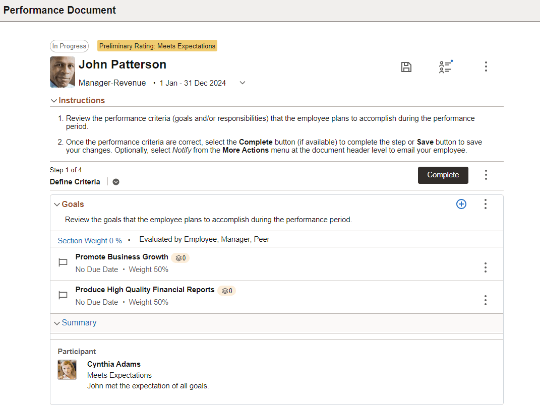

Use the Performance Document page (EP_MAIN_DOC_B_FL) to add or update evaluation criteria for documents.
Navigation:
Select a document from the Define Criteria section of a document list (Team Documents, Delegated Documents, or My Documents).
This is an example of the Performance Document page in the Define Criteria step (1 of 2).
This is an example of the Performance Document page in the Define Criteria step (2 of 2).
Note: The fields and controls that appear in a document is controlled by its template, which is highly configurable. The sample document used in this topic is for demonstration purposes only, and is likely to look different from your implementation.
Instructions
This section displays user instructions for the current document step. Instructions are text catalog entries. The content can be different based on the document usage, the role of the logged-in user, and the current document step.
It appears when the View Instructions field is set to Display in Modal Window in the document’s template definition.
Step Information and Actions
Field or Control |
Description |
Displays the step of the review process that the document is currently in. Select the icon to expand the popup menu and view the overall progress of the document in the review process. The popup menu displays the list of steps (and due dates) that are available in the review process, based on the associated template. The steps shown may or may not be entirely applicable to the user who is viewing the list. The list provides a quick update of where you are in the review process. It shows the current step (name appears in bold font), previous steps that were done (Completed or Skipped), and remaining steps to be worked on (Not Started). You can select a previous step to view the last-updated and read-only version of the document in that step. Some actions are still available for you to drill down and view the content of the document, such as item details, ratings and comments, and notes. However, you can no longer edit the document. |
Complete |
Click this button to complete the Define Criteria step. |
Click to view the list of actions that are applicable to the current step and select an action to perform. The list of actions varies based on a few factors, such as the template setup, the current step of the document, and your user role. |

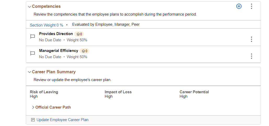

<Section Name>
See Also Performance Document Page, <Section Name> section.
Field or Control |
Description |
Click to add items to the section on the Select/Create Items Page. This action is available if your role can add items in the current step based on the template setup. |
Click to view the list of actions that are applicable to the section and select an action to perform. The list of actions varies based on a few factors, such as the template setup, the current step of the document, and your user role. See Section-Level More Actions. Note: The More Actions menu is not available to sections that cannot be weighted or cannot have items, for example, Career Plan Summary, Employee Comments, Manager Comments, Overall Summary, Signatures and eSignatures. |
Section Weight <number> % |
Displays the weight of the section in percentage. The total weight of all weighted sections in a document is 100%. Click this link to update the section weight on the Section Weight page. This link appears if the section can be weighted based on the template setup. |
<Item title> |
Click to access the item on the Performance Document Item Page. |
Indicates the number of sub-items added to the corresponding item. |
Weight <number>% |
Displays the weight of the item in percentage. The total weight of all items in a section is 100%. This text appears if items in this section can be weighted based on the template setup. |
Click to view or add notes for the item on the My Notes Page. This icon appears if notes were added to the item. |
Click to view the list of actions that are applicable to the item and select an action to perform. The list of actions varies based on a few factors, such as the template setup, the current step of the document, and your user role. |
Summary |
(Manager only) Click the link to expand the summary area and view feedback entered by participants for the section. This link appears if participant feedback is available during the Define Criteria step and your user role has the permission to view it. |
Career Plan Summary
This section lists the career planning information for the employee. This section appears if it is included in the template setup. It is tied to the Career Planning Summary special processing and does not include any items. The section name is configurable in the template.
