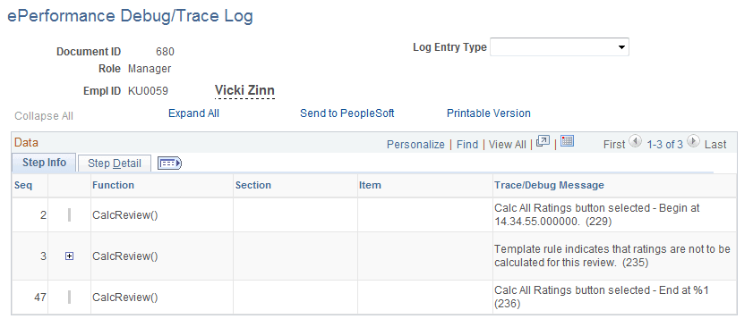

Use the ePerformance Debug/Trace Log page (EP_DEBUG) to view the detailed calculations for a document so that you can debug or trace the calculation.
Navigation:
This example illustrates the fields and controls on the ePerformance Debug/Trace Log page.
Note: To access this page you must select the Debug Rating Calculations check box on the ePerformance page (Set Up HCM, Install, Product Specific, ePerformance Installation, ePerformance) and then perform a calculation on a Manager Evaluation page.

Log Entry Type |
Select a log entry type to filter the output. Options are:
Send to PeopleSoft |
Click to access the Launch Diagnostics page (PT_DIAG_PLUGIN) and send the diagnostics information to Oracle. For more information on the delivered HCM application diagnostic plug-in for ePerformance, seeePerformance. |
Printable Version |
Click to render a page that presents all trace information, without tabs, so that you can print a copy. Note: When using the browser's File, Print option to print this page, be sure to set the printer layout to landscape mode. |
Step Detail Tab
Click this tab to view the rating model, calculation method, review rating, numeric rating, review points, and the trace/debug messages for the employee.

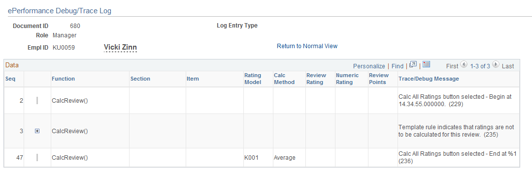

Use the ePerformance Debug/Trace Log (printable version) page (EP_DEBUG_PRNT) to display all calculation information on a single page for convenient printing.
Navigation:
Click the Printable Version link on the ePerformance Debug/Trace Log page.
This example illustrates the fields and controls on the ePerformance Debug/Trace Log page (printable version).
