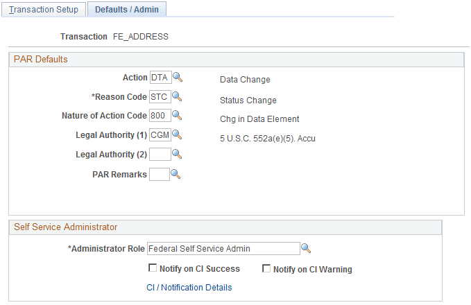

You use the Defaults / Admin page to define the role of the person that you want to receive the notification when any of these conditions occur.
Use the Defaults / Admin page (GVT_WIP_RECORD3) to identify the self-service administrator and define PAR tracking data.
Navigation:
This example illustrates the fields and controls on the Defaults / Admin page. You can find definitions for the fields and controls later on this page.
Self-Service Administrator
Field or Control |
Description |
Administrator Role |
Select the role that you want notified when an error, warning, or success occurs. |
Notify on CI Success (notify on component interface success) |
Select this check box to have the person who is identified in the Administrator Role field notified when the process runs successfully. |
Notify on CI Warning (notify on component interface warning) |
Select this check box to have the person who is identified in the Administrator Role field notified when a warning occurs during processing. |
CI / Notification Details |
Click this link to open the CI / Notification Details page. |

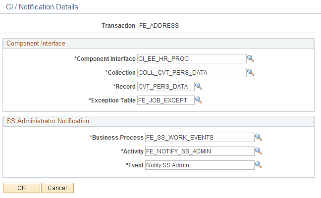

Use the CI / Notification Details (component interface / notification details) page (FE_CI_DETAIL) to define notification and self-service administrator details.
Navigation:
Click the CI / Notification Details link on the Defaults / Admin page.
This example table illustrates the fields and controls on the CI / Notification Details page. You can find definitions for the fields and controls later on this page.
Note: It is recommended that you not change the information on this page for the delivered federal self-service transactions.
Component Interface
Field or Control |
Description |
Component Interface |
Select the name of the component interface process that is used for this transaction. |
Collection |
Select the name collection that is used by the component interface process for this transaction. |
Record |
Select the name of the record that is used by the component interface process for this transaction. |
Exception Table |
Select the name of the exception table that is used by the component interface process to store errors and warnings for this transaction. |
SS Administrator Notification
Field or Control |
Description |
Business Process |
Select the name of the business process that is triggered to send component interface notifications to the self-service administrator. |
Activity |
Select the name of the activity that is triggered to send component interface notifications to the self-service administrator. |
Event |
Select the name of the event that is triggered to send component interface notifications to the self-service administrator. |
