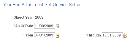

Use the Year End Adjustment Self Service Setup page (GPJP_YEA_SETUP) to specify the period during which the YEA data self-service transaction is available to employees and specify the effective date of tax and deduction data entered through the transaction.
Navigation:
This example illustrates the fields and controls on the Year End Adjustment Self Service Setup page.
Field or Control |
Description |
Object Year |
The year that is being adjusted. |
As Of Date |
The system uses this date when retrieving current information from effective-dated tables. The system also uses this date as the effective date when loading YEA self-service data into tables. |
From and Through |
Enter the begin and end dates of the period that employees can access the YEA data self-service transaction. |
