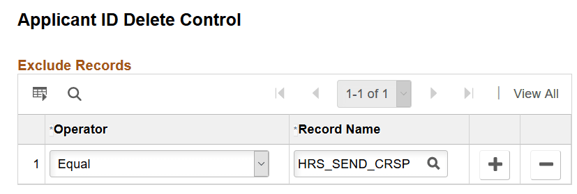

Use the Applicant ID Delete Control page (HRS_APP_EXC_REC) to identify tables where applicant data will not be deleted.
Note: As delivered, only users with the role ID Delete Administrator can modify this page.
Navigation:
This example illustrates the Applicant ID Delete Control page.
Field or Control |
Description |
Operator |
Select Equal to exclude the specific record that you specify.. Select Like to exclude records with record names like the string that you specify. |
Record Name |
Enter the name of the record to be excluded from the deletion process. |
Important! Users with the ID Delete User role can choose whether to check for excluded records when running the Applicant ID Delete process. If a user chooses not to check, then all applicant data is deleted regardless of your exclusion rules.

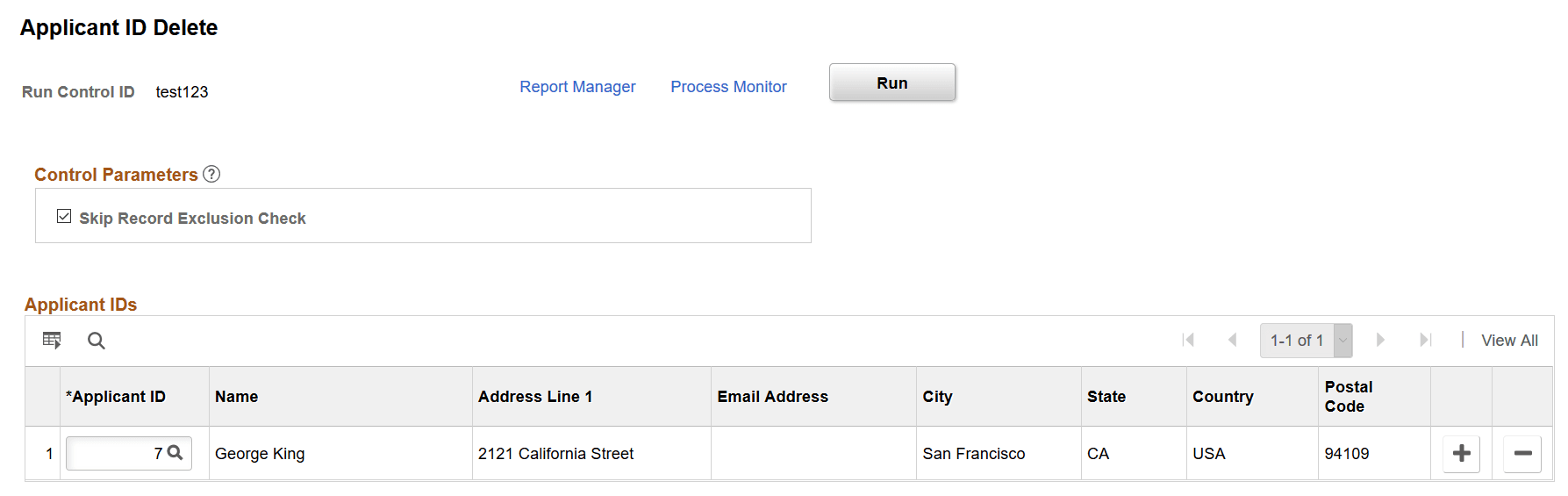

Use the Applicant ID Delete page (HRS_APP_ID_DELETE) to select applicant to be deleted and run the applicant delete process.
Navigation:
This example illustrates the Applicant ID Delete page.
Field or Control |
Description |
Run |
Click the Run button to access the Process Scheduler Request page, where you can run or schedule the Applicant ID Delete process. Before the Process Schedule Request page appears, the system displays a warning that the deletion process is irreversible. |
Control Parameters
Field or Control |
Description |
Skip Record Exclusion Check |
Select this check box to ignore the Exclude Records settings on the Applicant ID Delete Control Page. This check box is deselected by default. With this default setting, the deletion process does not affect tables that the process is configured to exclude. When you select this check box, all applicant data is deleted. Note: Only users with the role ID Delete User can modify this setting. |
Applicant IDs
Field or Control |
Description |
<sequence number> |
If you enter multiple applicant IDs in the grid, the Applicant ID Delete process runs through each applicant in sequence. The sequence number matches the process sequence number that appears on the Applicant ID Delete Log Page . |
Applicant ID |
Enter the applicant ID for the applicant to be deleted. The system populates the other columns in the grid with the applicant’s name, address, and email address. This read-only information helps you verify that you’ve entered the correct applicant ID. After you run the deletion process, all applicant data (including the applicant ID) is cleared from the grid. |
Note: The maximum number of rows you can delete is 999.

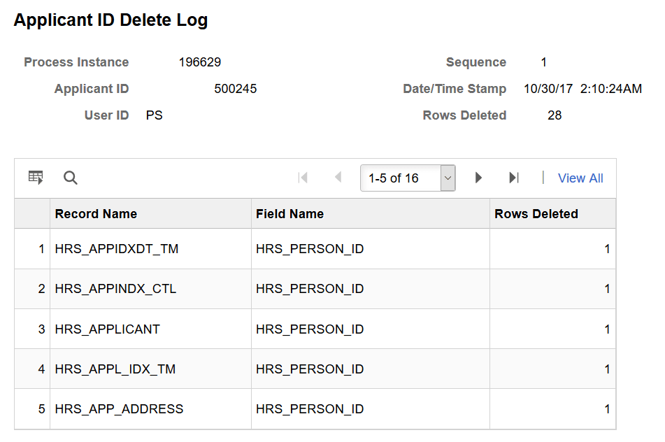

Use the Applicant ID Delete Log page (HRS_APP_ID_DEL_LOG) to review the data that was deleted for a specific applicant ID.
Navigation:
This example illustrates the Applicant ID Delete Log page.
Process Information
Field or Control |
Description |
Process Instance |
Identifies the specific instance of the Applicant ID Delete process that you are reviewing. |
Sequence |
The Sequence number reflects the order in which the Applicant ID Delete process handles multiple applicants. For example, if an instance of the process deletes three applicants, the Sequence number 1 is assigned to the first applicant to be deleted and 3 is assigned to the last applicant to be deleted. |
Applicant ID |
Displays the original applicant ID for a single applicant who was deleted. A single instance of the process can delete multiple applicant IDs, but this page displays information for only one applicant at a time. |
Date/Time Stamp |
Indicates when the Applicant ID Delete process ran. This is the date and time for the process instance, so it is the same for all applicants who were processed together. |
User ID |
Identifies the user who ran the specified instance of the Applicant ID Delete process. |
Rows Deleted |
Displays the total number of rows (across all records) that were deleted for the specified applicant. |
Record Details
Field or Control |
Description |
Record Name |
Identifies a record where rows were deleted. |
Field Name |
Identifies the applicant ID field in the record. Typically the value is HRS_PERSON_ID. |
Rows Deleted |
Displays the number of rows that were deleted from the specified record. |
