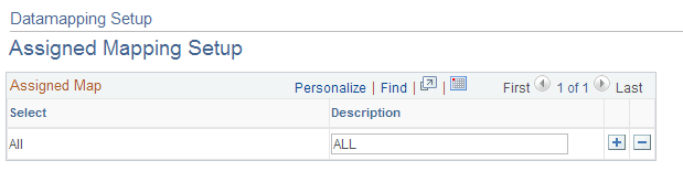

Use the Assigned Mapping Setup page (HRS_DM_MAP_SETUP) to create data mapping assignments.
Navigation:
This example illustrates the Assigned Mapping Setup page.
Assigned Map
Use this group box to specify the vendors, sites, or recruitment sources that will not use the default data map. The description is used on the Unmapped Data, Key Data Mapping, and Value Data Mapping pages.

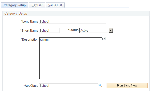

Use the Category Setup page (HRS_DM_CAT_SETUP) to set up categories.
Navigation:
This example illustrates the Category Setup page.
Field or Control |
Description |
AppClass (application class) |
Select an application class category. These categories are defined on the Application Class Registry page. |
Run Sync Now (run synchronization now) |
Click to synchronize the data that is associated with the selected data mapping category with the data actually existing in the corresponding component. This process populates the Key List and Value List pages. |

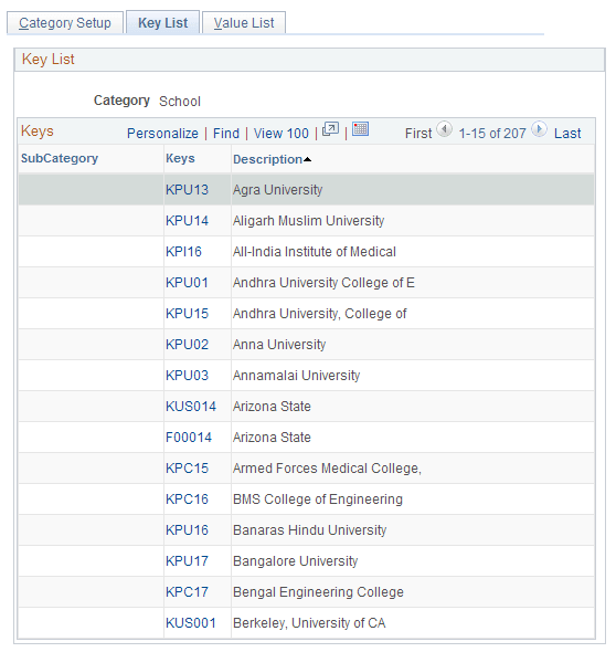

Use the Key List page (HRS_DM_CAT_KEYLIST) to view key lists.
Navigation:
This example illustrates the Key List page.
Field or Control |
Description |
Subcategory |
Serves as a secondary key for the data mapping functionality. Not all categories use the subcategory secondary key. Subcategories themselves must also be data mappings. |
Keys |
Displays the primary key for the category. These keys are determined by the data in the associated data mapping category tables. Click the key link to access the Key Data Mapping page. This page displays all the values that are mapped to the given key. |

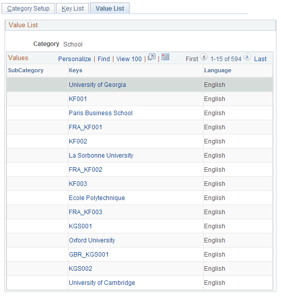

Use the Value List page (HRS_DM_CAT_VALLIST) to view value lists.
Navigation:
This example illustrates the Value List page.
The Value List page lists all the values that are being mapped to a category key. Click a link in the Keys column to access the Value Data Mapping page.

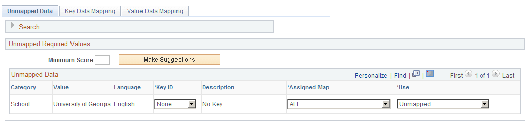

Use the Unmapped Data page (HRS_DM_UNMAPPED) to map unmapped data.
Navigation:
This example illustrates the Unmapped Data page.
Field or Control |
Description |
Minimum Score |
Identifies a threshold for the Make Suggestions search. Only results that are greater than or equal to the minimum score appear in the Key ID field. The score of every suggestion found appears to the right of each key ID item in parentheses. |
Make Suggestions |
Click to run a search that provides a suggested mapping based on the minimum score that you entered. |

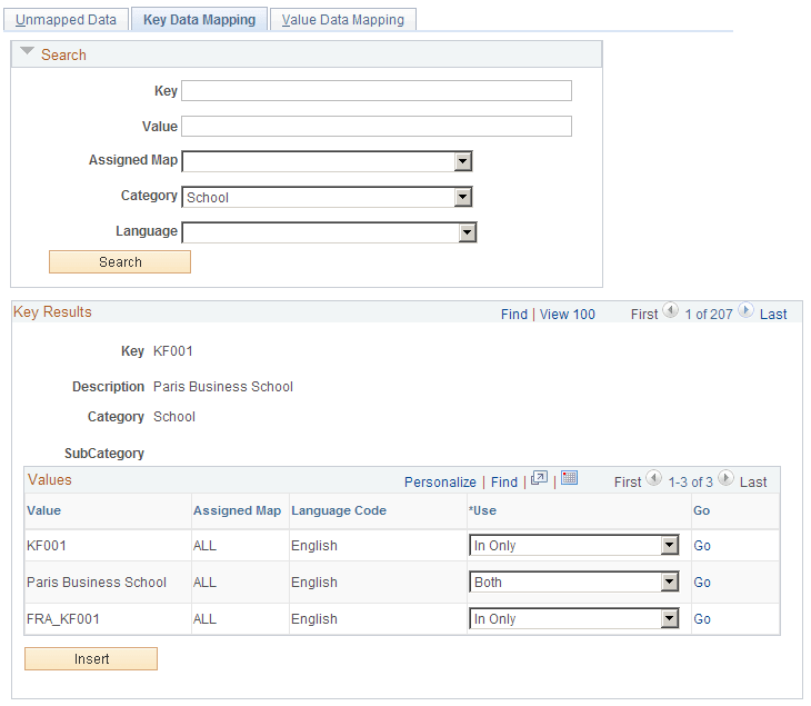

Use the Key Data Mapping page (HRS_DM_MAPING_DICT) to map keys.
Navigation:
This example illustrates the Key Data Mapping page.
This page displays a complete list of all the values that are mapped to a given key.
Values
This group box enables you to add other values to the key. The values must be chosen from the unmapped data values.
Field or Control |
Description |
Value |
Select the values that are associated with the key. |
Assigned Map |
Select the data mapping assignment that the key is associated with. |
Language Code |
Select the language that the value is assigned to |
Use |
Select to use this data mapping for incoming data, outgoing data, or both. |
Insert |
Click to add a row to the group box. |

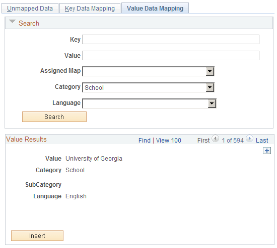

Use the Value Data Mapping page (HRS_DM_VALUE) to map values.
Navigation:
This example illustrates the Value Data Mapping page.
Displays all the keys that are mapped to the given value.
Keys
This group box displays all the keys that are mapped to the value and enables you to map more keys to the value. The keys that you add come from the unmapped data values.
Field or Control |
Description |
Key |
Select the key ID of the data mapping. |
Assigned Mapping ID |
Use |

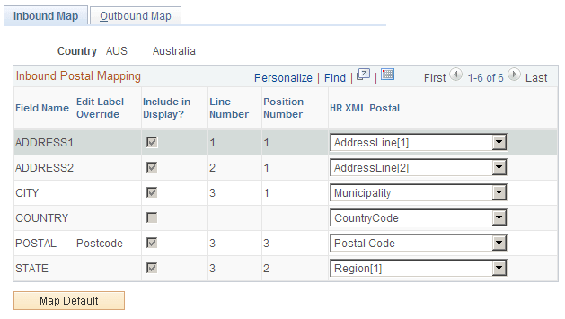

Use the Inbound Map page (HRS_HRXML_PSTL_IN) to map inbound postal information.
Navigation:
This example illustrates the Inbound Map page.
This page displays the field names that are associated with the Country table.
Field or Control |
Description |
HR XML Postal |
Select the XML element where you want the corresponding PeopleSoft field to be written for incoming messages. |
Map Default |
Click to have the system make an initial guess at what the mapping from the XML should be. |

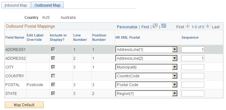

Use the Outbound Map page (HRS_HRXML_PSTL_OUT) to map outbound postal information.
Navigation:
This example illustrates the Outbound Map page.
This page displays the address field names that are associated with the Country table.
Field or Control |
Description |
HR XML Postal |
Select the XML element where you want the corresponding PeopleSoft field to be written for outgoing messages. |
Map Default |
Sequence |
When multiple data elements from the PeopleSoft address table are mapped to a single element in the XML document, the sequence number determines the order in which the PeopleSoft fields are mapped. |
