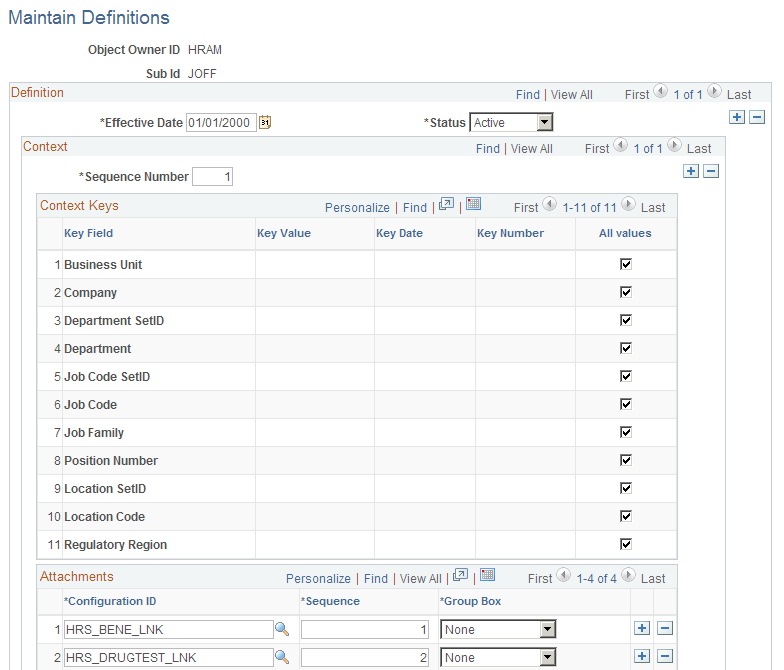

Go to the Maintain Definitions page and access the record for the HRAM (HR Applicant Manager) owner ID.
The owner ID controls which PeopleSoft HCM business process can access the attachment. The HRAM owner ID identifies attachments that are available for job offers.
Establish the contexts in which attachments are to be available, and associate specific attachments with each context.
As delivered, the HRAM owner ID has context keys for Business Unit, Company, Department SetID, Department, Job Code SetID, Job Code, Job Family, Position Number, Location SetID, Location Code, and Regulatory Region. The attachment framework enables you to modify the context keys to suit your business requirements.
This illustration shows the Maintain Definitions page for the HRAM owner ID. In this illustration, the All Values check box is selected for all of the context keys, so the listed attachments will be available for all job openings, regardless of the business unit, company, and so forth.
To add attachments that are available for just one specific business unit, you would create an additional row in the Context scroll area, deselect the All Values check box for the Business Unit key field, and enter the specific business unit for the context. You would then add the business unit-specific attachments to the Attachments grid.

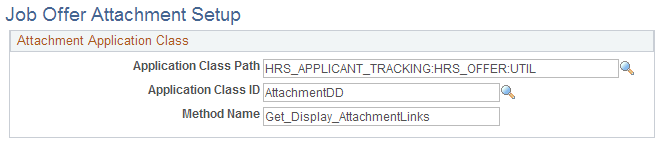

Use the Job Offer Attachment Setup page (HRS_ATCH_SETUP) to identify a custom application class to control which attachment framework attachments are visible to a recruiter who is adding attachments to a job offer.
Navigation:
This example illustrates the Job Offer Attachment Setup page.
Field or Control |
Description |
Application Class Path, Method Name, and Method Name |
The method identified by these three fields here is called from the page activate of the Organizational Attachments page (HRS_OFF_SELATC_SEC) in the Job Offer component. It determines which job offer attachments are displayed on the Organizational Attachments page if a match is found for the context keys passed in. See Organizational Level Documents Page. To invoke custom processing, clone the delivered method, then modify the it according to your needs. Save the customized application class as a new application class within HRS_APPLICANT_TRACKING, then enter the new method name on this page. |
