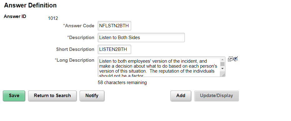

Use the Recruiting Answer Definition page (HRS_ANSWER_DEF) to set up answer definitions.
Navigation:
This example illustrates the Recruiting Answer Definition page.
Field or Control |
Description |
Answer Code |
Enter a code that identifies this answer. This code appears only on search pages and lookup dialog boxes. The system does not require this to be a unique code. |
Description |
Enter an identifying name for this answer. A descriptive name helps you when you reference the answer definition from within a question definition. Other pages that display answers, however, use the full text of the answer rather than these shorter identifiers. |
Long Description |
Enter the complete text of this answer. |

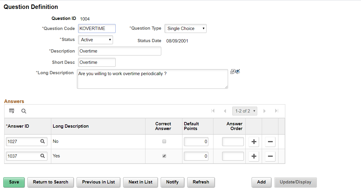

Use the Recruiting Question Definition page (HRS_QSTN_DEF) to set up question definitions.
Navigation:
This example illustrates the Recruiting Question Definition page for Single Choice question.

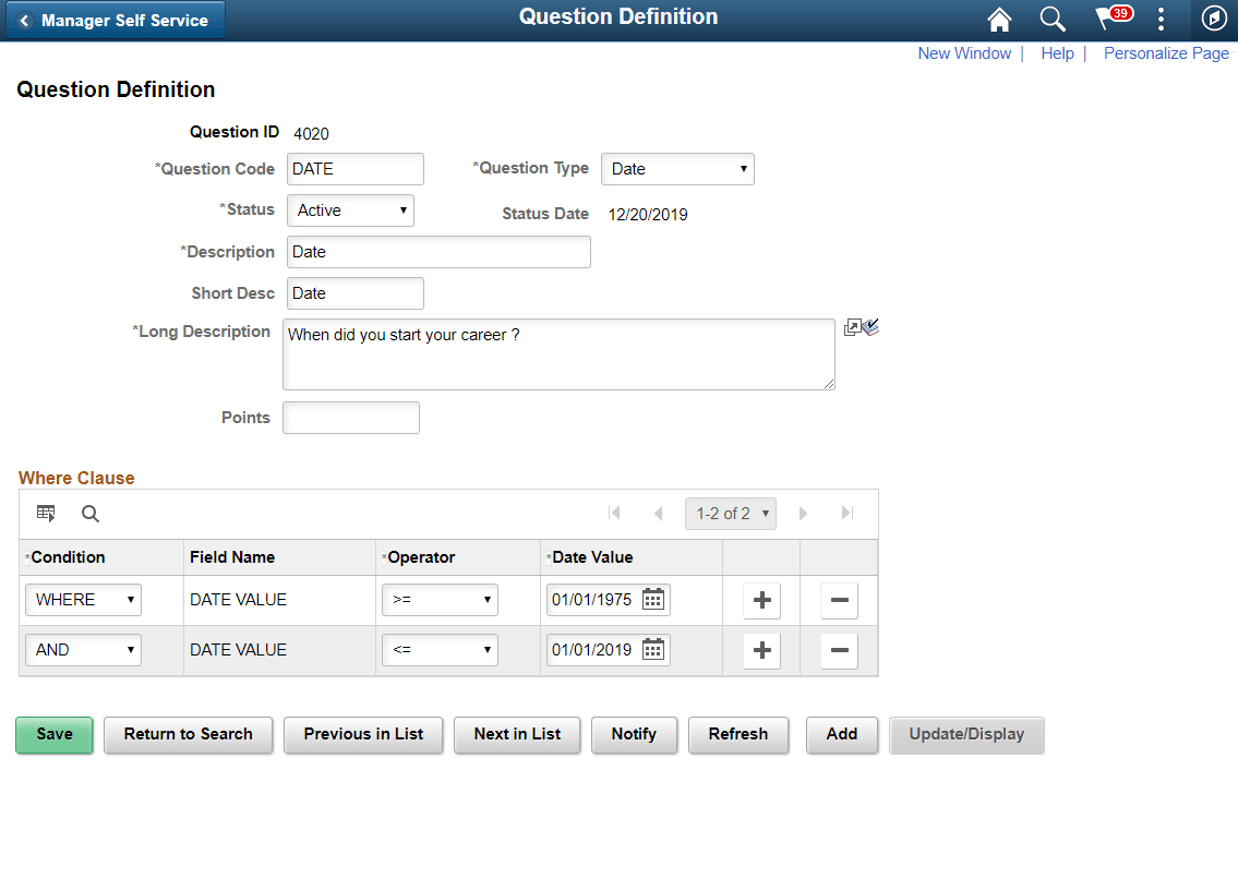

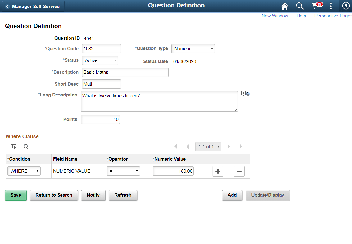

Question Definition page for Numeric question.
Question Definition page for Date type question.

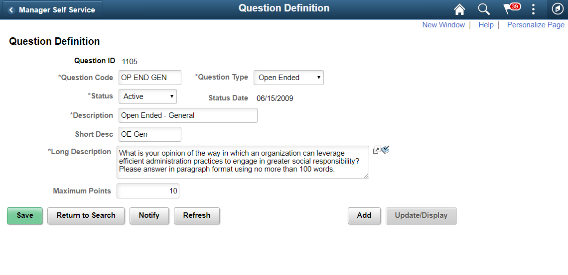

Question Definition page for open ended question.
Field or Control |
Description |
Question Code |
Enter a code that identifies the question. This code appears only on search pages and lookup dialog boxes. The system does not require this to be a unique code. |
Question Type |
Choose the appropriate question type. The Answers grid changes based on the question type selected. The different question types are:
Status and Status Date |
Indicate whether the definition is Active or Inactive. Whenever you change the status, the system changes the status date to the current date. |
Description and Short Description |
Enter an identifying name for this question. A descriptive name helps recruiters identify the question when they manage the list of questions in a job opening or question set. |
Long Description |
Enter the complete text of this question. |
Maximum Points |
If this is an open-ended question, enter the maximum number of points (up to 100) that an applicant can receive for answering this question. The actual number of points that the applicant receives is determined by averaging scores that evaluators manually assign. Evaluators who have not yet evaluated the answer are not included in the calculation. |

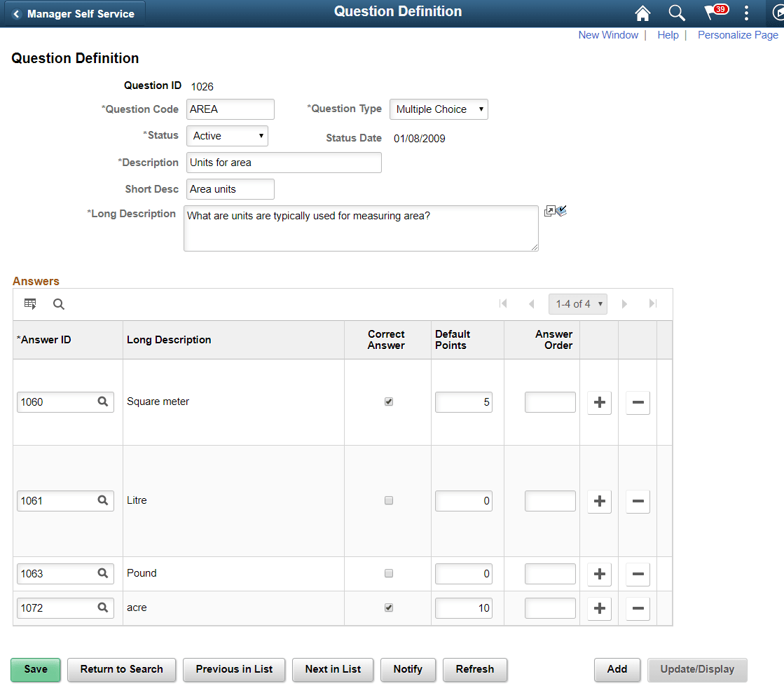

Answers
This grid does not appear for open-ended, Date and Numeric type questions. Multiple-choice questions must include at least two answers. Single choice questions can have more than one correct answer but the candidate can choose only one answer. The answers appear as check boxes in the online questionnaire. For Date type and Numeric questions, a Where Clause appears where you can specify the condition for the correct answer.
Field or Control |
Description |
Answer ID |
Select an answer to link to the question. |
Long Description |
After you enter an answer ID, the text of the answer (the long description on the Answer Definition page) appears in this column. |
Correct Answer |
Select the check box next to any answer that is correct answer for the question. There can be more than one correct answer. There must be at least one correct answer. |
Default Points |
Enter the default number of points that an applicant who selects this answer receives during screening. You can assign points to both correct and incorrect answers, depending on your business processes. When applicants can choose more than one answer, the screening process adds the points for all chosen answers to calculate the total points that the applicant is awarded for the question. It is possible to assign negative points to incorrect answers. Recruiters can override the correct answer and default point value of an answer when configuring criteria for a specific screening level in a specific job opening. |
Answer Order |
Optionally enter numbers to set the order of the answers. This order is used wherever questions and answers appear in Candidate Gateway and Talent Acquisition Manager. If you enter an order for some answers but not others, the answers without orders appear first, followed by the ordered answers. If multiple answers have the same value (or with no value) in this field, the system uses the Answer ID to order those answers. Note: If the Randomize Screening Answers field on the Recruiting Installation – Jobs Page page has a Yes value, then the system disregards the answer order and presents answers in random order. |

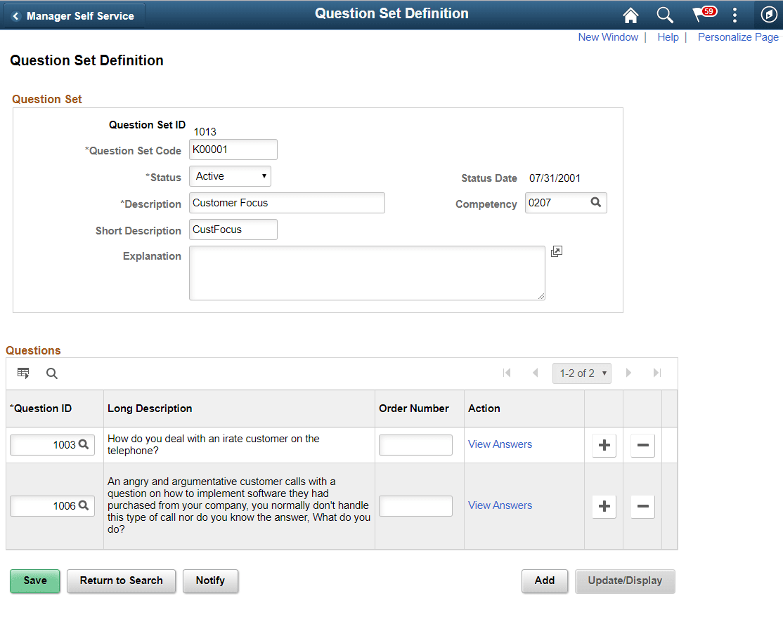

Use the Recruiting Question Set page (HRS_QSTN_SET_DEF) to set up question set definitions.
Navigation:
This example illustrates the Recruiting Question Set page.
Field or Control |
Description |
Question Set Code |
Enter a code that identifies this question set. This code appears only on search pages and lookup dialog boxes. The system does not require this to be a unique code. |
Description |
Enter an identifying name for this question set. A descriptive name helps recruiters identify the question set when prompting for a question set to add to a job opening. |
Competency |
Optionally identify the competency that is assessed through the applicant's answers to the questions in the question set. This is informational only; the competency does not affect the job opening, nor is it added to the job opening when you load the question set. |
Explanation |
Enter details about the purpose or contents of the question set. This is helpful to anyone who needs to update the question set. It is not visible to users who add the question set to a job opening. |
Questions
Field or Control |
Description |
Question ID |
Enter the ID of each question that you want to add to the question set. |
Long Description |
After you enter a question ID, the text of the question (the long description on the Question Definition page) appears in this column. |
Order Number |
Enter numbers to control the default order of the questions in the set. When you load the question set into a job opening, these become the default order numbers in the Screening Questions grid. Users can then modify the order numbers for the individual job opening. The system does not prevent you from assigning the same order number to multiple questions. When you load question set definitions into a job opening, review the default order numbers and update them as necessary to create an unambiguous question order. Because this field accepts only integers, consider using non-consecutive numbers to make it easier to insert additional questions between existing questions. Note: If the Randomize Screening Questions field on the Recruiting Installation - Jobs page has a Yes value, then the system disregards the question order and presents questions to applicants in random order. |
Action |

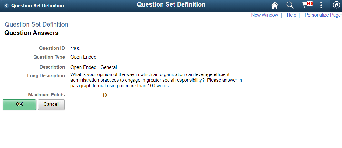

Displays a link to the Question Answers page. For open-ended questions, the link text is Open Ended. When you click this link, the Question Answers page displays the text and the maximum point value of the open-ended question. For other questions, the link text is View Answers. When you click this link, the Question Answers page displays the question, its correct and incorrect answers, and the default point value of each answer. |

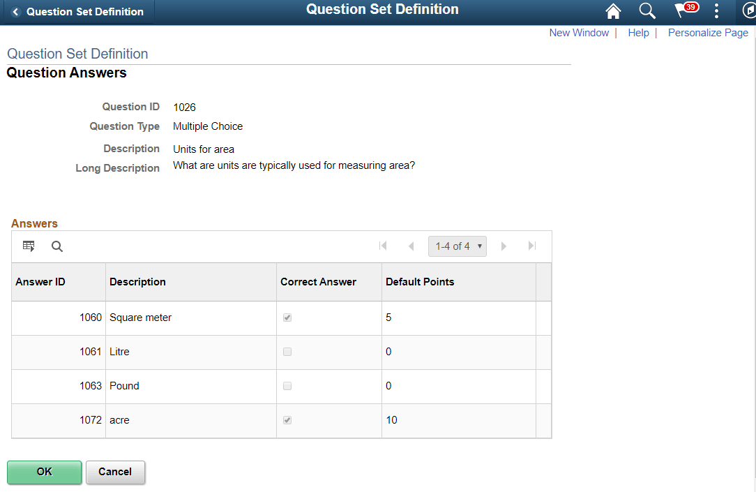

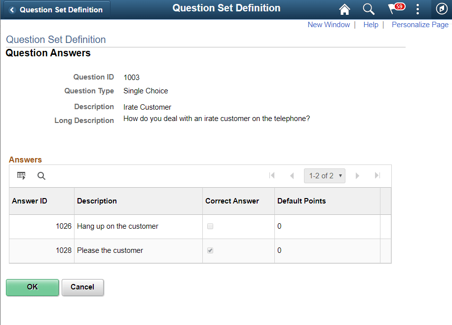

Use the Question Answers page (HRS_QSTN_SET_ANS) to view answers to questions.
Navigation:
Click the link in the Action column of the Questions grid on the Question Set Definition page.
This example illustrates the Questions Answers page for a multiple-choice question.
Question Answer page: Multiple Choice question
This example illustrates the Question Answers page for an open-ended question.

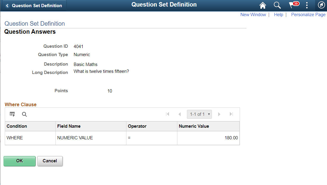

Question Answers page: numeric question.

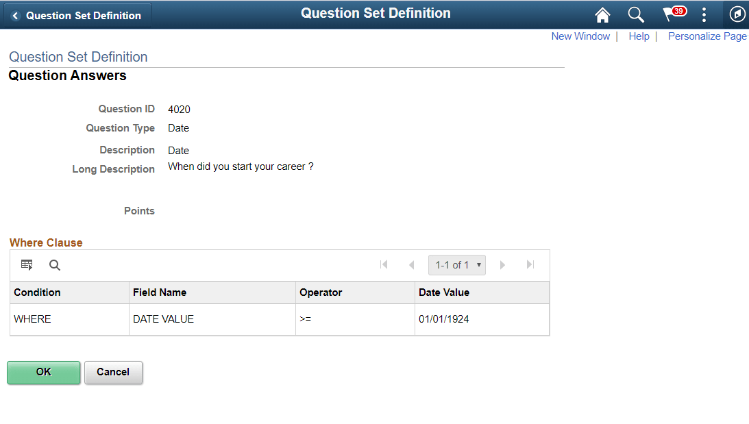

Question Answers page: Date type question
For multiple-choice questions, this page displays the answer choices and their default point values.
For open-ended questions, this page displays the question and its maximum point value.
For Numeric and Date value questions, this page displays the where clause and the default points values.
