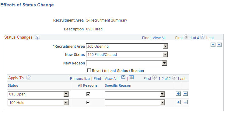

There are restrictions on the changes allowed. For example, changing an applicant's status to Inactive, doesn't have an impact on the status of a job requisition, but it does have an impact on the status of the applicant's open applications. The following example illustrates how status values in each recruitment area impact statuses in other recruitment areas.
You define the rules for changing status values on the Effects of Status Change page.
For each rule, you define:
Recruitment area affected.
The records within the recruitment area that are affected by the status change.
The new status and reason code that the system applies to those affected records.
This example illustrates the Effects of Status Change page for the Hired status.
In this example, when an applicant's application is set to 090 Hired, the following rule is applied:
The recruitment area that is affected is Job Opening.
The new status that the system applies is 110 Filled/closed.
Note: This example shows only one of the delivered rules for the Hired status. The Hired status has other rules that you access by clicking the navigation buttons.
