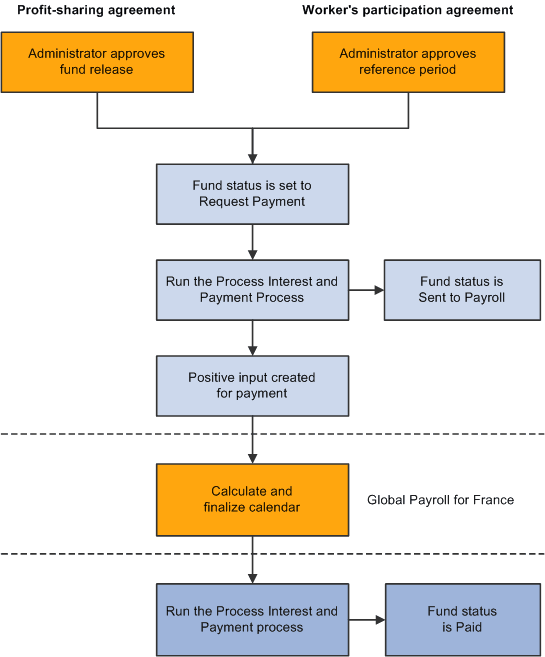

If you installed Global Payroll for France, you can use it to automatically process payments. The following diagram illustrates the payment processing with Global Payroll for France:
Payment processing with Global Payroll for France

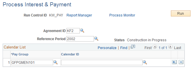

Use the Process Interest & Payment page (RUNCTL_WP_PAYMT) to run the process for a selected agreement and reference period.
Navigation:
This example illustrates the fields and controls on the Process Interest & Payment page. You can find definitions for the fields and controls later on this page.
Field or Control |
Description |
Agreement ID |
Select the agreement for which you want to run the process. |
Reference Period |
Select the reference period for which you want to run the process. |
Calendar List
Field or Control |
Description |
Pay Group |
The system populates this field with the pay groups for all eligible employees, based on the selected agreement and reference period. Check the list of pay groups, and add additional pay groups if there were changes since you ran the Extract Eligible Employees process. For example, you need to add pay groups if:
Calendar ID |
Select the calendar for each pay group selected. |
