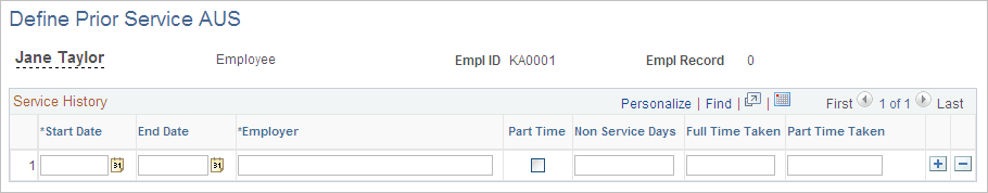

Use the Define Prior Service AUS page (GPAU_LSL_HISTORY) to enter details of periods of service.
Navigation:
This example illustrates the fields and controls on the Define Prior Service AUS page. You can find definitions for the fields and controls later on this page.
Field or Control |
Description |
Start Date and End Date |
Enter the start and end dates of the service period. Note: Enter service periods in any order. The system sorts them from newest to oldest when you save and refresh the page. |
Employer |
This is for information only. It is free-form text box |
Part Time |
Select this check box if the service period is part-time. The Std Hrs/Week field appears, where you can enter the average standard weekly hours for the period. The system uses the values in the calculation of the average weekly hours when determining the payment unit for part-time leave takes. |
Non Srv Days (non service days) |
Enter your manually calculated non-service days. These are the days in the employment period that do not accrue long service leave. Note: The accrual calculation includes any value that you enter here. No validation of rules exist, such as Count only if greater than 30 days in a calendar year. |
F/T Taken (full-time taken) and P/T Taken (part-time taken) |
Enter the duration of the leave take in decimal months (number of days ÷ 30). |

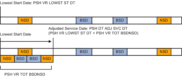

The system adjusts the initial service start date before calculating the duration of the service period upon which the accrual is based. For this adjustment, on-service days and between-service days are totalled then added to the lowest (earliest) start date to reset the lowest start date to a later date.
This diagram shows how non-service days and between-service days are totalled then added to the lowest (earliest) start date to reset the lowest start date to a later date. The variable and date elements are also shown.

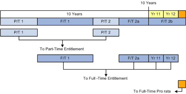

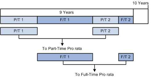

When you run an absence calendar, the system recalculates all of the accrued part-time and full-time pro rata and entitled long service leave. The following two diagrams show the accumulators are increased—at 0.025 per month—for an absence calendar run, after 9 years of service and after 12.5 years of service. Both the _ENT and _BAL accumulators for the four accruals are updated. The accumulators are calendar period based.
This diagram shows updated leave accumulators after 9 years.
This diagram shows updated leave accumulators after 12.5 years.
