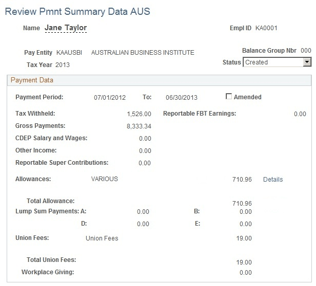

Use the Review Pmnt Summary Data AUS page (GPAU_EE_PSM) to view the results of running the Create Payroll Summary process.

This example illustrates the fields and controls on the Review Pmnt Summary Data AUS page. You can find definitions for the fields and controls later on this page.
After running the Create Payment Summary Data process for the tax year and payee population that you select, you can view the results. The EOY VR CATEGORY Supporting Element Override value that you set for each earning and deduction dictates in which total their values are included. The display is by employee name and ID, pay entity, balance group ID, and tax year.
Field or Control |
Description |
Payment Period |
For normal end-of-tax-year processing, this shows 01/07/YY - 1 to 30/06/YY. For terminated employees, it shows 01/07/YY - 1 to termination date. For hired employees, it shows hire date to 30/06/YY. |
Tax Withheld |
Total of all category T deductions. |
Gross Payments |
Total of all category G earnings. |
CDEP Salary and Wages |
Total of all category C earnings. |
Other Income |
Total of all category O earnings. |
Reportable Super Contributions |
Displays the Reportable Employer Super Contributions (RESC). The system provides two override values for the EOY VR CATEGORY:
Allowances |
Total of all category A earnings. If an employee has one or two allowances, then it is listed here. If there are more than two allowances, it will be listed as VARIOUS and the total of the allowances under this category will be displayed. A Details link is also displayed, which opens a window listing all the allowances. |
Total Allowances |
Total of all allowances. |
Lump Sum Payments (A, B, D and E) |
All earnings of category LA, LB, LD, and LE, respectively. |
Type |
Displays the type of Lump Sum A payment, based on the Action Reason of the termination specified in the Job Data pages. This field does not display a value when the employee has not received any Lump Sum A payments. The system displays the value Rwhen the termination Action Reason is Elimination of Position (redundancy), Partial/Total Disability (invalidity), or Early Retirement. displays the value T for all other reasons. |
Union Fees |
All deductions of category U. If an employee has one or two types of deductions under Union Fees and Professional Association Fees, then it is listed here. If there are more than two deductions, it will be listed as VARIOUS and the total of the deductions under this category will be displayed. A Details link is also displayed, which opens a window listing all the deductions under Union Fees. |
Workplace Giving |
Total of all workplace giving. If the employer had made payments to more than one deductible gift recipient on behalf of the employee, then it will be listed as VARIOUS and the sum of the payments will be displayed. A Details link is also displayed, which opens a window listing all the payments made under Workplace Giving. |
Note: Lump Sum C earnings don't appear, because Lump Sum C ETPs are extracted and reported separately.
When all your data is correct, you can use the Payment Summary/ETP Certs page to print either or both of the two variations of the payment summary and any ETP certificates the system generated during the Create Payment Summary process.
If the payment summary has ‘VARIOUS’ listed against any of the items, an addendum is issued for each item, which details the payments made/amounts withheld during the year.

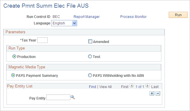

Use the Create Pmnt Summ Elec File AUS page (GPAU_RC_PSM_ELEC) to set the parameters for the generation of the electronic file to the ATO.
Navigation:
Note: After you have generated the payment summary data, you must print the payment summaries before you can create the electronic file for the ATO.
This example illustrates the fields and controls on the Create Pmnt Summ Elec File AUS page. You can find definitions for the fields and controls later on this page.
The ATO requires an electronic file containing all the data that the system has extracted for payment summaries and ETP certificates. You can create a single file for multiple pay entities. The ATO also requires two separate files: one for regular payees and one for contractors who do not have an ABN. The file contains software information, payer information such as ABN and contact details, and payee information such as the tax file number, gross payment, and withheld tax.
The file is created by Application Engine program GPAU_PSM_ELEC. This program uses data extracted by the Application Engine program that created the payment summary.

Run Type
Field or Control |
Description |
Production or Test |
Select Test when preparing a file to send to the ATO for validity testing. Ensure that a test submission can never be mistaken for production data. |
Magnetic Media Type
Field or Control |
Description |
PAYG Payment Summary |
Select to produce a file of data for regular payees. |
PAYG Withholding with No ABN |
Select to produce a file of data for contractor payees who do not have an ABN. |
Pay Entity List
Field or Control |
Description |
Pay Entity |
Select as many pay entities as you want to include in the file. |
