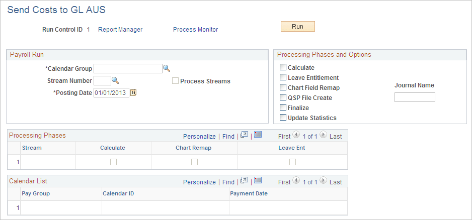

Use the Send Costs to GL AUS page (GPAU_GL_PREPARE) to initiate the processes for calculation of GL data, leave entitlement, QSP flat file creation, finalization of the GLI, and statistical data updating.

This example illustrates the fields and controls on the Send Costs to GL AUS page. You can find definitions for the fields and controls later on this page.
Note: The differences between this page and the page that you access by selecting are the three additional processing phases and options: Chart Field Remap, Leave Entitlement, and QSP File Create.
Processing Phases and Options
Field or Control |
Description |
Chart Field Remap |
Select to enable the ChartField Remap Application Engine process (GPAUS_GL_MAP) when running the General Ledger process. This run control page enables you to run an Application Engine process that updates ChartFields in GP_GL_DATA. The program selects and updates the necessary GP_GL_DATA records with specified ChartField overrides. When you run the GL Interface Finalize process, the data is summarized by using your selected (remapped) ChartFields for correct account mapping. |
Running the ChartField Remapping Process
The ChartField remapping process:
Uses specified ChartField overrides and updates the GP_GL_DATA records.
Enables the GL Interface Finalize process to correctly summarize transactions by using your selected combination of ChartFields, grouping codes, and account values.
You run the new Application Engine process as part of the standard General Ledger Interface process in the following sequence:
Ensure that the GL Calculate phase is complete.
Run the new Application Engine process to perform department remapping.
You run the remap before the leave entitlement process. If you alter the remap, you must always rerun the calculate process. You can't rerun the remap process until you have run the calculation process.
Ensure that the GL Leave Entitlement phase is complete.
Run the GL Finalize process.
Note: This process runs as a separate process and is not integrated into existing Application Engines. In this way, it does not affect the existing GLI.
The Journal Name field is used when you select QSP File Create. The journal name is a user-defined and entered value, which is included in the QSP file header.
