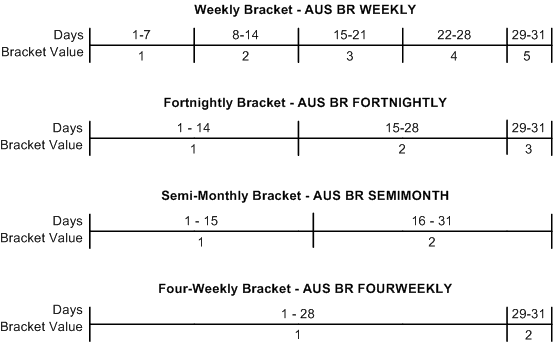

Weekly, fortnightly, semimonthly, and four-weekly brackets return values depending on where the pay period end date occurs.
This diagram shows the bracket values associated with each day of the month.
To provide examples, the following table shows the bracket value that each bracket returns for day 5 and day 27 of the month:

The formula uses the bracket values, which indicate to the system whether the pay period end date is in the relevant period. The formula checks the bracket that corresponds to the frequency type.
