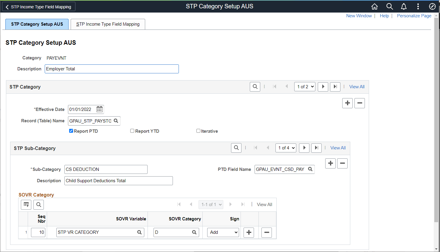

Use the STP Category Setup AUS page (GPAU_STP_CAT) to map between XML Tuple with Category and XML Fact with Sub Category. SOVR Variable determines, the Variable that assigned in the Earnings to determine the SOVR category and the Supplementary Element Override. The setup uses the EOY VR CATEGORY (existing one which is used for generating the Payment Summaries), and STP VR CATEGORY (this is a new variable created to map against respective earnings/deductions) required for STP file generation and reporting.
Navigation:
The STP Category setup AUS page sets the mapping between XML Tuple with Category and XML Fact with Subcategory.
This example illustrates the fields and controls on the STP Category Setup AUS page.
Field or Control |
Description |
Effective Date |
Mapping should be modified to the actual migration date along with the effective date of STP Category setup. Income Type field mapping is mandatory with the latest effective date in the STP Category setup for addition of new income types like CHP and SWP. |
Record (Table) Name |
Select the Staging Record where the data to be stored for reporting while running STP Preparation Process. This field is to define the Staging table record where the data to be stored for final reporting. |
Report PTD |
Select the check box if PTDs are required under the specified Category and Sub-Category. This enables PTD field name where we can define the Field of the staging table defined under Record Name. The PTD value calculated update in the respective field defined. |
Report YTD |
Select the check box if YTDs are required under the specified Category and Sub-Category. This enables YTD field name where we can define the Field of the staging table defined under Record Name. The YTD value calculated update in the respective field defined. |
SOVR Variable |
Select the variable that is assigned in the Earnings. This determine the SOVR category and the Supplementary Element Override. The SOVR Variable are either EOY VR Category or STP VR Category. |
SOVR Category |
Select the respective EOY VR or STP VR Category corresponding to those earnings and deductions that is required for each facts of that Tuple. This determines the actual SOVR categories that contribute to the Sub-Category, which is the Final amount to display in the report. |
Note: This setup is pre-seeded as system data and employer can make necessary changes to set up additional categories as part of STP Reporting.

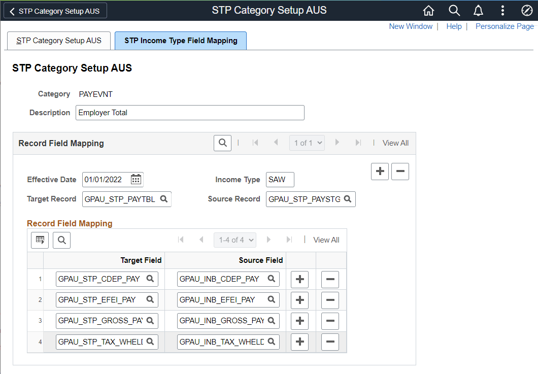

STP Income Type Field Mapping
STP Income Type Field Mapping is to draw between fields for Gross, Tax, CDEP, EFEI between GPAU_STP_PAYSTG and GPAU_STP_PAYTBL to convert payroll data stored in Phase 1 staging record into Phase 2 format of reporting. This transition is from horizontal to vertical data.
In Phase 2, Gross, tax, bonus and commissions, directors’ fee, overtime payments, CDEP, EFEI are still stored in PS_GPAU_STP_PAYSTG but data is converted and stored in PS_GPAU_STP_PAYTBL to make it compatible with the latest format. This conversion is done with the below setup.

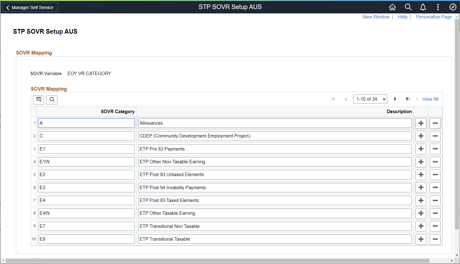

PeopleSoft delivers pre-seeded STP SOVR values that will be displayed in the STP Category Setup AUS page. However, if you want to create a new SOVR value, then you can make use of the GPAU_STP_SOVRCAT component.
Use SOVR Mapping (GPAU_STP_SOVRCAT) page to add SOVR category.
Navigation:
This example illustrates fields and controls of STP SOVR Setup AUS Page.
Use the “+” button to add a new SOVR category.
Map the STP VR CATEGORY “FA” against the respective earning elements with an effective date under the tab Supporting Element Override. Users need to ensure the mapping of the respective SOVR to the correct Earnings and Deductions to report under the correct categories of STP.
Note: Ensure the mapping of the respective SOVR to the correct Earnings and Deductions to report under the correct categories of STP as per ATO definitions.

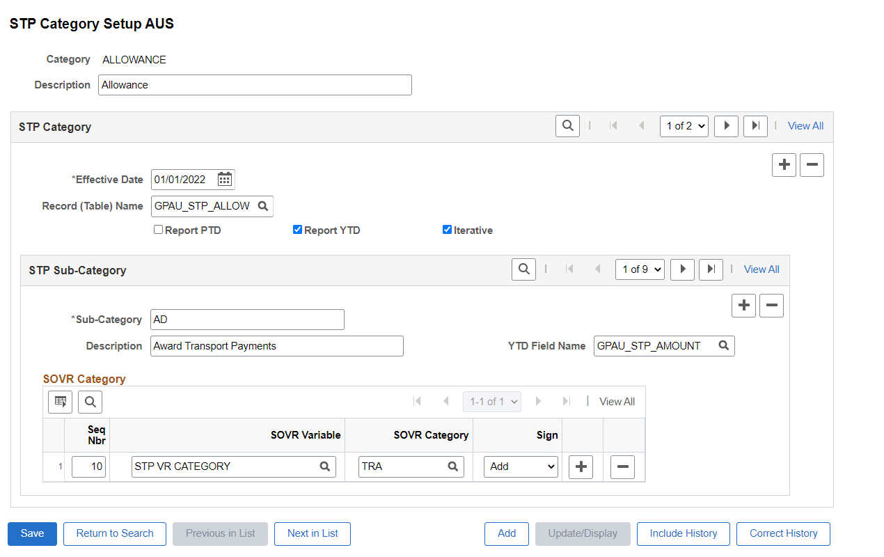

New SOVR Category under the variable STP VR CATEGORY is added in order to classify allowance type as others with description “First Aid Allowance” under STP Category Setup, under Category “Allowance”.
The example illustrates STP Category Setup AUS with Allowance category.
This example illustrates the STP Category Setup AUS page
This example illustrates the XML mapping with the respective fields in the STP Category Setup AUS page.
Field or Control |
Description |
Effective Date |
If the customer plans to migrate to STP Phase 2 anytime later than 01-Jan-2022, effective date of the STP Income Type Field mapping should be modified to the actual migration date along with the effective date of STP Category setup. Income Type field mapping is mandatory with the latest effective date in the STP Category setup for addition of new income types like CHP and SWP. |
Record Name |
Define the Staging table record where the data to be stored for final reporting. |
Report PTD |
This field determines if PTDs are required under the specified Category and Sub-Category. This enables PTD field name where we can define the Field of the staging table defined under Record Name. The PTD value calculated update in the respective field defined. |
SOVR Category |

Field Mapping
The STP Income Type Field Mapping is to draw between fields for Gross, Tax, CDEP, EFEI between GPAU_STP_PAYSTG and GPAU_STP_PAYTBL in order to convert payroll data stored in Phase 1 staging record into Phase 2 format of reporting.
In Phase 2, Gross, Tax, Bonus and Commissions, Directors’ Fee, Overtime payments, CDEP, EFEI are still stored in PS_GPAU_STP_PAYSTG but data is converted and stored in the new record PS_GPAU_STP_PAYTBL to make it compatible with the latest format.

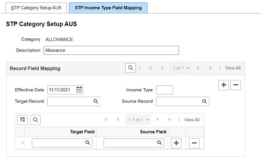

This example illustrates the STP Category Setup AUS page.
Field or Control |
Description |
Target Record |
This field is to define the Staging table record of Phase 2. |
Source Record |
This field is to define the Staging table record of Phase 1. |
Income Type |
This field determines the income type. |
Separate Source Fields are made available for users to capture these other income types as part of the solution. Users will need to appropriately map these Source Fields to the Target Fields.
Note: Users need to do the setup for any non-delivered Income Type using STP Category setup page. In addition, appropriate mapping of Source and Target fields will be required.

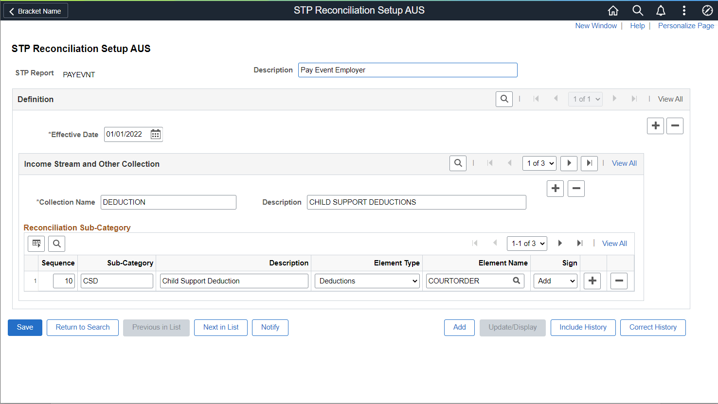

STP Reconciliation Setup AUS is configured with the Earnings/Deductions contributing to the sub-category and the various collections reported in the STP file.
Employee can map any customized Earnings/Deductions used instead of the PeopleSoft delivered Earnings/Deductions that are being reported in STP. This setup is delivered as a system data as part of the Reconciliation solution.
Navigation:
This example illustrates the fields and controls of STP Reconciliation Setup AUS page.
Field or Control |
Description |
Effective Date |
The date from which the setup is valid. |
Collection Name |
The name of the Tuple that are being used for reporting. |
Sequence |
The Sequence Order of the Field on the report. |
Sub-Category |
The name of the facts that are being used for reporting under the respective Tuple. |
Description |
The description of the sub-category. |
Sign |
The values are:
Element Type |
Displays the Element Type. Values can be:
