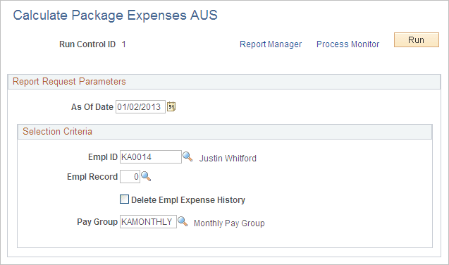

Use the Calculate Package Expenses AUS page (GPAU_RC_SP02) to run the Calculate Package process, which updates the Package Summary page, enabling you to view details of the budgeted, expended, and projected year-to-date totals for the package.
This gives you vital information for observing and addressing spending and overspending trends.
Navigation:
This example illustrates the fields and controls on the Calculate Package Expenses AUS page. You can find definitions for the fields and controls later on this page.
Report Request Parameters
Field or Control |
Description |
As Of Date |
The date on which package expenses are calculated. Note: Align this date with the pay period end date, end of a reporting period, and the end of the FBT or tax year. You should consider these dates when running the process. |
Delete Empl. Expense History (delete employee expense history) |
Select to delete previous expenses on the Package Summary page. |
