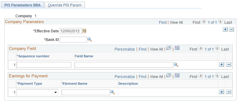

Use the PIS Parameters BRA page (GPBR_PARM_PIS) to define a company's PIS parameters.
Navigation:
This example illustrates the fields and controls on the PIS Parameters BRA page.
Field or Control |
Description |
Bank ID |
Select the Bank ID for CAIXA. |
Company Field
Use these fields to specify additional data that you want to include in the Release of Resources file that is returned to CAIXA. You can select any field from the PS_JOB record, such as EMPLID (employee ID) or DEPTID (department ID). When you update the Release of Resources file, the system will include, for each listed employee, the first ten positions from the combined fields. This data can help you research and verify information in the file.
Earnings for Payment
Use these fields to select the earning element that is used to process each type of PIS payment.
Field or Control |
Description |
Payment Type |
Select the payment type, Income (Rendimento) or Allowance (Abono Salarial). Enter only one row for each payment type. |

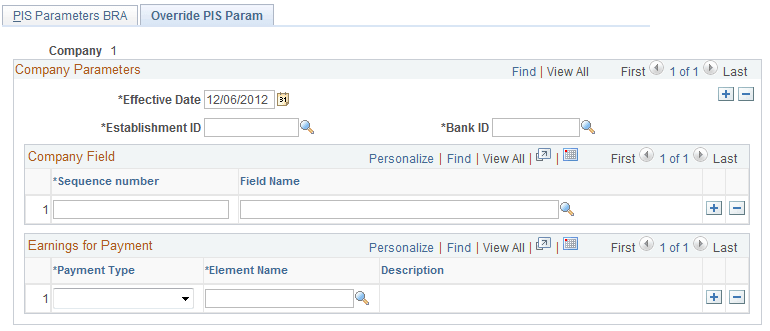

Use the Override PIS Param (override PIS parameters) page (GPBR_PARM_PIS_E) to override a company's PIS parameters for a specific establishment.
Navigation:
This example illustrates the fields and controls on the Override PIS Param page.
Select the establishment to which the override instructions apply. When processing PIS for this establishment, the system will use the instructions entered here rather than the instructions entered for the company on the PIS Parameters BRA page.

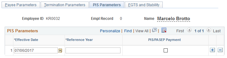

Use the PIS Parameters page (GPBR_PYPIS_PARM) to identify whether a selected payee is entitled to receive PIS payments.
Navigation:
This example illustrates the fields and controls on the PIS Parameters page.
Field or Control |
Description |
Reference Year |
Enter the year to which the PIS payments apply. The reference year must match the effective date. |
PIS/PASEP Payment |
Select if the employee is qualified to receive PIS or PASEP (Public Service Employees Savings Program) payments for the reference year. |

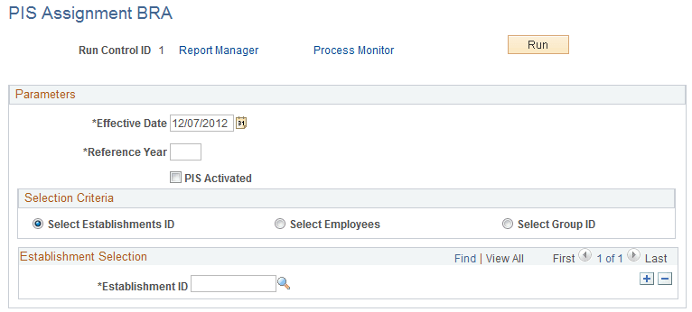

Use the PIS Assignment BRA page (GPBR_RC_PIS) to run the Employee Mark / Unmark for PIS Application Engine process (GPBR_PIS_AE) to identify which payees are entitled to receive PIS payments.
Navigation:
This example illustrates the fields and controls on the PIS Assignment BRA page.
You can use this page to specify that multiple employees are eligible to receive PIS payments for a given year.
Field or Control |
Description |
Reference Year |
PIS Activated |
Select this check box to indicate that the selected employees are eligible for PIS payments for the reference year. |
