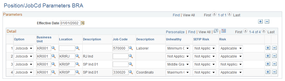

Use the Position/JobCd Parameters BRA (position/job code parameters) page (GPBR_MIXED_PARM) to define unhealthy and hazardous indicators for job codes and positions.
Navigation:
This example illustrates the fields and controls on the Position/JobCd Parameters BRA page.
Field or Control |
Description |
Option |
Select whether you are assigning unhealthy/risk indicators to a Jobcode or a Position. |
Position, Business Unit, Location, and Job Code |
Select the position or job code you are assigning unhealthy/risk indicators to using these fields. |
Unhealthy |
Select the appropriate health risk level for the activities of the job code, position, or location. The system uses this indicator to calculate an earning that compensates for this health risk factor. |
SEFIP Risk |
Select the appropriate risk level for the activities of the job code, position, or location. The system uses this information to generate the SEFIP report and to determine the employee's retirement deduction. |
Risk |
Select the appropriate hazard level for the activities of the job code, position, or location. The system uses this indicator to calculate an earning that compensates for this hazardous factor. |
