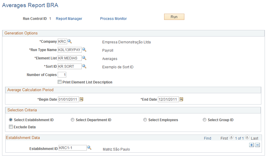

Use the Averages Report BRA page (GPBR_RC_AVG) to report the detailed calculations the system performed to compute the average salary for employees in selected establishments, departments, or groups.
You can also generate the report for selected employees.
Navigation:
This example illustrates the fields and controls on the Averages Report BRA page.
Field or Control |
Description |
Run Type Name |
Select the payroll run type. |
Element List |
You can have the report include information for elements that are used in the averages calculation. Use the Element List BRA component to create an element list. |
Sort ID |
Select a sort ID to specify the order in which information should print on the report. Define sort IDs using the Sort IDs BRA component. |
Print Element List Description |
If you are using an element list, selecting this option causes the system to print the description of the element list on the report. |
Begin Date and End Date |
For all calendars that fall within the dates you enter here, the system will print the elements in the selected element list. |
Selection Criteria |
Choose a method of selecting employees for whom to generate the report. |
Exclude Data |
Select this check box to exclude data that matches the criteria you enter in the Establishment Data, Department Data, or Employee Data group boxes (the group box that appears depends on the selection you make in theSelection Criteria field). |
