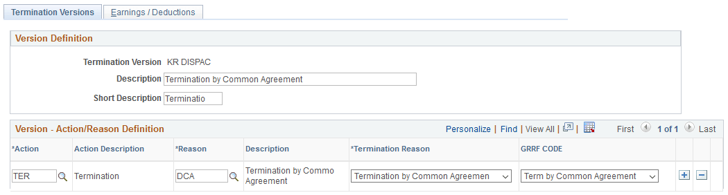

Use the Termination Versions page (GPBR_TERM_ACTN_RSN) to define termination versions and the qualifying actions and reasons for triggering termination pay.
Navigation:
This example illustrates the fields and controls on the Termination Versions page.
Note: (For terminations by common agreement) Global Payroll for Brazil delivers a termination reason (Termination by Common Agreement) and GRRF code (Term by Common Agreement) to support terminations that are mutually agreed by employers and employees.

Version - Action/Reason Definition
Use the fields in the Version - Action/Reason group box to define the termination action/reason combinations that make up the termination version.
Note: A single termination version can consist of many different action/reason combinations—as long as all the combinations trigger the same set of termination earnings or deductions.
Field or Control |
Description |
Action |
Specify the action that triggers termination pay in combination with a specific reason. Values are: COM (Completion) LOF (Layoff) TER (Termination) TWB (Terminated with Benefits) TWP (Terminated with Pay) |
Reason |
Specify the reason that triggers termination pay in combination with a specified action. Values for each action are:
Termination Reason |
Select an applicable termination reason. This information is used in some Brazilian reports (such as GRFC). |
GRRF CODE |
Select a GRRF code for the specified action and reason combination, if applicable. Values are: Contract Termination Mutual Fault/Force Majeure Not Applicable (default) Other Termination Reasons Term Domestic Payee Unfair Term Employer Decision Unfair Term by Common Agreement |

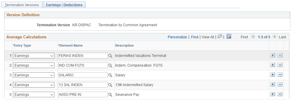

Use the Earnings/Deductions page (GPBR_TERM_VERSION) to associate earnings and deductions with a corresponding termination version.
Navigation:
This example illustrates the fields and controls on the Earnings/Deductions page.
Field or Control |
Description |
Entry Type |
Select whether you are entering an Earnings or a Deduction element. |
Element Name |
Select the element to associate with this termination version. |
