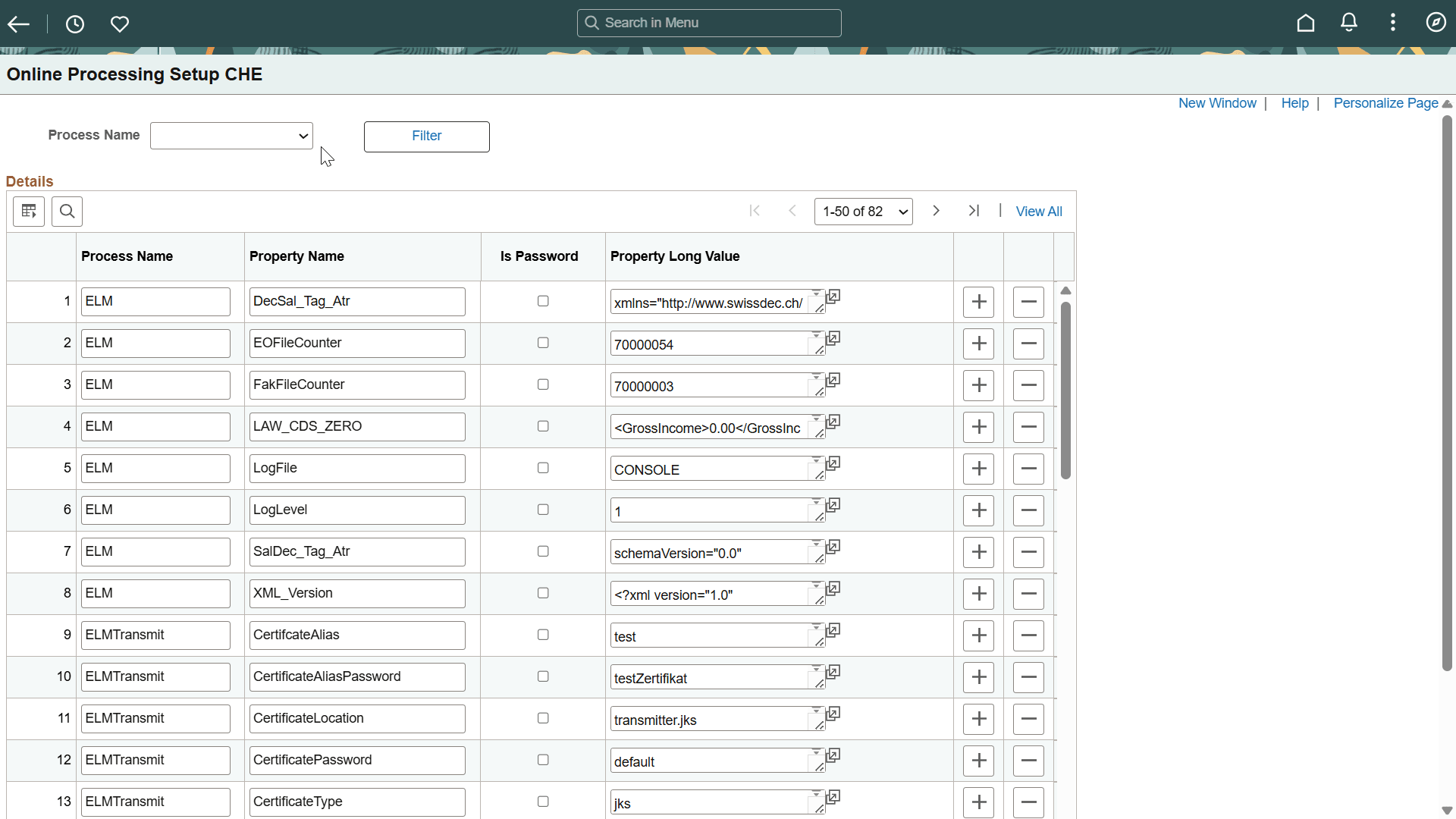

Set Up HCM > Product Related > Global Payroll & Absence Mgmt > Framework > Processing > Online Processing Setup CHE > Online Processing Setup
Online Processing Setup CHE page
Online Process CHE page

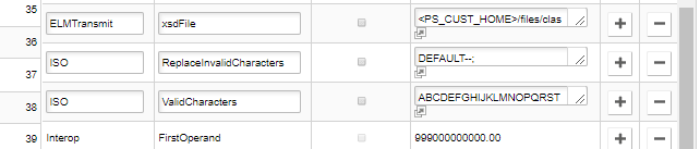

Parameters: ISO
The online processing parameters further support management of invalid characters in ISO 20022 GP Switzerland identifies invalid characters against values given in paremeter ValidCharacters and replaces characters not included by:
  1. If dedicated replace value given in ReplaceInvalidCharacters, by this value
  2. Otherwise, if dedicated value for Default given in ReplaceInvalidCharacters, by this Default replacement
  3. Otherwise, by Default = ‘-‘
This example illustrates the fields and controls on the Online Processing Setup CHE page-1.
Online Processing Setup1
Note: Any character not included in the list given for ValidCharacters gets replaced by default with ‘-‘ (Hyphen). The list of valid characters is delivered by GP Switzerland and gets updated in case ISO requirements will change. In case client prefers a more dedicated replacement he may provide replacement for any invalid character in parameter ReplaceInvalidCharacters.

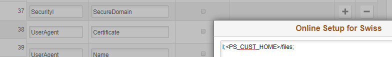

Parameter: SecureDomain
Additional access restrictions for dashboard XML files. This got actually requested for ISO 20022 but supports any dashboard domain.
This example illustrates the Online Setup for Swiss window.
Online Processing Setup2
We provide now customer control on file management. In Online Processing Setup CHE client can qualify a domain for restricted access.
Process Name(proposed) = SecurityX(where X = 1 character translate for provider type)
Property Name (mandatory) = SecureDomain
Property Long Value = X;yyy where
X =one character translate for provider type and
yyy = target path for save
Once the setup is in place the save will directly go the given target and no longer grant access to the end user.

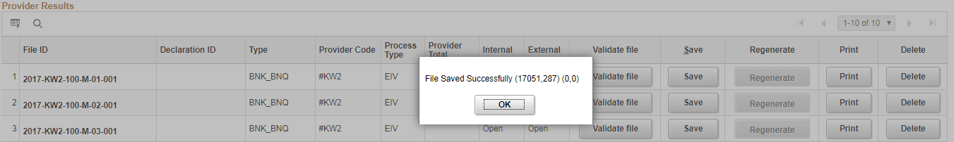

This example illustrates the Save button.
Online Processing Setup3
Click Save
This example illustrates the Confirmation Window.
Online Processing Setup4
