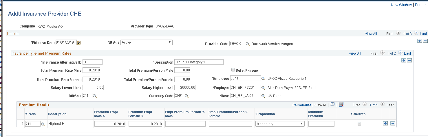

Use the Additional Provider CHE page (GPCH_SI_TYPE) to set up additional insurance packages for an employee.
Navigation:
Addtl Insurance Provider CHE page
Insurance Type and Premium Rates
Field or Control |
Description |
Provider Code |
Provider for this insurance definition. |
Insurance Alternative ID |
Assign any 2 digit code which complies with Swissdec format on insurance codes for KTG_AMC and UVGZ_LAAC ( [A-Z0-9]{2}.) |
Description |
Fill in description of insurance as of Swissdec insurance profile. |
Default Group |
If default is checked, this insurance applies for all employees, which are not explicitly exempted from this group. |
Total Premium Rate Male, Total Premium/Person Male, Total Premium Rate Female, and Total Premium/Person Female |
Enter these values as specified by the insurance provider. |
Salary Lower Limit and Salary Higher Level |
Enter the limits to entitlement for this type of insurance. |
Employee and Employer |
Enter the earning or deduction code for each. |
BASE |
Enter base earning for this insurance. |
DflSplit |
Enter default Grade for split, in case there are no dedicated splits per salary grade. |
Currency |
Fix CHF |
Element Name |
Accumulator which serves as base for this insurance. |
Premium Details
Field or Control |
Description |
Premium Empl(oyee) Male %, Premium Empl(oyee) Female %, EE Premium/Person % Male, and EE Premium/Person % Female |
Enter employee percent of contribution. For example, if full rate is 1% and it is paid half by employer and half by employee, then enter 0.5%. |
Proposition |
Select how the insurance should be generated. Valid values are Automatically and Mandatory. |
Minimum Premium |
Enter the value specified by the insurance provider. |
Calculate |
Select to have Global Payroll for Switzerland process the insurance. If the insurance information is for information only, deselect the check box. |

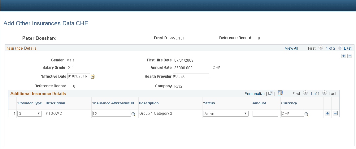

Use the Additional Insurance Data page (GPCH_SI_VARIANT) to enter additional insurance data for an employee.
Navigation:
Field or Control |
Description |
Annual Rate |
Displays the annual rate that applies to an employee. |
Provider Type |
Select the provider type. Valid values are 3 = KTG_AMC and2 = UVGZ_LAAC. |
Prompts for values from setup. |
