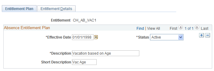

Use the Entitlement Plan page (GPCH_AB_ENTITLEMNT) to assign a description to the absence entitlement plan.
Navigation:
Field or Control |
Description |
Description and Short Description |
Enter both a long description and a short description for the absence entitlement plan that you are setting up. The system uses the entries on this page to display the name of plan on other pages. |

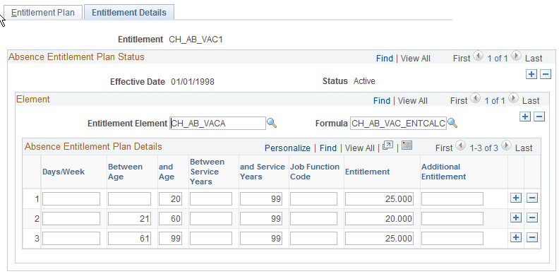

Use the Entitlement Details page (GPCH_AB_ENTITLEDE) to specify the number of vacation days to be awarded to employees based on age, length of service, or other entitlement.
Navigation:
Element
Field or Control |
Description |
Entitlement |
Select the entitlement to assign to your entitlement plan. |
Formula |
Select the formula to assign to your entitlement plan. |
Absence Entitlement Plan Details
Field or Control |
Description |
Days/Week |
If entitlements in your plan vary according to the number of weekly workdays, enter the number of workdays for which an employee is eligible. |
Between Age and and Age |
If entitlements in your plan vary according to age, enter the range in which an employee is eligible. |
Between Service Years and and Service Years |
If entitlements in your plan vary according to length of service, enter the minimum and maximum number of years of service required for this entitlement. |
Job Function Code |
Enter a department code to specify the vacation entitlement for a specific department. |
Entitlement |
Enter the number of days to which the employee is entitled. |
Additional Entitlement |
Enter details of any other entitlement for which the employee is eligible. |
