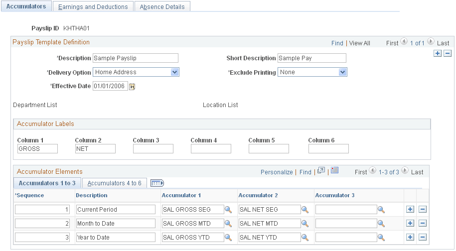

Use the Templates THA - Accumulators page (GPTH_PSLP) to set up delivery and print exclusion options, column headings (labels), and column contents (rows of accumulators).
Navigation:
This example illustrates the fields and controls on the Templates THA - Accumulators page.
Note: Select the tabs in the Accumulator Elements scroll area to access additional views of this page. Fields that are common to all views are documented first.

Payslip Template Definition
Field or Control |
Description |
Delivery Option |
Determines where the hardcopy payslips are sent. Select from a list of internal type addresses, such as department or location, or external addresses, such as home address or mail address, which are recorded in the payee's personal data record. Use the Payee Payslip Overrides page to override the delivery destination of the printed payslip from the default delivery option that you select here. The Payee Payslip Overrides page is effective-dated to enable you to override the delivery option for a period of time. |
Exclude Printing |
Select Location or Department to exclude the printing of specific departments or locations on your payslips. The corresponding links then become available and enable you to select the specific departments or locations that you don't want to display on the payslips during the print process. You can select multiple locations or departments. If you want to print a location or department that you previously excluded, you can override this on the Create/Print Payslips THA page before you run the print process. Note: If you enter a pay entity as the reprint option on the Create/Print Payslips THA page and you exclude a location that is part of that pay entity, it is not printed. |
Accumulator Labels
Enter the column heading labels for the accumulators that appear across the page on the printed payslip.
Accumulator 1 to 3 tab
Access the Accumulators 1 to 3 tab.
Field or Control |
Description |
Sequence |
Enter a sequence number to set the order in which the accumulators appear. They appear in ascending order. |
Description |
Enter a description of each accumulator row. |
Accumulator 1,Accumulator 2, and Accumulator 3 |
Select the accumulators to display for the corresponding column. Accumulator 1 values appear under the column 1 label, accumulator 2 values appear under the column 2 label, and so on. For example, you might have already have entered a description of sequence 1 and 2 as current and year to date. If you also want to display quarter-to-date accumulated amounts, you must create a new row, give the new row the description value of QTD, and select the accumulators that correspond to the column headings (labels). |
Accumulators 4 to 6 Tab
Access the Accumulators 4 to 6 tab.
Set up accumulators 4 to 6 on this tab. This is the same as the Accumulators 1 to 3 tab, except that it does not have sequence or description fields because the same sequence number and description apply to all six accumulators in the row.

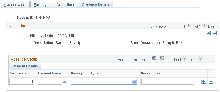

Use the Templates THA - Absence Details page (GPTH_PSLP2) to add absence entitlements and absence pro rata elements. The payslip displays the current balance of the entitlement or pro rata.
Navigation:
This example illustrates the fields and controls on the Templates THA -Absence Details page.
Select the absence elements to display in the absence section of the payslip and the sequence in which these elements appear.
Use this page the same way that you use the Earnings and Deductions page. Enter a sequence number and an element name, and select one of three description types.
