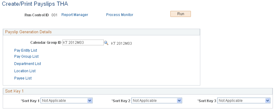

Use the Create/Print Payslips THA page (GPTH_RUNCTL_PSLP) to generate the payslip.
Navigation:
This example illustrates the fields and controls on the Create/Print Payslips THA page.
Field or Control |
Description |
Calendar Group ID |
Select the calendar group that you want to process. |
Pay Entity List |
Click to select one or more pay entities for processing. The system displays the Pay Entity List page. |
Pay Group List |
Click to select one or more pay groups for processing. The system displays the Pay Group List page. |
Department List |
Click to select one or more departments for processing. The system displays the Department List page. |
Location List |
Click to select one or more locations for processing. The system displays the Location List page. |
Payee List |
Click to select one or more payees for processing. The system displays the Payee List page. |
Sort Key 1,Sort Key 2, andSort Key 3 |
You can set up to three sort keys from the following options: Department, Employee Name, Location, Not Applicable, Pay Entity, or Pay Group. If you select Not Applicable, the program prints payslips by employee ID. |
