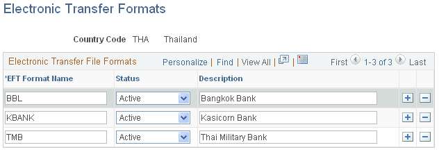

Use the Electronic Transfer Formats page (EFT_NAME) to define the EFT file that complies with the file formats used to transfer funds between banks.
Navigation:
This example illustrates the fields and controls on the Electronic Transfer Formats page.
Note: The Electronic Transfer Formats page is also discussed in the PeopleSoft HCM Application Fundamentals documentation. Additional information for Global Payroll Thailand is provided here.
Oracle currently delivers some electronic transfer formats (EFTs) preconfigured for Global Payroll Thailand.
The banks for which Oracle delivers preconfigured EFT formats are:
BBL (Bangkok Bank)
KBANK (Kasicom Bank)
TMB (Thai Military Bank)
You should not modify the EFT formats that Oracle delivers preconfigured for PeopleSoft Global Payroll for Thailand. However, you can create other EFT formats and update the Create Payment EFT File Application Engine program (GPTH_EFT) appropriately so that the formats will meet other bank requirements.

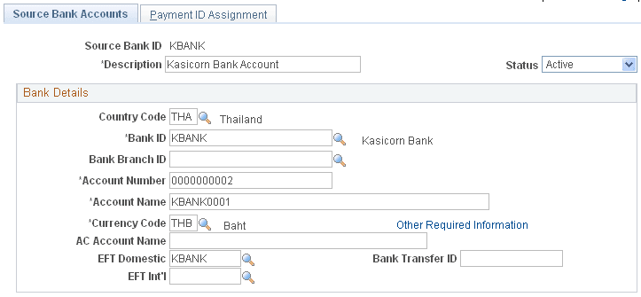

Use the Source Bank Accounts page (SRC_BANK) to assign a source bank ID and define information about the banks that pay out money.
Navigation:
This example illustrates the fields and controls on the Source Bank Accounts page.
Note: The Source Bank Accounts page is also discussed in your PeopleSoft HCM Application Fundamentals product documentation. Additional information for Global Payroll Thailand is provided here.
Field or Control |
Description |
EFT Domestic |
Enter the EFT format name for the bank from which your company will send payroll funds. You must enter a valid EFT format value to save the page. |
Other Required Information |
This link appears only if the EFT Domestic bank requires additional information. Select the link to enter or update additional information required by the specific bank. The EFT DomesticIDs for which additional information is supported in Global Payroll for Thailand, are:

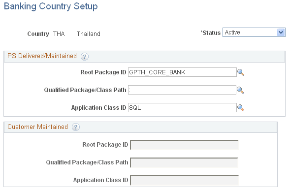

Use the Banking Country Setup page (GP_APP_PKG_SETUP) to verify the root package and application class for Thailand.
Navigation:
This example illustrates the fields and controls on the Banking Country Setup page.
Note: The Banking Country Setup page is also discussed in your PeopleSoft HCM Application Fundamentals product documentation. Additional information for Global Payroll Thailand is provided here.
For Thailand, verify that Root Package ID = GPTH_CORE_BANK and Application Class ID = SQL.
