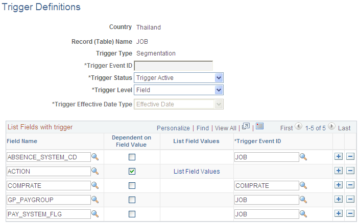

Use the Trigger Definitions page (GP_TRGR_SETUP) to define iterative, segmentation, and retroactive triggers.
To create a retroactive or segmentation trigger, first define the appropriate event ID on the Retro Event Definition page or Segmentation Event Definition page.
Navigation:
This example illustrates the fields and controls on the Trigger Definitions page.

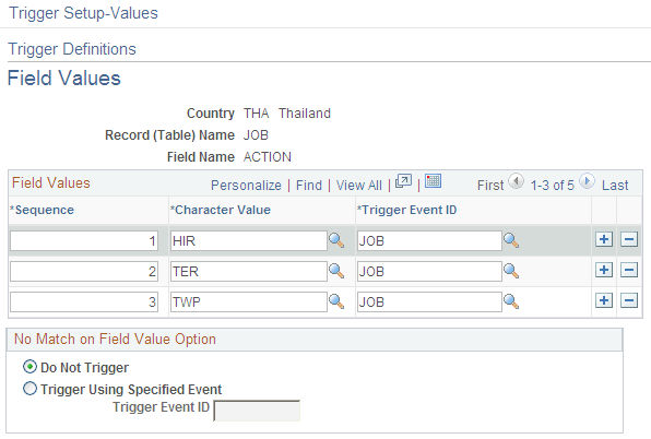

Use the Trigger Definitions - Field Values page (GP_TRGR_SETUP_SEC) to Indicate which field values initiate actions.
Navigation:
Click the List Field Values link on the Trigger Definitions page.
This example illustrates the fields and controls on the Trigger Definitions - Field Values page.
To add period segmentation for termination with pay, you need to define the trigger. The action TERMINATION is added to the THA trigger definitions so that is a payee is terminated within a period, the trigger occurs.
For example: If a payee with a basic salary of 95,000 THB is terminated on April 10, the payee will receive a salary amount calculated as follows: 9/30 * 95,000 = 28,500. The payroll process does not handle the remainder of the period from April 10 through April 30.
If you do not want the trigger to occur, you can delete the definition from the trigger definitions. You may also need to delete any generated triggers on the Review Triggers - Segmentation page
