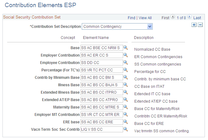

Use the Contribution Elements ESP page (GPES_SS_CNTB_BSE) to obtain information about key elements used in the social security process.
Navigation:
This example illustrates the fields and controls on the Contribution Elements ESP page. You can find definitions for the fields and controls later on this page.
Field or Control |
Description |
Base |
Displays the accumulator that stores the funding base used in the social security calculation. |
Employer Contribution |
The accumulator that stores the employer's contribution to social security. |
Employee Contribution |
The accumulator that stores the employee's contribution to social security. |
Percentage (For TC's) |
The variable that stores the total contribution percentages (employee plus employer percent) that must be recorded in the TC reports. |
Contrib by Minimum Base (contribution by minimum base) |
The accumulator that stores the contribution base corresponding to the period that contributes by minimum base. |
Illness Base |
The accumulator that stores the contribution base corresponding to sick days. |
Extended Illness Base |
The accumulator that stores the contribution base corresponding to the period affected by extended illness absence. |
Extended AT/EP Base |
The accumulator that stores the contribution base corresponding to the period affected by extended AT/EP absence. |
Maternity Base |
The accumulator that stores the employee's maternity base. |
Employer MT Contribution (employer maternity contribution) |
The variable that stores the employer's contribution for maternity or pregnancy risk benefits. |
ERE Base |
The accumulator that stores the contribution base corresponding to the period affected by ERE. |
Vac. Trmntn. Soc. Sec. Contrib (vacation termination social security contribution) |
The deduction that stores the contributions related to paid vacations for terminated employees. |

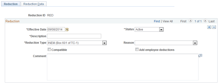

Use the Reduction page (GPES_SS_BNF) to view and define the employer's social security reductions.
Navigation:
This example illustrates the fields and controls on the Reduction page. You can find definitions for the fields and controls later on this page.
Field or Control |
Description |
Reduction ID |
The reduction ID identifies the specific reduction rule that applies to an employee. When accessing this page, select an ID and view (or modify) the existing data, or enter a new ID and define the reduction associated with that ID. |
Compatible |
Select to designate the reduction as compatible with any other reductions assigned to a payee (concurrent reductions). The system calculates and applies all compatible reductions for a payee. If you deselect the check box, the system considers the reduction incompatible. The system calculates all incompatible reductions assigned to a payee, but applies only the one that is most beneficial to the employer. If a payee has both compatible and incompatible reductions, the system applies all compatible reductions, but applies only the incompatible reduction that is most beneficial to the employer. |
Reduction Type |
The reduction type identifies the categorization for a specific social security reduction to be applied to an employee. Possible values are:
Note: The reduction types INEM (Box 601 of TC-1) Catastrophe, INEM 60 Years Old and Research Staff are currently inactive. |
Reason |
Enter the reason for the reduction. This field is available only if you select reduction type INEM (Box 601 of TC-1). Employers are entitled to a reduction if they hire unemployed people with unlimited contracts before December 31st, 2009. In this situation, in addition to entering a value in the Reason field, you need to enter the remaining unemployment benefit by overriding the variable SS VR UNEMP BNFT for the hiring month. |
Group |
Specify the collective to which the reduction applies. The system displays this field only if you select reduction type RD 5/2006 or SS (box 209 of TC-1) or SS Flat Amount. |
Add employee deductions |
Select this check box to identify a reduction that applies to both and employer and employee contributions. This only applies to reductions defined as percentage. |

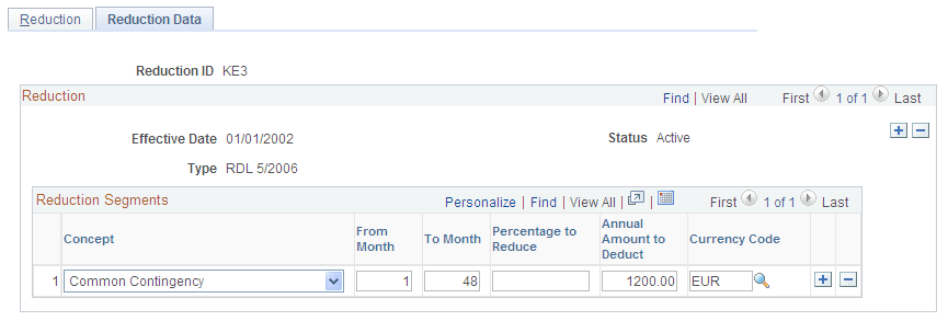

Use the Reduction Data page (GPES_SS_BNF_DTA) to view and define the employer's social security reduction data.
Navigation:
This example illustrates the fields and controls on the Reduction Data page. You can find definitions for the fields and controls later on this page.
Field or Control |
Description |
Concept |
Identify the type of contribution (common contingency, FOGASA, temporary disability, and so on) to which the reduction defined in the Reduction Percentage , From Month, and To Month fields applies (see the following description). |
From Month and To Month |
Define a reduction with a limited duration. Use the From Month field to identify the first month of the reduction; use the To Month field to identify the last month of the reduction. The actual calendar month on which the reduction begins or ends is based on the contract begin date identified on the Contract Data page in PeopleSoft HR. For example, in the preceding example, the value of the From Month field is 1 and the value of the To Month field is 999. This means that beginning with the month of the initial contract (for example, 1/1/1990), the reduction applies for 999 months. If the start date had been 4 and the To Month date had been 6, the reduction would not begin until April (three months after the contract begin date) and would end after the month of June (five months after the month that the contract started). If you enter 1 in the From Month field and 999 in the To Month field, the system assumes that the duration of the contract is unlimited. Note: Do not use 0 as the From Month value. Instead use 1. |
Percentage to Reduce |
View, modify, or define the percentage amount of the reduction that applies to the contribution type identified in the Concept field. |
Annual Amount to Deduct |
View, modify, or define the exact flat amount of the reduction that applies to the contribution type identified in the Concept field. For monthly employees, the system divides this annual rate by 360 and multiplies the resulting value by the contributed days on the payroll. For daily employees, the system divides the annual rate by the annual calendar days and then multiplies the resulting value by the contributed days on the payroll. For part-time employees, the system reduces the reduction amount based on the FTE value assigned to the employee. The FTE field value represents the reduction of the work schedule. |

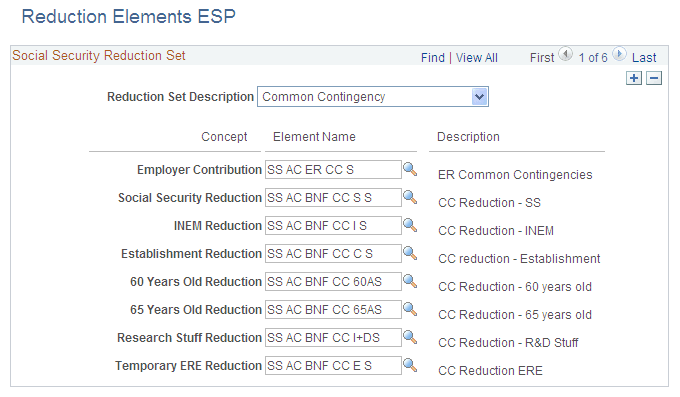

Use the Reduction Elements page (GPES_SS_BNF_DEF) to obtain information about key accumulators used in the social security reduction process.
Navigation:
This example illustrates the fields and controls on the Reduction Elements ESP page. You can find definitions for the fields and controls later on this page.
Field or Control |
Description |
The accumulator that stores the amount of the employer's contribution to social security for each contribution type, common contingency, permanent disability D & S, professional training, and FOGASA. To calculate the employer reductions, PeopleSoft Global Payroll for Spain applies the reduction percentages defined on the Reduction Data page to the amount in this accumulator. |
Social Security Reduction |
The accumulator that stores the employer reductions that are managed by social security for each contribution type (common contingency, permanent disability D & S, professional training, and FOGASA). |
INEM Reduction |
The accumulator that stores the employer reductions managed by INEM for each contribution type (common contingency, permanent disability D & S, professional training, and FOGASA). |
Establishment Reduction |
The accumulator that stores the employer reductions managed by INEM in case a catastrophe occurs to a company establishment. |
60 Years Old Reduction |
The accumulator that stores the employer reductions for employees older than 60. |
65 Years Old Reduction |
The accumulator that stores the employer reductions for employees older than 65. |
Research Stuff Reduction |
The accumulator that stores the employer reductions for employees that are categorized as research staff (personal investigador). |
Temporary ERE Reduction |
The accumulator that stores the employer reductions for employees affected by temporary ERE. |
