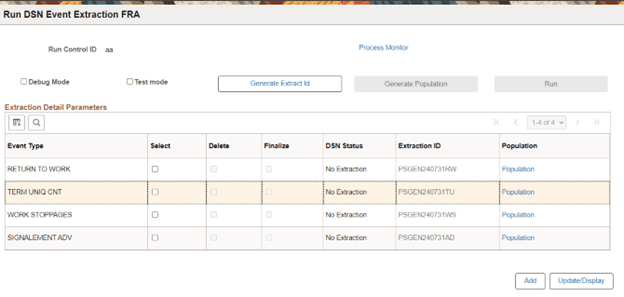

Use the Run DSN Event Extraction FRA page (GPFR_DSN_EVT_RUN) to run the DSN event process.
Navigation:
This example illustrates the fields and controls on the Run DSN Event Extraction FRA page. You can find definitions for the fields and controls later on this page.

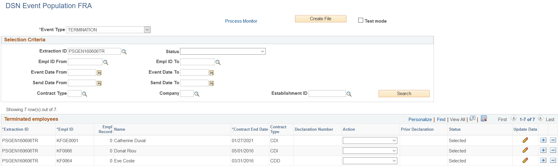

Click the Population link to access the DSN Event Population page.
This example illustrates the DSN Event Population page for Termination reporting. You can find definitions for the fields and controls later on this page.

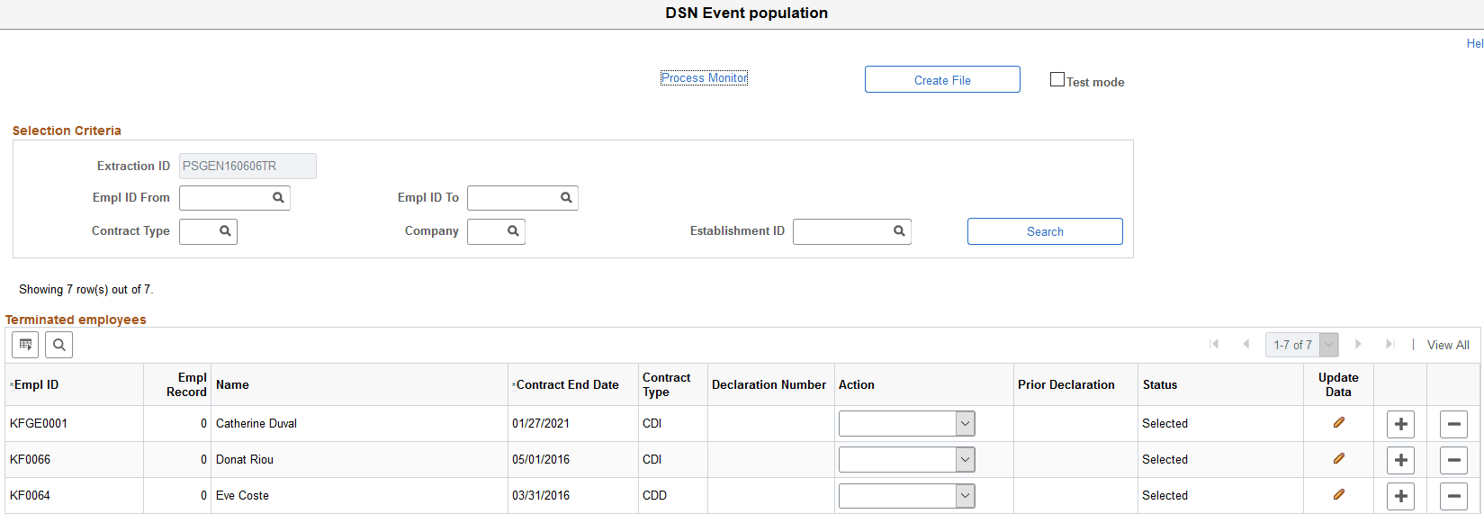

Use the DSN Event Population FRA page (GPFR_DSN_EVT_EE) to manage the employee population for DSN Event reporting without accessing the component Run DSN Event FRA which the user could not have access to.
Note: You need to run the extraction process even if the employee events are entered manually.
Navigation:
This example illustrates the fields and controls on the DSN Event Population FRA page.

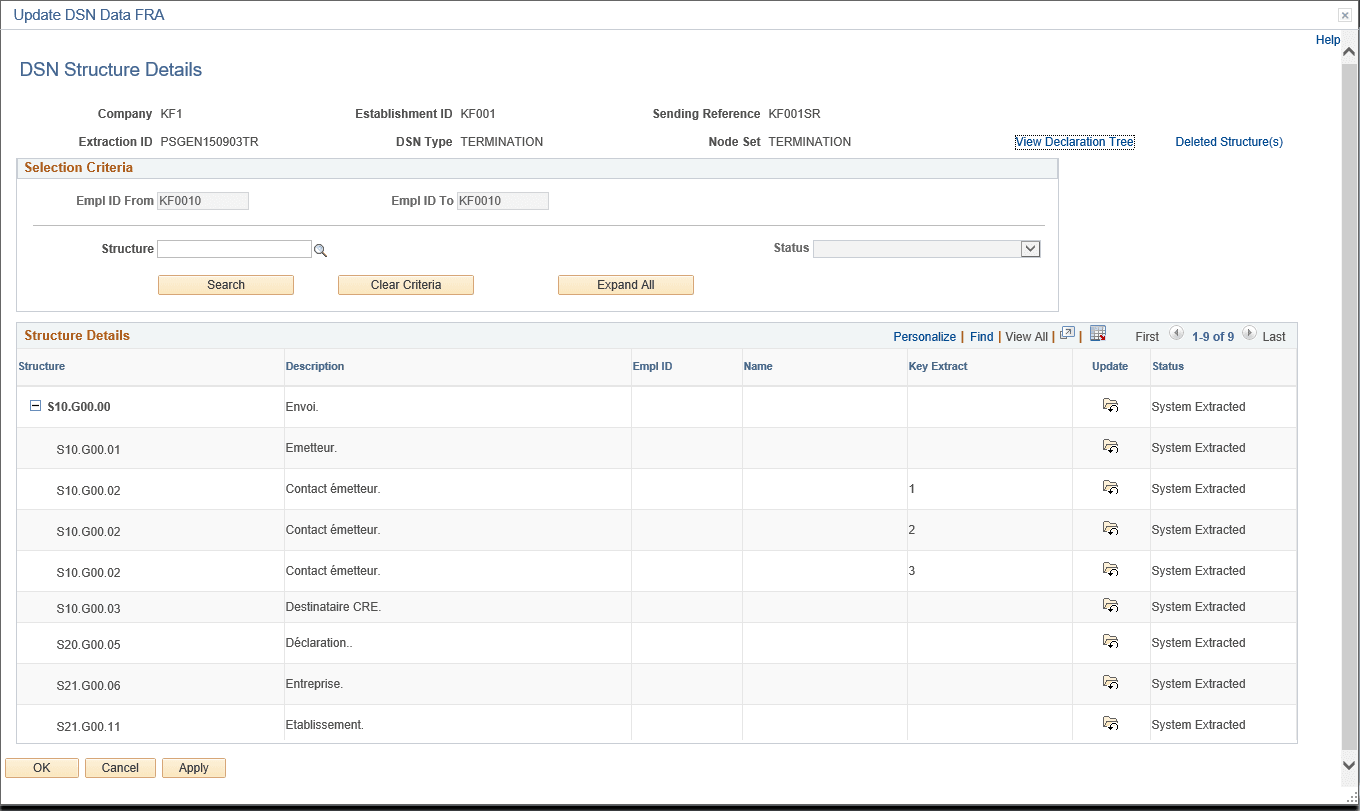

Update DSN Data France Modal
Use the Update DSN Data France modal window to update the DSN event. The Update DSN Data link is enabled only when the extraction process is properly executed, else the link is disabled. It is possible to change the employee range in DSN Structure Details.
Navigation:
Click the link corresponding to the Update Data field.
This example illustrates the Update DSN Data FRA modal window.
