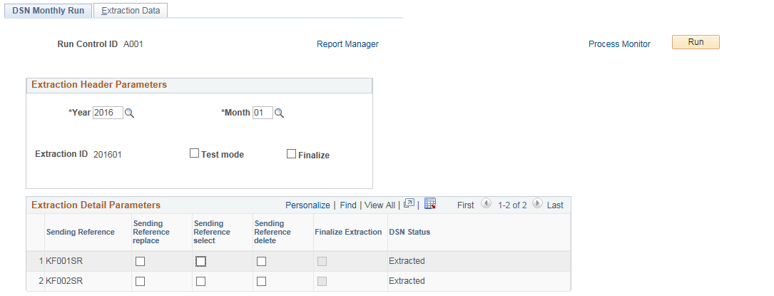

Use the DSN Monthly Run page (GPFR_DSN_MT_RUN) to select the sending reference(s) and other extraction parameters.

This example illustrates the fields and controls on the DSN Monthly Run page. You can find definitions for the fields and controls later on this page.
Note: Extraction ID is automatically created based on the selection of the fields Year and Month. This page should be saved before going to the Extraction Data page.
Extraction Header Parameters
Field or Control |
Description |
Year |
Select the year for which DSN declaration is made. |
Finalize |
Select the check box when you are ready to finalize the run. Once you finalize the run, no more extractions are possible for the period. |
Extraction Detail Parameters
Field or Control |
Description |
Sending Reference replace |
Select the checkbox if you are replacing an already extract file with a new one based on new information. |
Sending Reference select |
Select the checkbox if you want the Company/Establishments configured as part of the Sending Reference to be extracted in the file. |
Sending Reference delete |
Select this checkbox if you want to delete the extract Sending Reference from the file. |

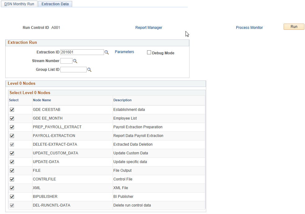

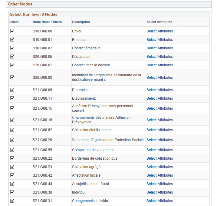

Use the Extraction Data page (GPFR_AF_EXTR_RUN) to select/de-select nodes attributes and change parameters. All the nodes for the monthly type DSN will be populated in the Extraction Data page. You can select the nodes that needs to be present in the extracted file.

This example illustrates the fields and controls on the Extraction Data page (1 of 3). You can find definitions for the fields and controls later on this page.

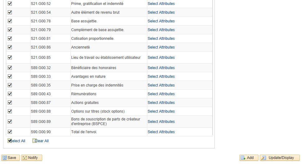

This example illustrates the fields and controls on the Extraction Data page (2 of 3).
This example illustrates the fields and controls on the Extraction Data page (3 of 3).
Field or Control |
Description |
Extraction ID |
The Extraction ID will be automatically populated based on the Year and Month field selected on the page DSN Extraction Run. The parameters of which can be changed using Parameters link next to it. |
Parameters |
The parameters can be changed by clicking on the Parameters link. You can also select the applicable DSN version here. |
Debug Mode |
Select to generate a log file with the extraction run. |
Stream Number |
Use this option when you want to generate for a selective list of employees. Each stream number specifies a range of employees. During DSN data extraction run, if stream number is set as parameter, system extracts the data only for the range of employees specified under the selected stream number. |
Group List ID |
Use this option when you want to generate for a selective list of employees. During DSN data extraction run, if group list is set as parameter, system extracts the data only for the employees specified under the selected Group List ID. |
