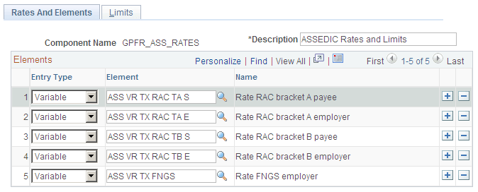

Use the Rates And Elements page (GPFR_RATE_PANELS) to view the variables containing the rates for the different types of contributions, such as ARRCO or AGIRC.
The data on the Rates and Elements page is delivered by PeopleSoft but is not maintained by PeopleSoft.

This example illustrates the fields and controls on the Rates And Elements page. You can find definitions for the fields and controls later on this page.
Field or Control |
Description |
Component Name |
Displays the name of the component that contains the variables. |
Elements
Field or Control |
Description |
Entry Type |
Select the entry type: Accumulatr (accumulator), Deduction, Section, and Variable. |
Element Name |
Displays the names of the variables containing the rates for the different types of contributions, such as ARRCO or AGIRC. Variable names are coded according to the contribution type. For example, ARC VR TX T1 NC S is the variable that contains the value of the ARRCO contribution rate for a payee on earning base T1. |

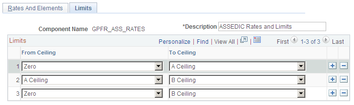

Use the Limits page (GPFR_LIM_PANELS) to view the limits or ceilings associated with the rate variables displayed on the Rates and Elements page.
The values on the Limits page are delivered by PeopleSoft but not maintained by PeopleSoft. You can change the ceilings for a variable here.

This example illustrates the fields and controls on the Limits page. You can find definitions for the fields and controls later on this page.
Field or Control |
Description |
Component Name |
Limits
Field or Control |
Description |
From Ceiling |
Select the minimum salary base for the set of limits that you are defining. |
To Ceiling |
Select the maximum salary base for the set of limits that you are defining. |

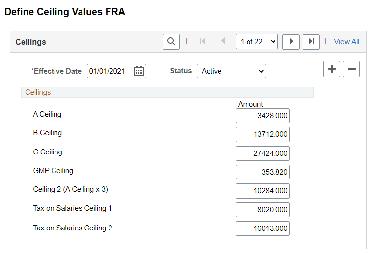

Use the Define Ceiling Values FRA page (GPFR_CEILINGS) to view the different ceiling values used to calculate the funding bases for the URSSAF, ASSEDIC, AGIRC/ARRCO, and contingency funds contributions.
You can change the values of the ceilings here to comply with changing laws.

This example illustrates the fields and controls on the Define Ceiling Values FRA page. You can find definitions for the fields and controls later on this page.
The ceiling name appears in the column on the left. The current monetary values of each ceiling appear in the Amount column. The amounts for the ceilings are monthly amounts in euros.
