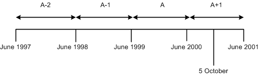

Accumulation Periods for Paid Vacation (CPE CG PAYES)
| Period | Period Name | Comments |
| Current reference period | A+1 | Current period of accumulation. |
| Current period (for taking vacation). | A | Entitlement calculated in A+1 is transferred to A each 31 May or 1 June. |
| The period before the previous period. | A-1 | The balance for the current period is transferred to A-1 each 31 May or 1 June. |
| The period before A-1. | A-2 | The balance for A-1 is transferred to A-2 each 31 May or 1 June. |
Example: Assume today is 5 October 2000. If the reference period is 1 June to 31 May, then the relevant accumulation periods appear in the following diagram:
Global Payroll for France tracks four totals for each accumulation period: entitlement earned, entitlement balance, take, and adjustments. For each, the accumulation period is set to Year To Date. By default, the Begin Option date is 1 June, meaning that the accumulation period runs from 1 June to 31 May of the following year.
