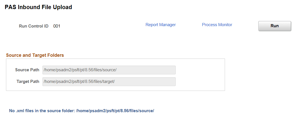

Use the PAS Inbound File Upload page (GPFR_PAS_RATE_LOAD) to upload the inbound DSN file to PeopleSoft. The inbound file should be in xml format.
Navigation:
This example illustrates the PAS Inbound File Upload Page.
The source and target path are defined under DSN Application Parameter.
It is in the source path where the user stores the file when they receive it from authorities and target path is where the system saves the file after it reads and puts the data into the record.

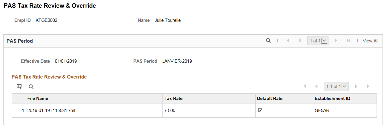

Once the PAS Inbound File Upload process is complete, use the PAS Tax Rate Review & Override page ( GPFR_PAS_RV_TAX_RT ) to review the received PAS tax rate for each employee.
Navigation:
This example illustrates the PAS Tax Rate Review & Override Page.
For some employees, there can be multiple tax rates available for the same period. In such scenario, the PAS Tax Rate Review & Override page lists the rates in multiple rows. If there are more than one rate received for an employee for the same period, by default, system selects the first one in the file. You can select the other rate if required.
Once you save the file, the tax rate will be stored employee wise.

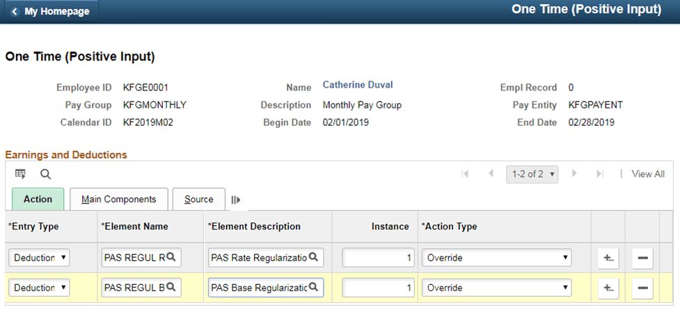

Use the One Time (Positive Input) Page to regularize base and/or rate value for any of the previously processed period.
This example illustrates the One Time (Positive Input) Page.
If the rate needs to be corrected (regularized), select the deduction element as PAS REGUL RT. If the Base needs to be corrected (regularized), select the deduction element as PAS REGUL BS.

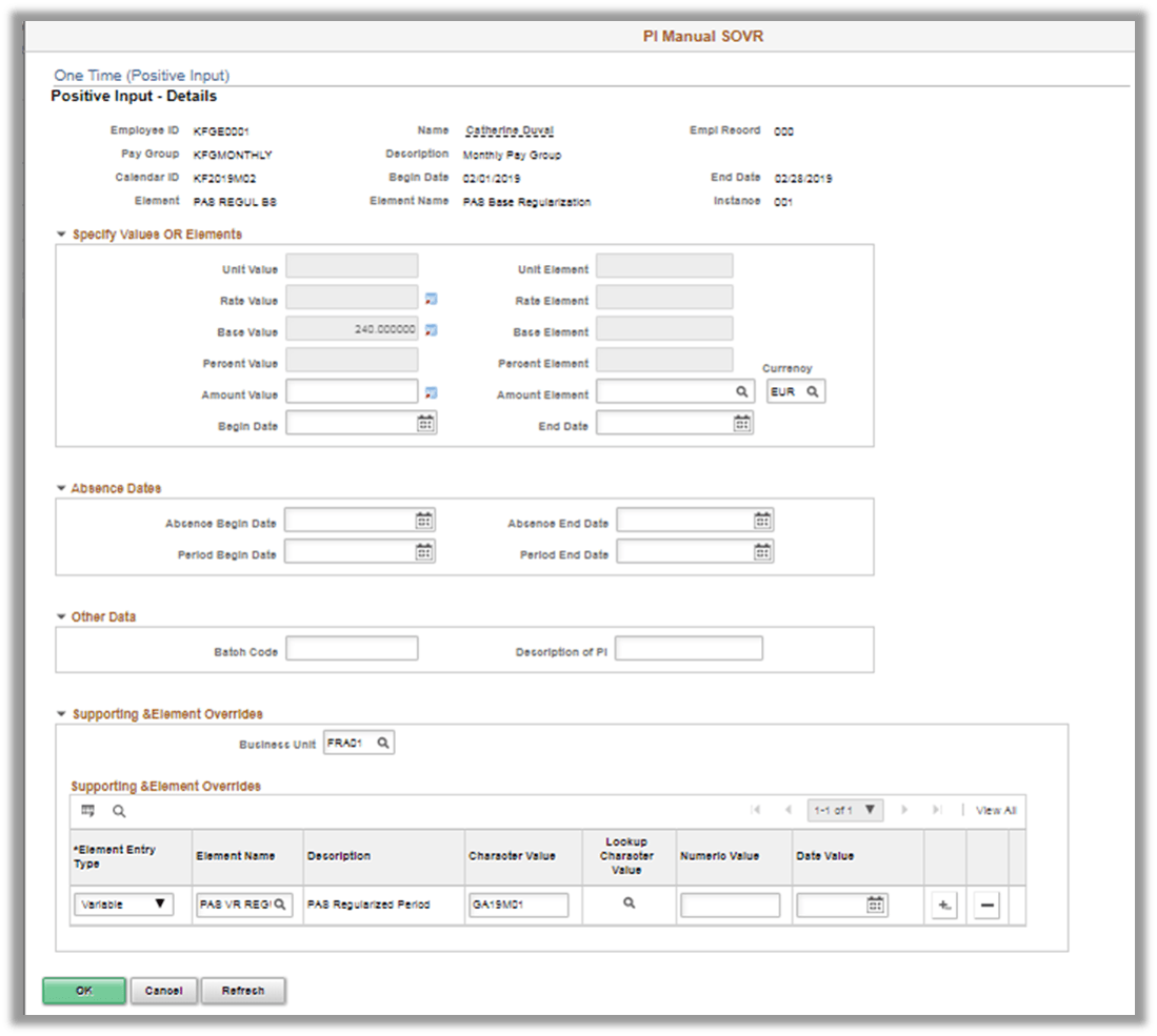

Use the Positive Input - Details page (GP_PI_MNL_SEC) to enter regularized Base and Rate values. For PAS REGUL BS, enter the base value and for PAS REGUL RT, enter the rate value.
Note: Ensure that you enter only a delta value.
This example illustrates the Positive Input - Details Page.
In the Supporting & Element Overrides section, select the period corresponding to the variable, PAS VR REGUL RATE, in which the base and/or rate value of the PAS deduction needs to be corrected.
During the current period payroll run, after deducting the PAS for the current period, system calculates the regularized deduction ( PAS REGUL BS and PAS REGUL RT) for the specified period (PAS VR REGUL RATE) based on the positive input and supporting element override information provided.
