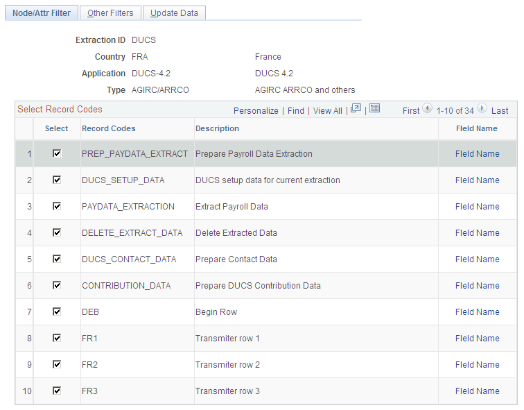

Use the Node/Attr Filter page (GPFR_DA_RUNCNTL) to select the structures and records you want to view.
Navigation:
This example illustrates the fields and controls on the Node/Attr Filter page. You can find definitions for the fields and controls later on this page.

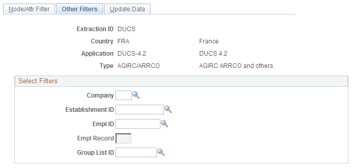

Use the Other Filters page (GPFR_AF_UPDT_2) to select other filters that are displayed based on the structures and records previously selected.
Navigation:
This example illustrates the fields and controls on the Other Filters page. You can find definitions for the fields and controls later on this page.
Use the Other Filters page to select other filters that are displayed based on the structures and records previously selected.

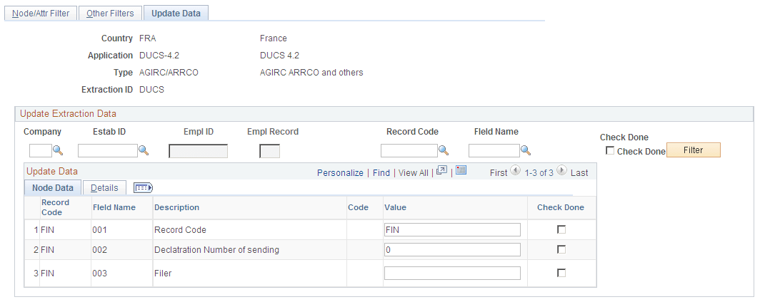

Use the Update Data page (GPFR_AF_UPDT_FINAL) to displays the results related to the filters selected on the Node/Attr Filter and the Other Filters pages.
Navigation:
This example illustrates the fields and controls on the Update Data page. You can find definitions for the fields and controls later on this page.
The Update Data page displays the results related to the filters you selected on the two first pages. You can then refine the data display by entering data in the Company, Estab ID (establishment ID), Empl ID, Empl Record, Structure, and Rubrique fields, then clicking the Filter button.
An export to Excel process is available, which shows the data displayed on the Update Data page.
Important! For technical reasons, regardless of the filters selected, the number of rows displayed on the Update Data page is limited to 5000. You may change this limit in PeopleTools, although you may then experience downgraded performance.

Node Data
The Node Data tab enables you to view the structure and record names and values used to produce the final file. However, the values displayed here come from the HCM application in a raw format. These values are formatted according to the DUCS norm at the file generation step.
Details
The Details tab displays data that helps you check the extracted data, even though all of the displayed data is not required in each row of the final file. The Details tab displays the following information:
Company
Establishment ID
Employee ID
Employee Record Number
Situation Begin Date
Situation End Date
