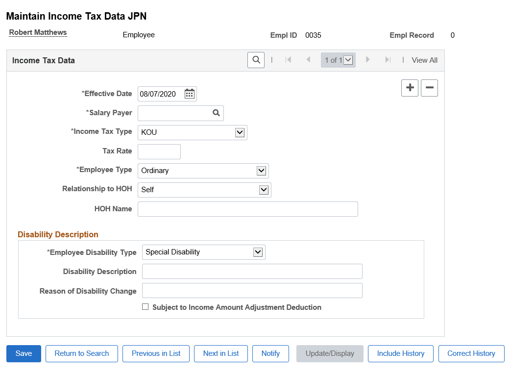

Use the Maintain Income Tax Data JPN page (GPJP_IT_PYE_TAX) to enter employee income tax data, such as salary payer number, employee type, and disability information.
Navigation:
This example illustrates the fields and controls on the Maintain Income Tax Data JPN page. You can find definitions for the fields and controls later on this page.

Income Tax Type |
Select from the following values: Designated Rate, KOU, and OTSU. For employees with multiple jobs, KOU can be selected only once across all employment records. Otherwise, the system generates an error message. As the system doesn't allow multiple employment records with tax type KOU at the same time, you have to update the current KOU record to a non-KOU value and then update the non-KOU record to KOU. If the employee type is not KOU, the employee can't update this dependent data on the self-service pages. |
Tax Rate |
Enter a value here only if you select Designated Rate for the income tax type. For example, enter 0.2 if the designated tax rate is 20 percent. |
Relationship to HOH (relationship to head of household) |
Select the relationship of the employee to the head of the household. If the employee is the head of household, select Self. |
HOH Name (head of household's name) |
If the employee is not the head of the household, enter the name of the person who is. |
Disability Information
Enter or edit disability information that is provided by employees on the Dependent Deduction report.
Field or Control |
Description |
Subject to Income Amount Adjustment Deduction |
Select this checkbox to enable ‘Income Amount Adjustment Deduction’ for an employee. This checkbox is enabled only when the user selects the ‘Employee Disability Type’ as “Specially Disabled”. Note: If user selects the checkbox in Maintain Income Tax Data JPN Page, you cannot select this check box for Dependent details in Maintain Dep Tax JPN page. If this selection is already done in Maintain Dep Tax JPN page, then you cannot select the checkbox in the Maintain Income Tax data JPN Page, an error message “Multiple selection is not allowed as Income Amount Adjustment is already selected for self or other dependent” is displayed. |

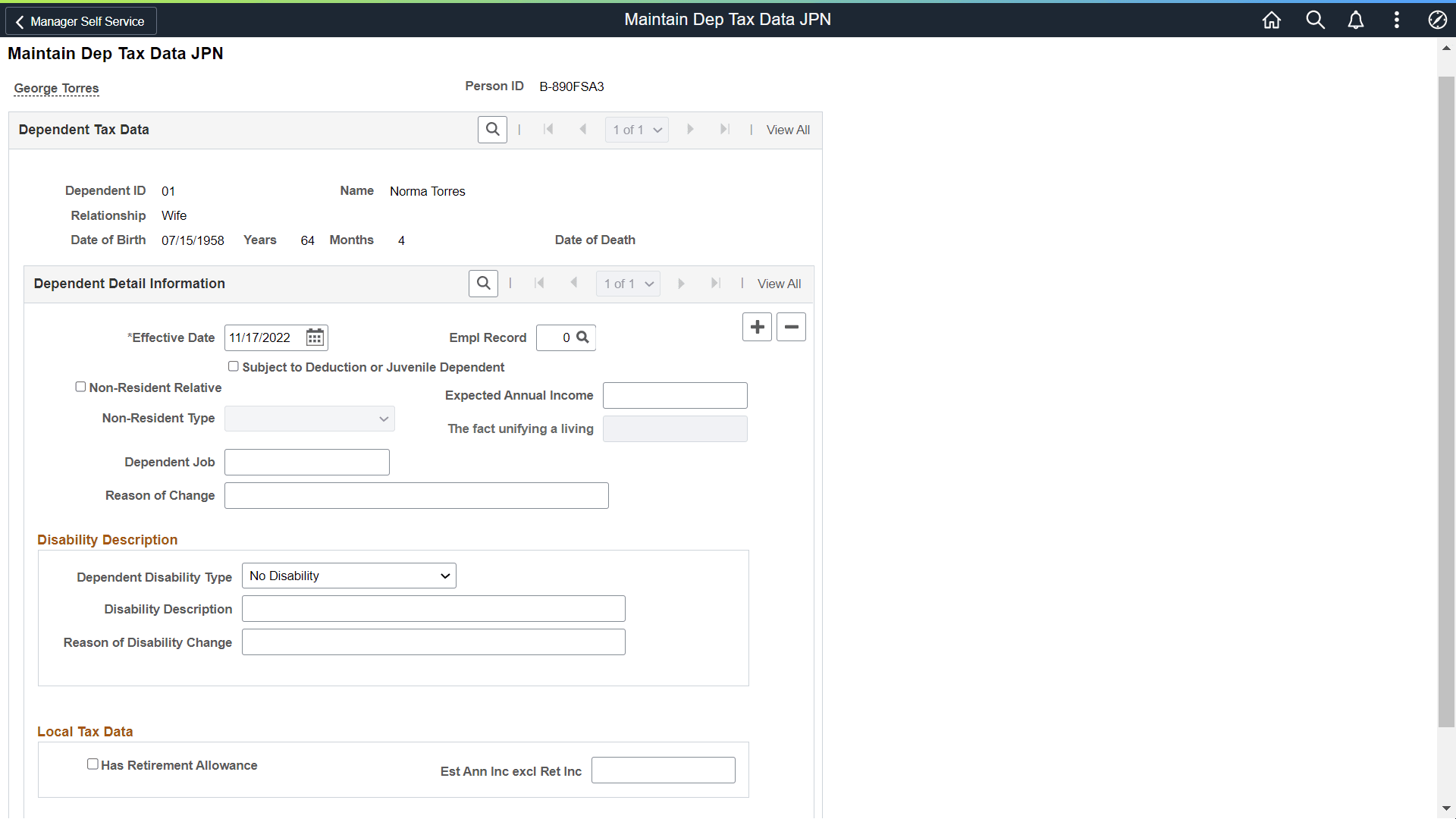

Use the Maintain Dep Tax Data JPN page (GPJP_IT_DEP_TAX) to enter dependent tax data.
Navigation:
This example illustrates the fields and controls on the Maintain Dep Tax Data JPN page. You can find definitions for the fields and controls later on this page.
The selections you make on this page determine the personal exemptions for income tax during year-end processing, as well as for withholding income tax. The application determines the exemptions based on the dependent's birth date and relationship to the payee.

Dependent Detail Information
You must link the dependent tax data with an employment record number. If the employee has multiple jobs, the employment record number that is linked to the tax type KOU on the Maintain Income Tax Data JPN page defaults to the Empl Rcd Nbr field. If no employment record number is linked to tax type KOU, zero is defaulted.
Field or Control |
Description |
Effective Date |
Enter the effective date for change of dependent data in the page. Note: For a newborn child, enter the child’s birth date in the Effective Date field. This ensures that the system calculates taxes properly for the year in which the child was born. |
Subject to Deduction or Juvenile Dependent |
Select if the dependent is subject to deduction. Note: If the relationship of the dependent is changed to ExSpouse in HR, you should deselect the Subject to Deduction check box on this page. |

Disability Description
Field or Control |
Description |
Select this checkbox to enable ‘Income Amount Adjustment Deduction’ for dependents. This checkbox is displayed only if the user selects ‘Dependent Disability Type’ as “Specially Disabled” or “Living with Specially Disabled” or the age of dependent is 23 years as on the 1st January of the following tax year (for example, in the tax year 2020, if the dependent age is 23 as on 1st January 2021) for which the Income amount adjustment deduction is being calculated. Note: If user selects the checkbox in Maintain Income Tax Data JPN Page, you cannot select this check box for Dependent details in Maintain Dep Tax JPN page. If this selection is already done in Maintain Dep Tax JPN page, then you cannot select the checkbox in the Maintain Income Tax data JPN Page, an error message “Multiple selection is not allowed as Income Amount Adjustment is already selected for self or other dependent” is displayed. |
Deleting Dependent Tax Data
If dependent tax data exists on this page, it will be orphaned if the dependent data is deleted from the Dependent Information page, unless service operation DEPBEN_SYNC is enabled.
