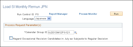

Use the Load SI Monthly Remun JPN (load social insurance monthly remuneration Japan) page (GPJP_RC_SC_LOAD) to run the monthly remuneration load process.
Navigation:
This example illustrates the fields and controls on the Load SI Monthly Remun JPN page. You can find definitions for the fields and controls later on this page.
The Monthly Remuneration Load process loads the Monthly Remuneration Results table (GPJP_MTHRMN_TBL).
The payroll must be finalized for the calendar group ID that you select; otherwise, the system issues an error message. The process uses the payment dates to determine for which month the calendar group applies. The following table lists the eligibility subject indicators for which the process loads data according to the month of the calendar group ID:

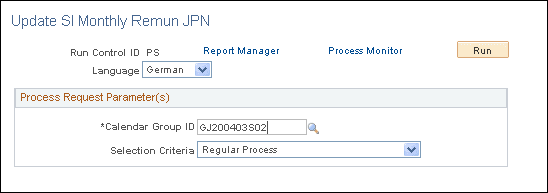

Use the Update SI Monthly Remun JPN (update social insurance monthly remuneration Japan) page (GPJP_RC_SC_LOAD) to update employee social insurance data.
Run the Monthly Remuneration Update process to update the amount of monthly remuneration on the Maintain Social Ins Data JPN page for employees whose subject indicator is Occasional Revision or Regular Decision.
Navigation:
This example illustrates the fields and controls on the Update SI Monthly Remun JPN page. You can find definitions for the fields and controls later on this page.
Run the Monthly Remuneration Update process to update the amount of monthly remuneration on the Maintain Social Ins Data JPN page for employees whose subject indicator is Occasional Revision or Regular Decision. Use the Selection Criteria field to select the monthly remuneration result data to be printed on the report.
This process uses the same run control page as the Monthly Remuneration Load process.
