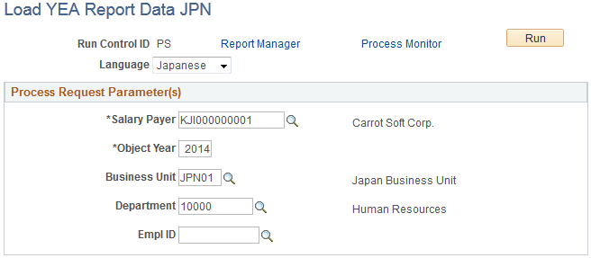

Use the Load YEA Report Data JPN (load year-end adjustment report data Japan) page (GPJP_RC_YEALOAD) to load the YEA report data.
Navigation:
This example illustrates the fields and controls on the Load YEA Report Data JPN page. You can find definitions for the fields and controls later on this page.
Field or Control |
Description |
EmplID (employee ID) |
If you select an employee ID, the process updates the row of data for the selected employee only. |
Note: To load YEA data for terminated employees, access the process through the Termination Processing menu path.

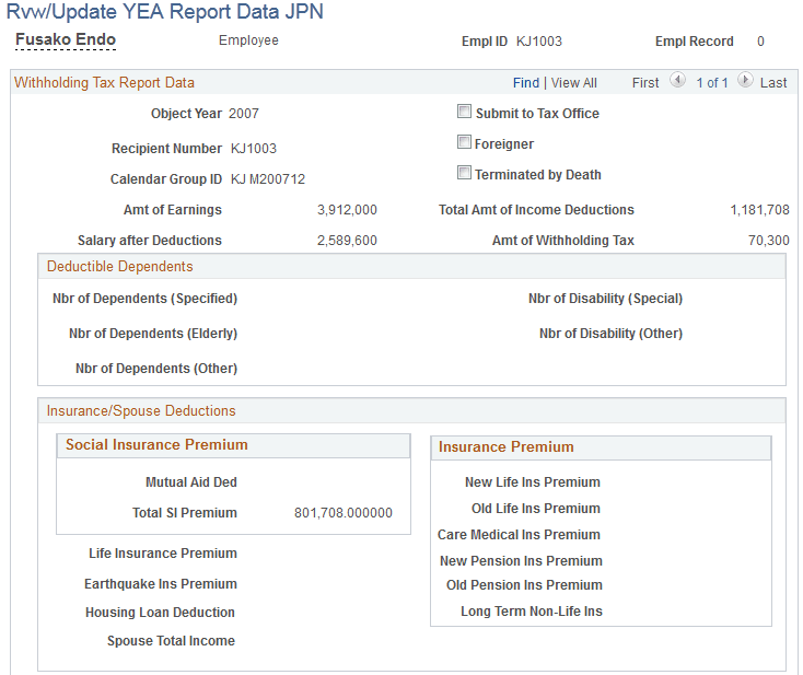

Use the Rvw/Update YEA Report Data JPN page to view and update the YEA Data table.
Navigation:
This example illustrates the fields and controls on the Rvw/Update YEA Report Data JPN page.
Field or Control |
Description |
Submit to Tax Office |
The system selects this check box if the KOU-type employee's gross income is over 5 million yen or the OTSU-type employee's gross income is over 500,000 yen (formula YE FM SUBMIT). The system does not verify whether the employee is an officer, retired, a disaster victim, or any of the other criteria for determining whether to submit the Withholding Tax report to the tax office. |

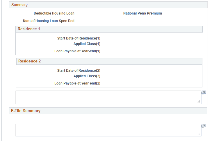

Summary |
The system enters deductible spouse and dependent identification, prior employment data, and the beginning date of residence (for employees who receive the housing acquisition special deduction). You can edit this data. Because of length limitations, the entire summary might not appear on the printed reports. |
