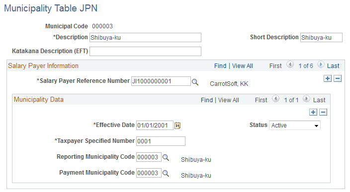

Associate municipality codes with tax establishments and taxpayer specified numbers on the Municipality Table page.

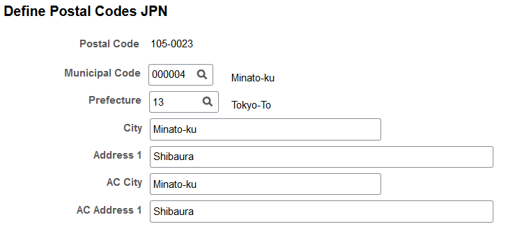

Associate municipality codes with postal codes on the Define Postal Codes JPN page.

Use the Municipality Table JPN page (GPJP_IH_MUNIC) to define municipality codes and associate them with salary payers.
For each salary payer, record the taxpayer-specified number assigned by the municipality.

This example illustrates the fields and controls on the Municipality Table JPN page. You can find definitions for the fields and controls later on this page.
Field or Control |
Description |
Salary Payer Reference Number |
Select each income tax establishment associated with this municipality. |
Taxpayer Specified Number |
Enter the number assigned by the municipality to the salary payer for special collection. |
Reporting Municipality Code |
Enter the reporting municipality code where the wage payment report to be sent. |
Payment Municipal Code |
Enter the municipal code where the inhabitant tax should be paid. |
Use the Define Postal Codes JPN page (POSTAL_TBL_JPN) to associate municipality codes with postal codes.
Navigation:
This example illustrates the fields and controls on the Define Postal Codes JPN page. You can find definitions for the fields and controls later on this page.
Field or Control |
Description |
Municipal Code |
Select the municipal code to associate with this postal code. |
