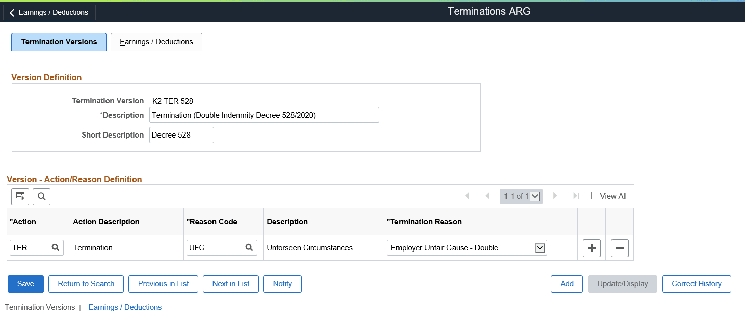

Global Payroll for Argentina groups the qualifying actions and reasons for making termination payments into termination versions. Different termination action and reason combinations trigger different sets of special termination earnings and deductions. To define termination versions and then trigger the payments associated with a termination version, you must do the following:
Define your termination versions on the Termination Versions page.
On the same page, define the associated actions/reasons that will trigger payment.
Termination versions are the combinations of actions/reasons that cause a group of termination earnings or deductions to be processed.

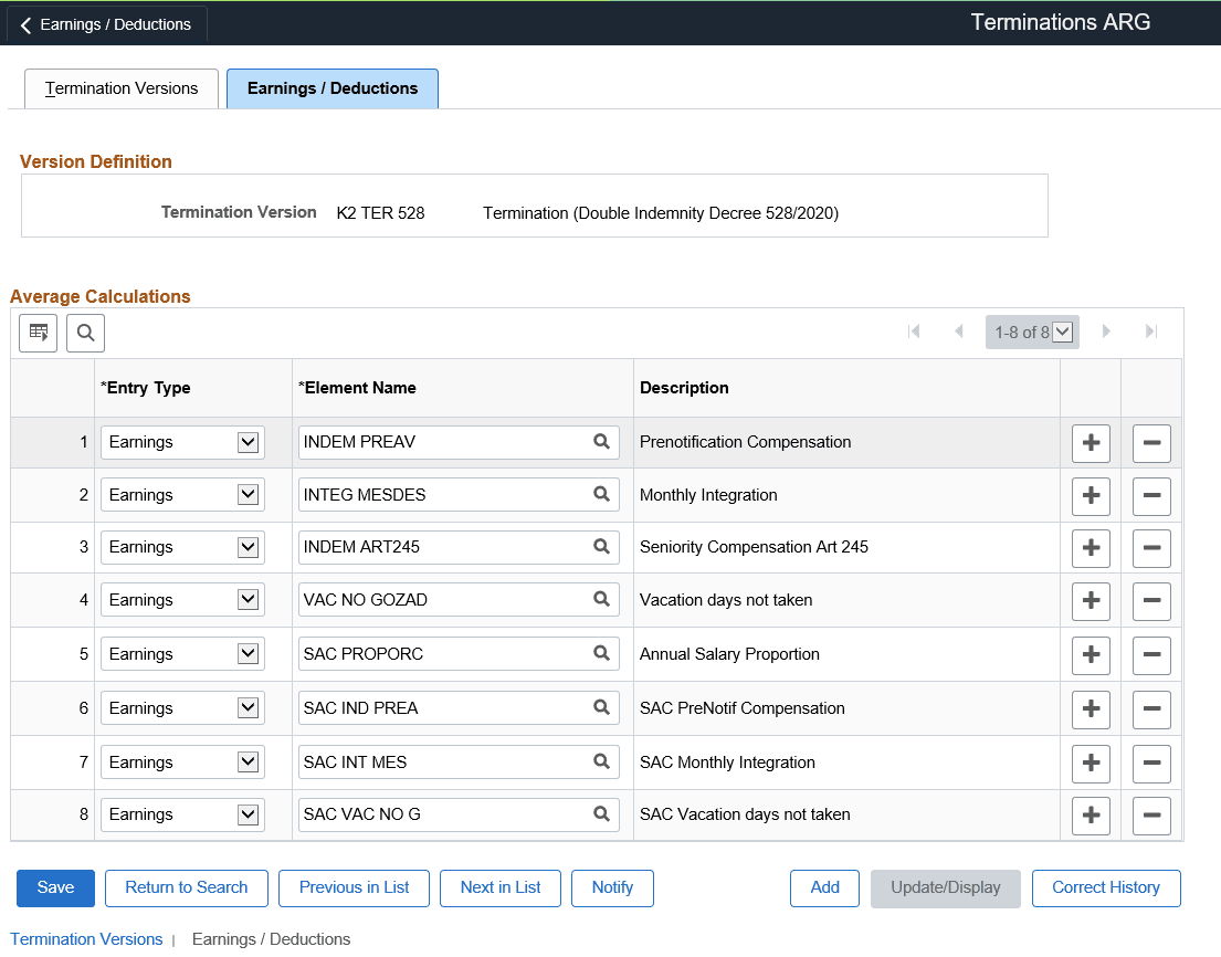

On the Earning/Deductions page, associate each earning or deduction with a corresponding termination version.
On the Job Data pages in PeopleSoft HR, specify termination actions such as Termination, Completion, or Layoff as the action and enter a corresponding reason.
When you specify a termination action as the action in combination with a qualifying reason, termination pay will be processed for the terminated or laid off employees—as long as the termination or layoff action/reason combination is recognized, by generation control, as valid for triggering termination payments.
Use the Termination Versions page (GPAR_TERM_ACTN_RSN) to define termination versions and the qualifying actions and reasons for triggering termination pay.
Navigation:
This example illustrates the fields and controls on the Termination Versions page.
Note: (For terminations by common agreement) Global Payroll for Argentina delivers a termination reason (Termination by Common Agreement) and (Term by Common Agreement) to support terminations that are mutually agreed by employers and employees.

Version - Action/Reason Definition
Use the fields in the Version - Action/Reason group box to define the termination action/reason combinations that make up the termination version.
Note: A single termination version can consist of many different action/reason combinations—as long as all the combinations trigger the same set of termination earnings or deductions.

Use the Earnings/Deductions page (GPAR_TERM_VERSION) to associate earnings and deductions with a corresponding termination version.
Navigation:
This example illustrates the fields and controls on the Earnings/Deductions page.
Field or Control |
Description |
Entry Type |
Select whether you are entering an Earnings or a Deduction element. |
Element Name |
Select the element to associate with this termination version. |
